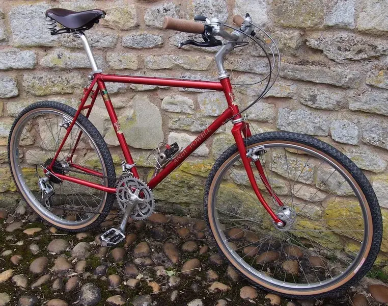

84 Andy Powell Early Overbury's MTB
Re: Re:
Retro Spud":b0dtdbdf said:
The History Man":b0dtdbdf said:
my new desktop background :wink:
That pic has almost Mint Sauce esq qualities about it.
That's just what I was thinking , and then I scrolled down!...made me smile :lol:
What a fine frame, and a nicely expressed attitude to "all-terrain" / mountain biking exploration

A 1984 British made mountain bike in that condition is rare indeed. Even though Reynolds launched their ATB tube-sets in 1983 it would have taken a while for companies to source components and set up production and test prototypes etc. I would love to see the guidance to manufacturers that Reynolds sent out with the tube-sets. It probably included drawings showing the frame geometry of the original Ritchey bikes.

- 3 younger than mine then. I remain to be convinced that there were 40+ ATBs built by Andy P in 1984 - suspect the numberings were for all types of Andy P frames...
This has lain dormant since a few summer rides. Time for a minor refresh with some grips and a saddle......
Minor update. Better i think .
