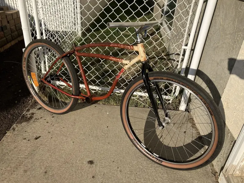

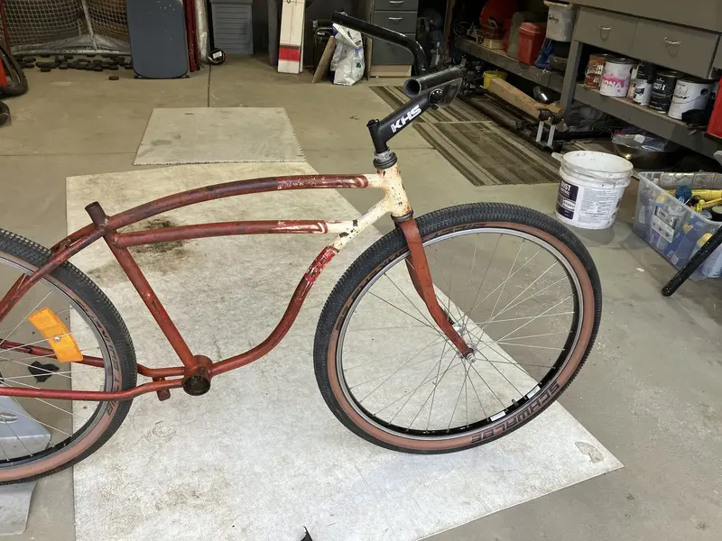

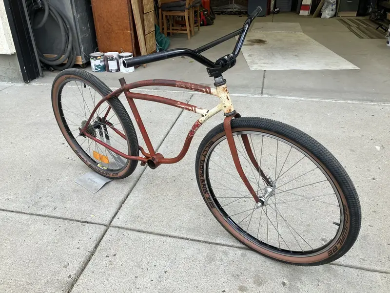

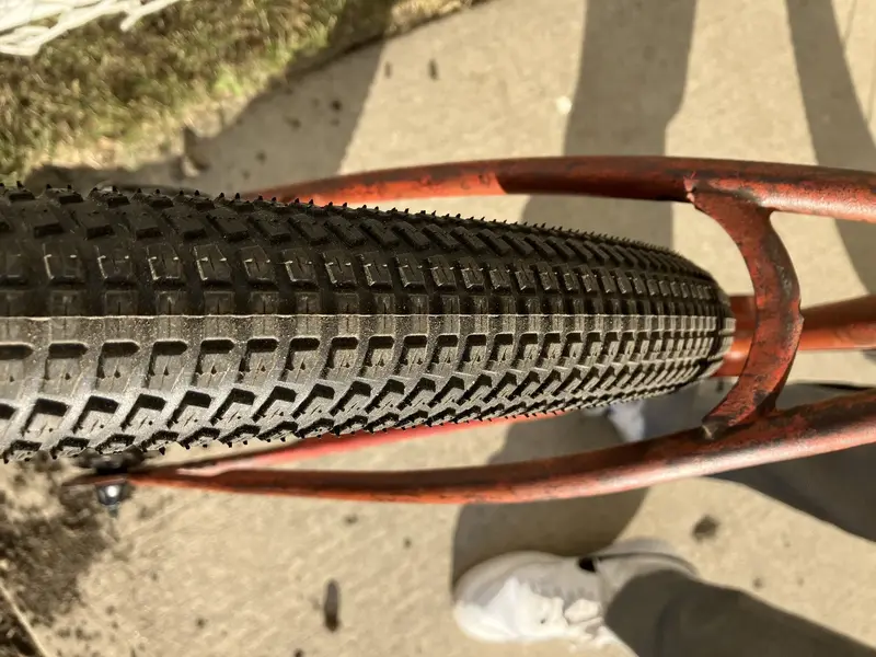

What size rubber you got on that one? I'm considering Kenda small block or something similar. Want something easy rolling as most riding will be asphalt or light gravel. I think my black rims with a black tire will make them look beefy.

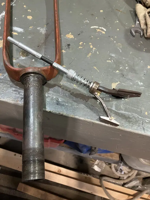

I’ve used the Wald replacement with the large top so a mondern seat can be used. The problem is they are thin walled and bend. I use, I think it’s 3/8 inch gas pipe, to hammer inside. I remove threading, sand the pipe smooth, slather the pipe with JB Weld to act as a lubricant. I put it on a wood block and spend about 10 minutes forcing it inside the seat post. I can’t remember but I think the pipe was 12 or 18 inches long. It will not bend if you do this. 9B76CA5A-ADC0-4533-8644-9AAF05F9FA19.jpeg 35818C75-74B7-4582-AEAA-D484092A0333.jpeg
