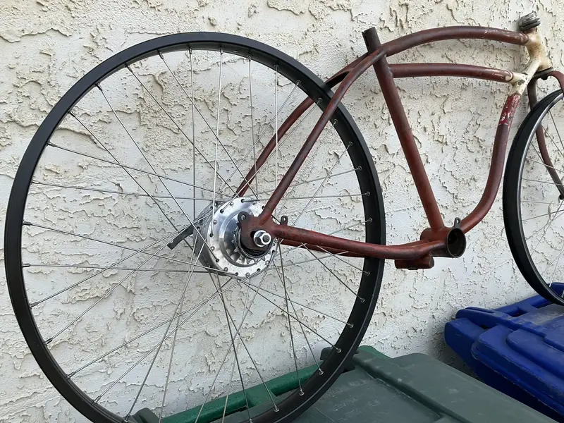

A cassette multi speed will almost certainly thread on. The wheel is probably not dished for this and your chain line will be off. The wheel won’t be centered in the frame without dishing. Also the rear spacing on the bike frame will be too narrow and the hub will need a new axle and a spacer for the hub to have the axle extend beyond the hub drive side. You need to take the wheels to a bike shop to make sure they’re ok. It appears that some of the spokes on the rear wheel are not under crossed on the third cross but it’s hard to tell from a photo. It might need to be rebuilt properly. The Bike shop can see about having the wheel rebuilt and dished if a longer axle can be found in the proper threading for the cones. If you use a cassette the chain for it won’t fit on a standard single speed chainring. A BMX spider can be fitted and a multi speed chainring could be used. It would have to be a narrow wide chainring if you go single chainring. I don’t think a spider would work on a narrow wide. You could also use a bottom bracket adapter and use a two or three chainring crank.

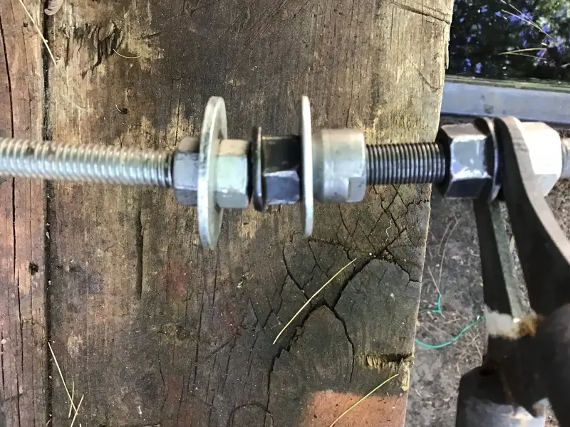

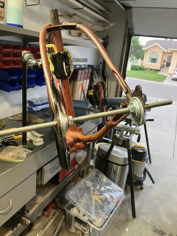

Finally had a bit of time to work on the DX. Cold set to 130mm to fit the rear. Pretty early in the process but nice to see some wheels come into play. The stem wedge is rusted into the fork so not aure if it can be saved. Wasn’t going to use but lately been really liking the look with truss rods.

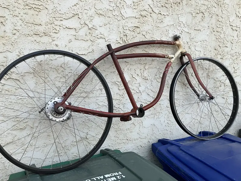

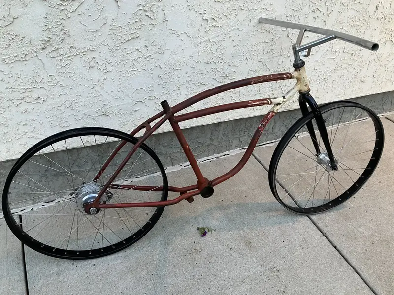

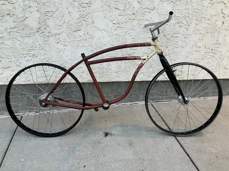

Turns out this frame is for 24” wheels am I out of luck with this as a 26er?
Not really will be down to tyre size/height. Looks like you have clearance with those 26" wheels fitted in the photo above. Best to a trial fit with some tyres and see if you have clearance, then you're in luck!
