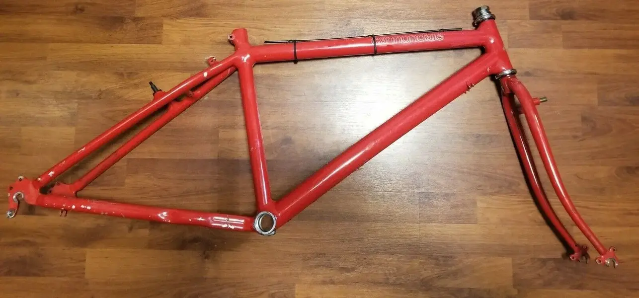

I bought the roller cams separately, but yes it was the frame I intended to put those on. It's red, pic below, probably going to end up dumped somewhere as it's next to useless to anyone except an enthusiast. :(

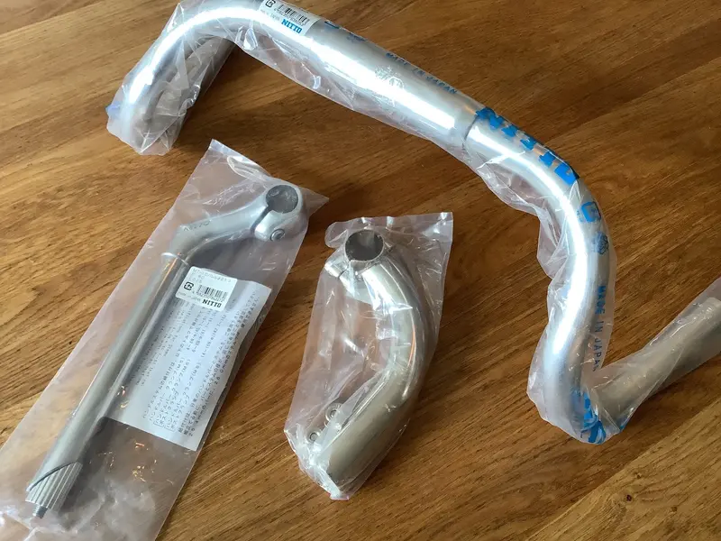

Cockpit options too:
Must say that the ‘Rona has set me back a bit, but will be out this weekend by hook or crook.
I’ve cracked an old cassette so have some cog options to play with. Currently loaded with a 17t.
Think this s also a good excuse to get a cadence monitor; I’m assuming I can do it through an iPhone these days, but there seem to be some reasonable cateye type computers available.

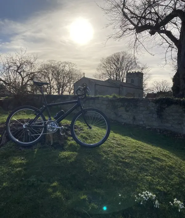

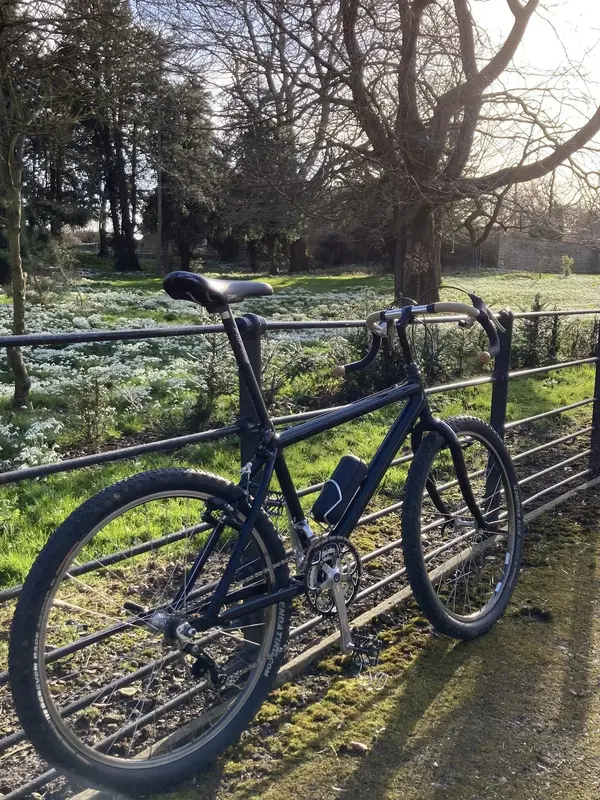

So, still v. Windy hereabouts, but first proper timed ride today. Highly instructive if none too glorious. Strava stats are
32km
442m elevation
19 kmh average. 🤦‍♂️
Learning:
The Spug handles; it’s great downhill despite(?) the high BB. And is comfy. 64kmh top speed today even with low gearing.
I’m running Kenda 24/7 ‘Tinker Juarez’ 2.0 XC tyres, because they‘re quite light and were to hand. And I must say, I’m digging having large volume rubber. Despite being a stiff Alu frame and fork, it’s not harsh even on nasty surfaces. Although I wonder if they were dragging when I was against the wind, as it felt soooo slow.
The gearing is still wrong. I’m trying to do this with a 3x1 setup. This ride was 48/36/26 x 17t flavour. The big ring combo worked well and when it spins out it’s time to freewheel anyway. But the strong headwinds today mocked everything else.
And 26-17 don’t cut it on steep stuff despite a relatively light build: I broke the chain coming up out of Leavening …. And had to push the bloody thing for a bit up out of Thixendale.
So what next? Before giving up on 3x1,I’m going to see if I can find a sweet spot with a wider range up front. Anyone know which front derailleurs have the best capacity? Is a 30t difference possible?
