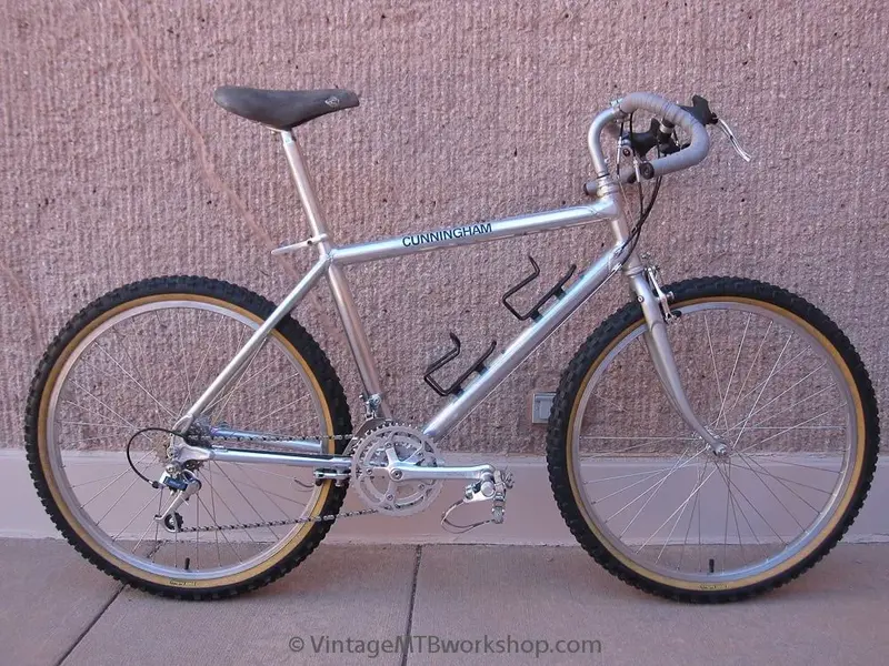

Anyway, I’m convinced/deluded that I have a chance by building a light drop bar 26er in the style of the lovely Cunningham racers. Inspiration:

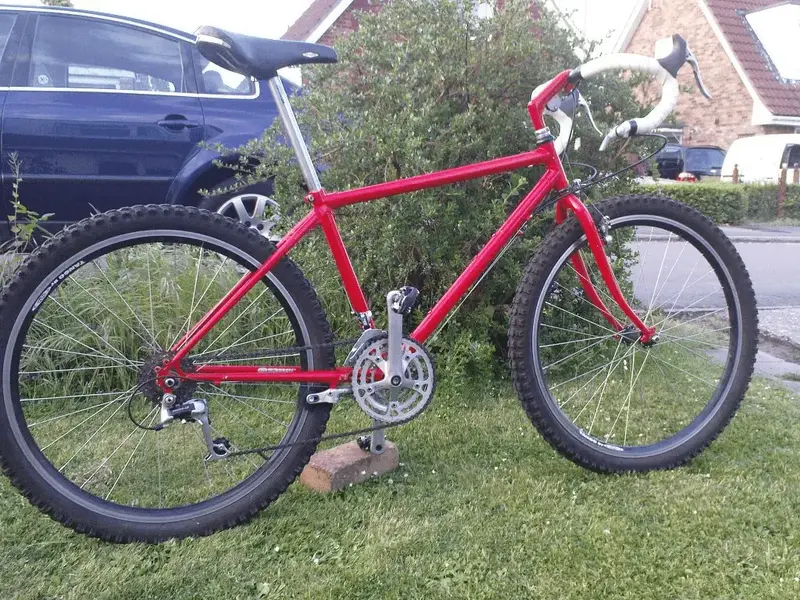

Nice if you can pull it off, that's my unicorn bike right there, currently working on my own Cunningham inspired dirt drop build, although i'm going for steel rather than aluminium so it's very much an aesthetic tribute, good luck with the project, will follow with interest. 👌

@legrandefromage That bike is so sweet. So much so that I bought the frame from you a number of years ago! It’s still going strong - now with bullmooseseseses.
