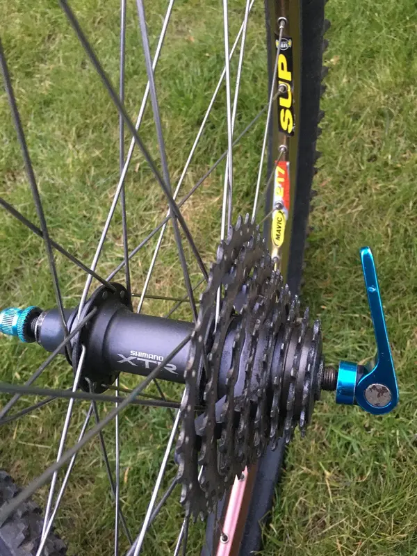

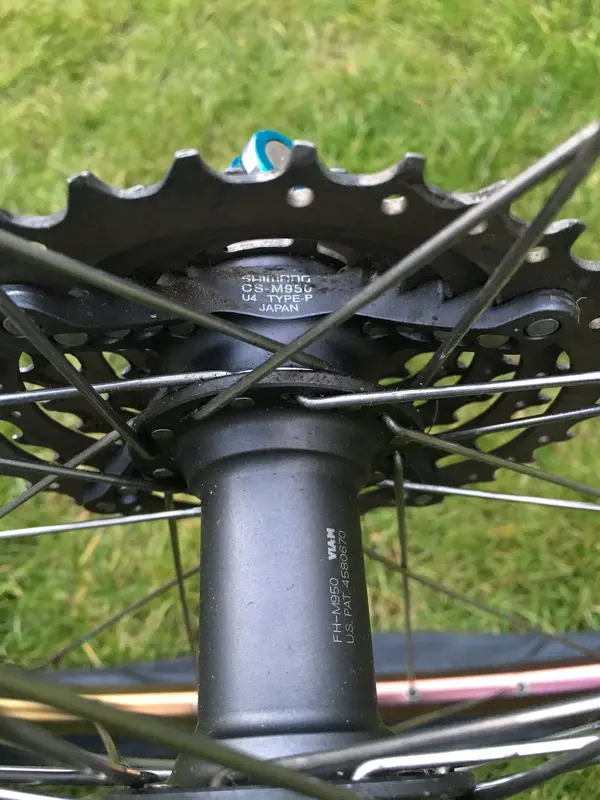

The limit screws won't change the fact you have 9 speed shifters and an 8sp cassette. The spacing between the cogs is different from 8-9 speed so you won't get very good shifting in various places on the rear.
If I'm wrong, someone will I'm sure be along to correct.
I don't see why you wouldn't just use a cassette that compliments the 9 speed set up the rest of the drive train is. It will be far easier and simpler.
And yes, a 9sp cassette will fit on m950 hubs. Shimano didn't change the hubs when they introduced m951/2/3.
Sram 9sp will fit shimano freehubs just fine.

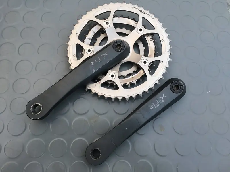

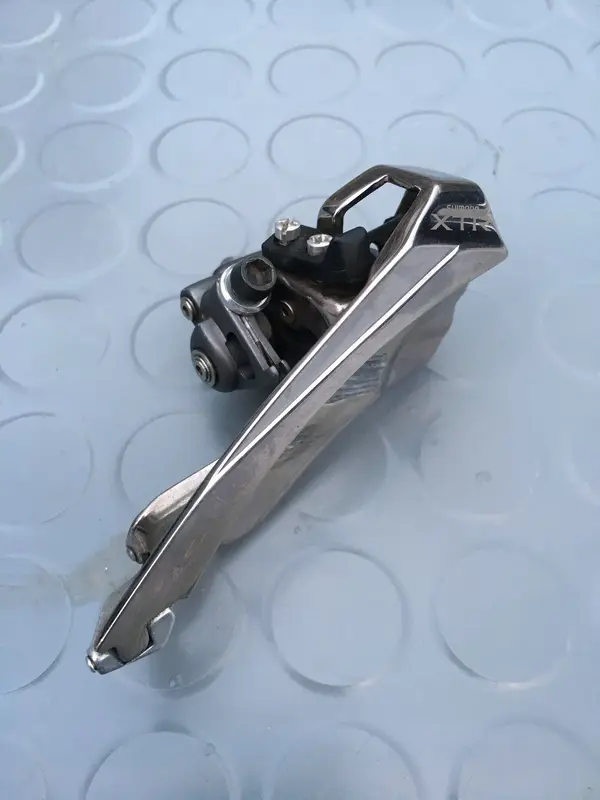

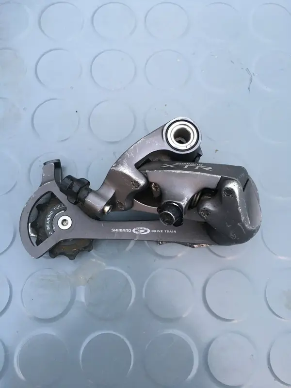

Good evening all,
There have been some developments with this build over the last couple of weeks. I’ve managed to source a number of parts for it, namely:
Flite Titanium saddle (awaits delivery)

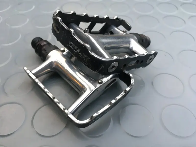

XT caged pedals

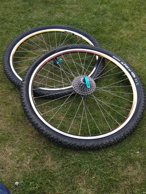

Re issue Panaracer Smoke/Dart tan walls (awaits delivery)
M950 skewers

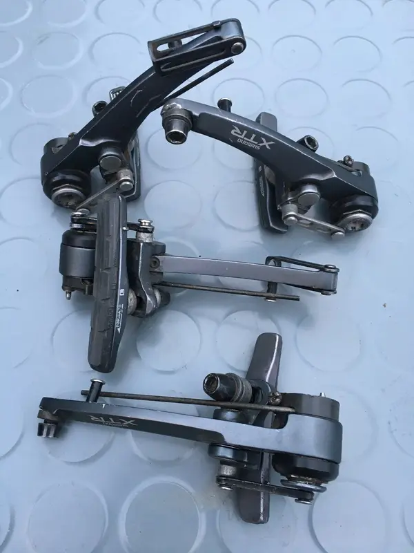

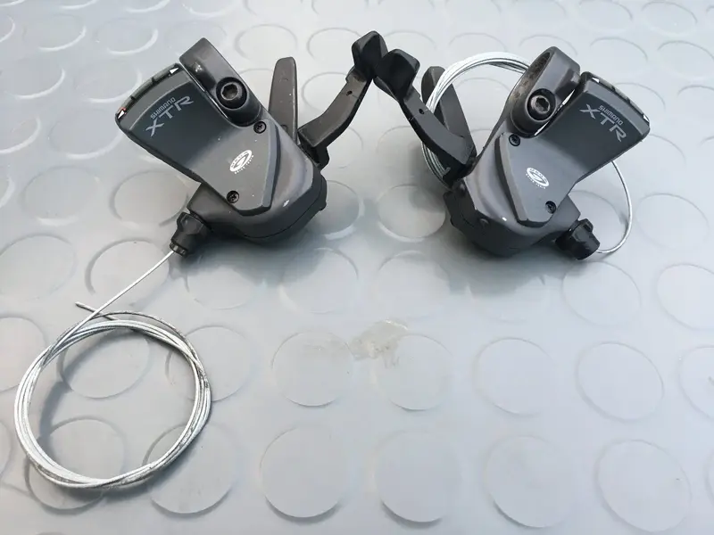

M952 chainset, front and rear DR’s, BB and shifters
M950 V brakes, M950 Levers.

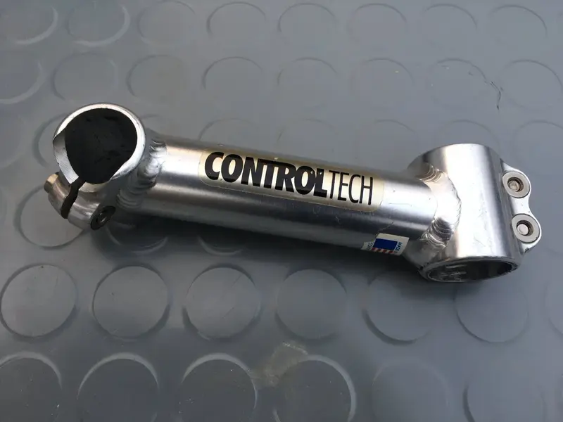

Control Tech Stem
And some very nice Mavic 217 Sunset rims, laced to M950 XTR Hubs, with an 8 speed M950 XTR cassette.
pics to follow in the next posts.
A couple of questions for you chaps:

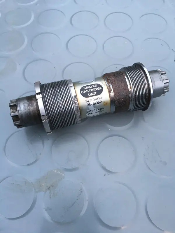

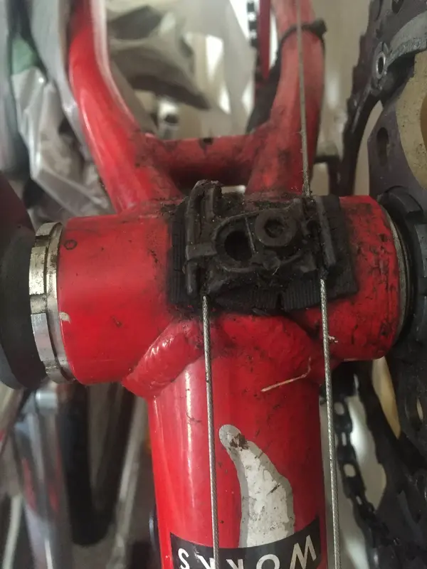

Any suggestions on tools to purchase for removing the old Shimano Cartridge Bottom bracket and cranks (tapered spindle), and also for fitting the new m952 Octalink BB and cranks?
I have just noticed that the BB has a 116mm spindle, where as I’ve been told, and I’ve read that the Zaskar/M952 crankset should use a 112.5 spindle. (Newbie error I guess, and I should have double checked, although I did ask!) can I run the 116mm spindle, or will it be too long?
The BB came without any spacers. Do I need to use any in the Zaskar frame (73mm shell), if so what size and on what side?
Thanks for any advice, Paul.

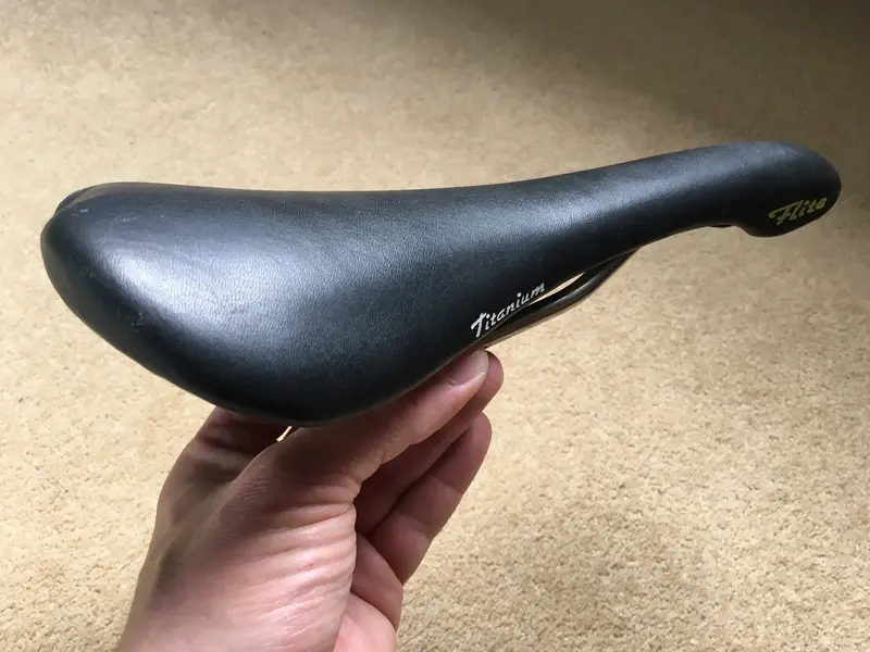

Another piece of the puzzle arrived today. A very tidy Flite saddle.

From memory a m950 doesn’t need any spacers but a M952 has a small one
116 will be a tiny bit wider 1.75mm each side and isn’t ideal but won’t cause any issues.
Thanks very much.
I don’t suppose you know the size of the spacer for the M952, and what size it goes on?
Thanks!
Both BB's need a spacer if fitted to 68mm shells,no spacer normally needed for 73 mm shells.The standard supplied spacer is around 3mm wide,although Shimano did produce other sizes,often needed when fitting e-type derailleurs.XTR had thick carbon mounting plates,XT/LX thinner steel.
Goes on the non drive side,but spacers can be used on either side in some cases in order to adjust the chainline.If you were to use a 108/118mm Shimano road octalink BB for example.Never done it personally but is possible on some setups.
68mm shell,M952 BB,Standard spacer..
