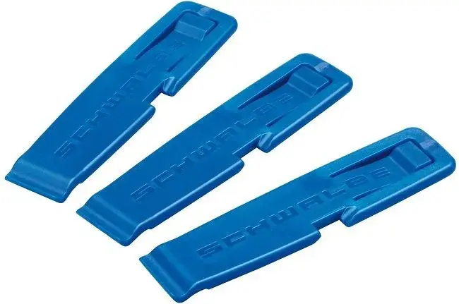

We always used the squarish blue Schwalbe tyre levers on the wheelchair Marathon+.
The Schwalbe levers have really small hooks that can be wedged under the bead onto the rim, and a cutout to allow them to be locked onto the spoke.
Just one lever first, then slipped another right next door into the small gap where the bead rises out of the well and crosses the rim edge.
Then another, and another...sometimes needed all 3 levers to get enough bead over the rim to release the tyre.
Shuffle the tyre over to one side, remove the inner and repeat to remove the other bead from the rim.
Getting them back on required getting the beads into the rim well as much as possible. Wedge the clip (on the other end to the hook) into the rim to stop the tyre walking back off (or a toe strap or large zip tie around the tyre and rim, resting against a spoke), then working towards the clip with one lever in each hand. Lever a few inches of tyre on, hold it, switch hands, lever with the next lever, remove the first and repeat.
