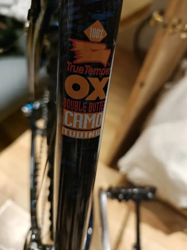

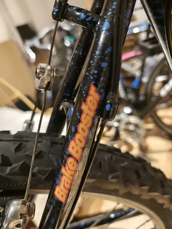

new project starting this week - aiming to get this one as close as possible to original catalogue spec. including this unique piece of 90s MTB history:
starting point is very promising as this frameset and paintwork have been preserved beautifully and are virtually unmarked.
have you guessed what it is yet?
more anon...

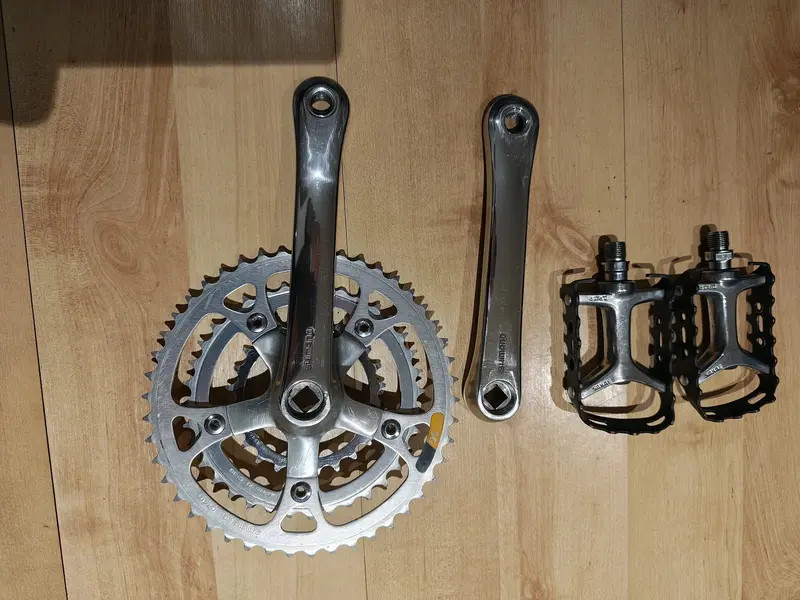

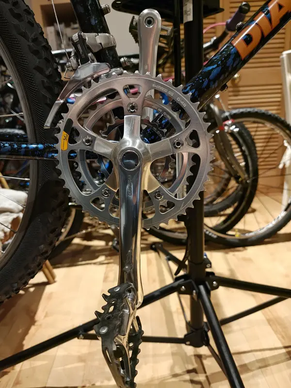

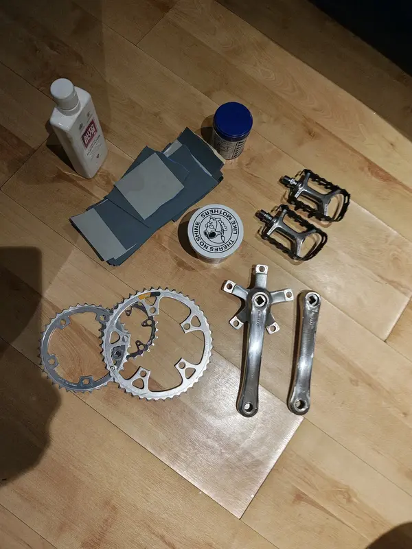

started on the big shine-up task - chainset and pedals first...
IMG_20250106_213851190_HDR.webp IMG_20250106_215656190_HDR.webp IMG_20250106_222940413_HDR.webp IMG_20250106_222954315_HDR.webp
...some serious 'mothering' needed to shift the gouges and marks on the M730 cranks but came good with some judicious use of wet+dry.

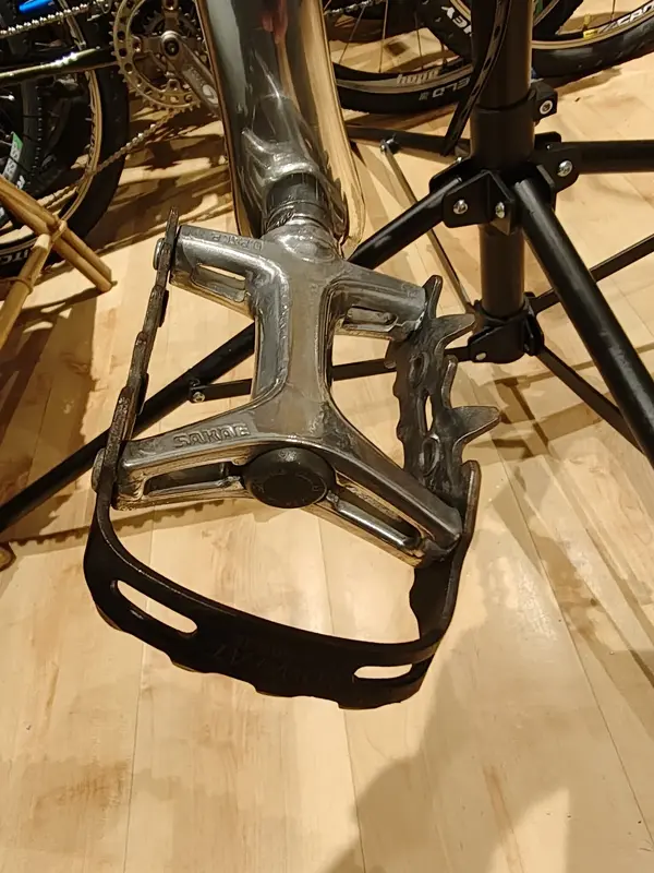

I am keeping the SR 'low fat' pedals as these are original and also have a very nice patina + super smooth axles and bearings still - they cleaned up well with paint restorer on the black parts and mothers+wet &dry on the shiny bits. Chainrings came clean enought but are quite well worn so will keep my eyes open for some NOS replacements

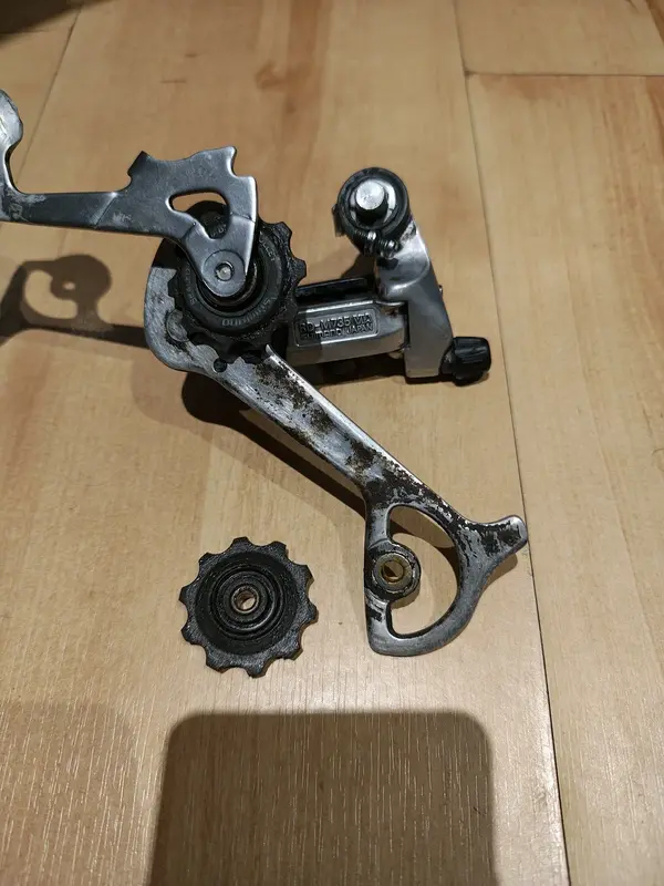

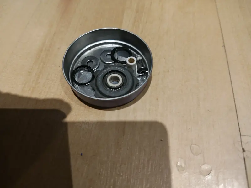

1992 Axis, ...the parts resto continued today: rear XT mech , original jockey wheels " I will get that ceramic bearing white again " ;-)

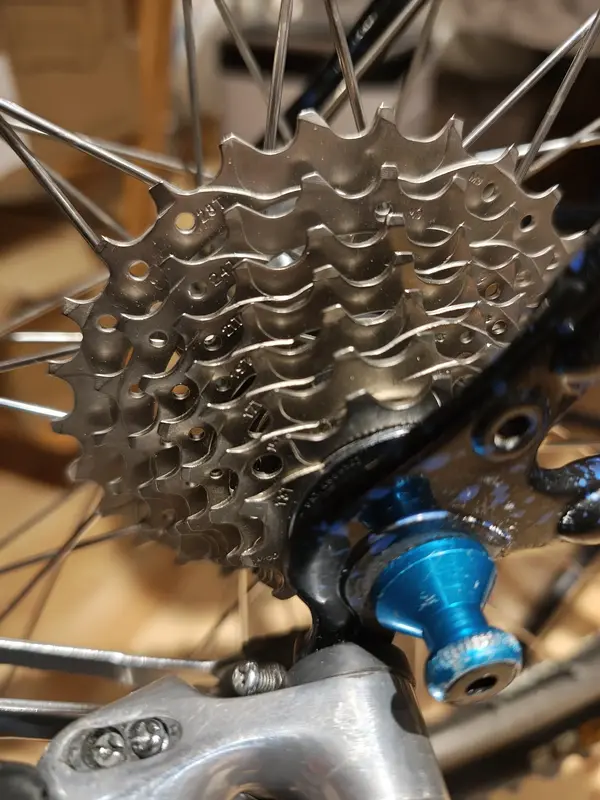

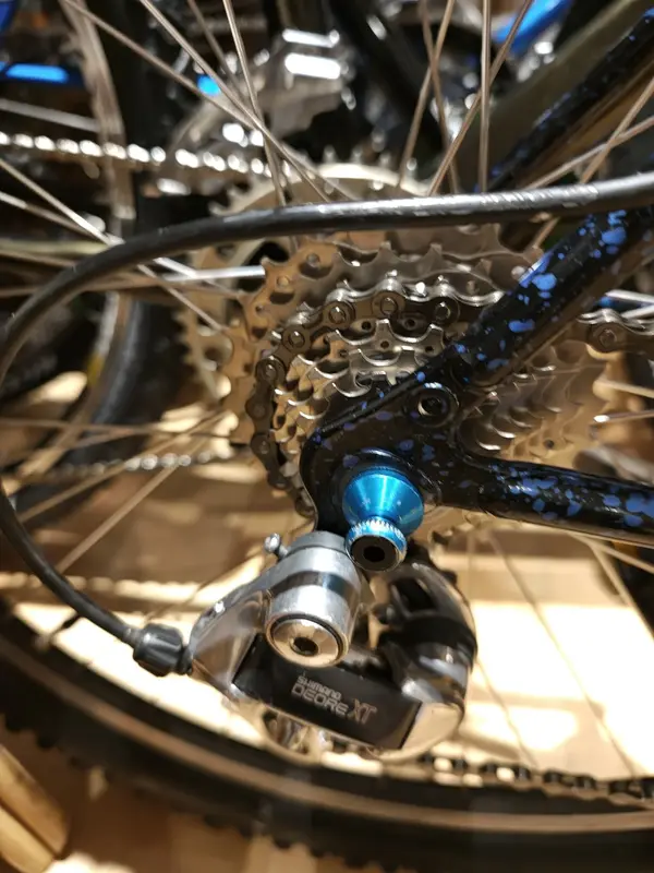

Freewheel replacement - opted for a 'modern' 8 speed with lowest cog removed as this is a shorter 7 speed freehub body. I retained the original large size freewheel lockring and added a spacer to ensure everything tightened nicely. there was very little damage to the splines and all I had to do was remove, clean and re-grease.
IMG_20250107_145518548_HDR - Copy.jpg IMG_20250107_150615092_HDR - Copy.jpg IMG_20250107_150624221_HDR - Copy.jpg

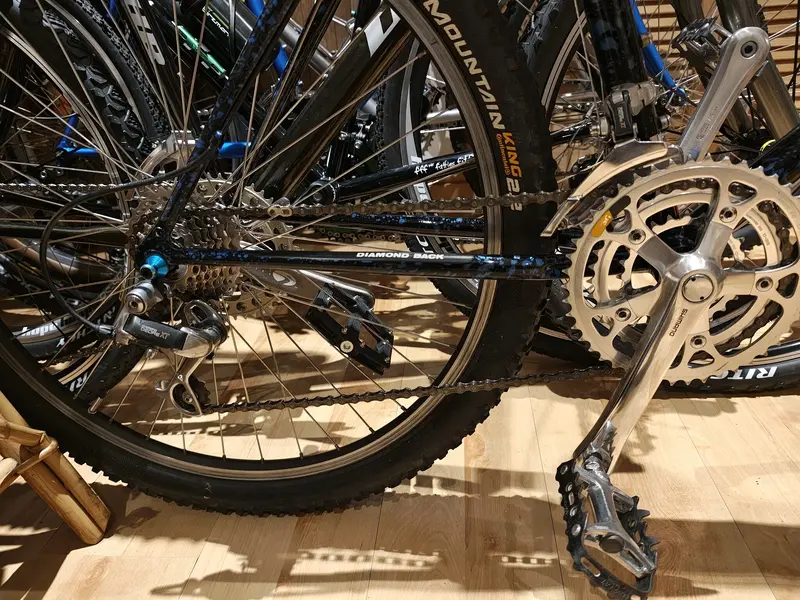

replacement chain added and derailleur adjusted - shifting is a lot smoother than before ( although it wasn't bad) and it has to be said that the XT trigger shifters of that era are very 'immediate' compared to thumbies. Everything working peachy now and a lot shiner than before :)
View attachment 915563View attachment 915564View attachment 915565

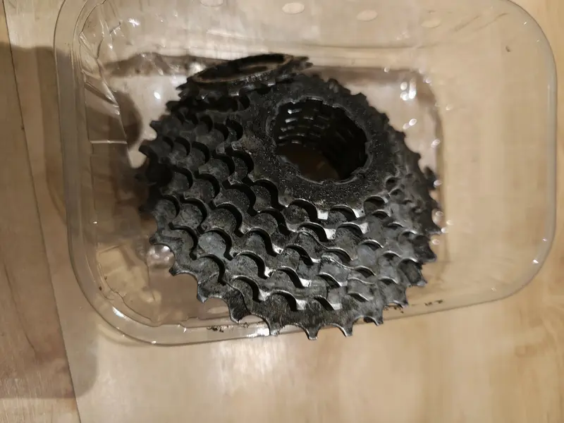

Can I ask how you brought the rear cassette back from the black metal?
Ive degreased and brushed mine etc but it still looks terrible

Sadly I gave up on cleaning the old cassette as it was too far gone and so I made a replacement 7 speed from a new 12-28 8 speed cassette (omitting the smallest 12 tooth sprocket) and made it fit the smaller freehub body exactly using a spacer between the two smallest cogs and I re-used the wider diameter Shimano lockring from the old cassette for a snug fit and more retro look.
The sculpted nature of the modern sprockets are a giveaway to anyone inspecting the build but they also facilitate smoother shifting .

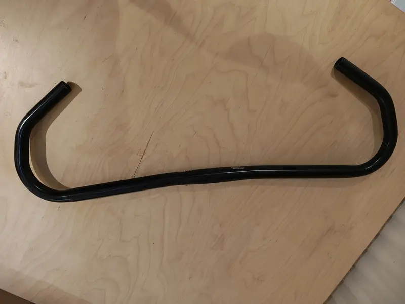

smokes are on order but proving elusive in the necessary beige/black so may be a wait for delivery from Europe. In the interim I am trying to source original XT brake blocks and will re-instate the funky brahma bar at the cockpit end. some odds and sods to finish the resto are also proving very hard - principally a decent saddle - cant find an avenir original on any continent so may have to be a similar period style or reproduction turbo saddle etc.

Have you got grips for the Brahma bars? I've got a set of bars but I've never been sure what grips to use. I'm tempted to just go with bar tape.
