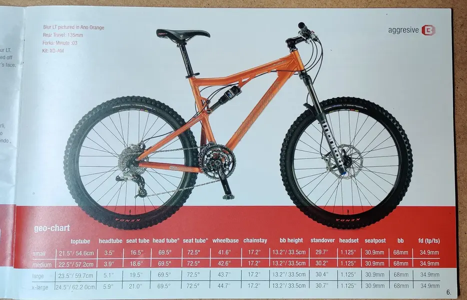

I asked the gaffer the other day and he said to email him the details as he's got some catalogues knocking around the office.
He came through with this today and said when he saw the description of it "Black Chrome", he knew it was the one. Apparently it had a reputation for being the nicest, shiniest of finishes, but as soon as you breathed near it, it could "dull" very easily.

Pretty sure like the original Blur, the top top was dipped on the small and medium and straight on the large and x large frames.
Looking at the pictures, that looks like a large so maybe they changed it for this model ?

This is definitely a large frame. The research I did showed that the blur xc was a straight top tube and the LT was the kinked top tube. Although I may be wrong!

I just recently picked 05 Blur XC frame. It is a large (19.5" ST) frame with bend in the top tube like my old large (19.5") Super Lite. I was going to buy an 05 medium (17" ST) Blur Classic frame which had a straight top tube from the same seller. I believe, but am not positive, large and XL Blur XC/Classic frames had the curve in the TT and the medium and small had a straight TT. I'm not sure what the difference between the Classic and the XC are except the Classic production went from 02-05 and the XC production went from 05-08. I did notice the 05 classic serial number started with 05.... and my 05 XC serial number started with zed05... I wonder if that is how SC kept track of which frame was which in 2005. As you can see this covid lock down has me thinking and wondering way too much.
