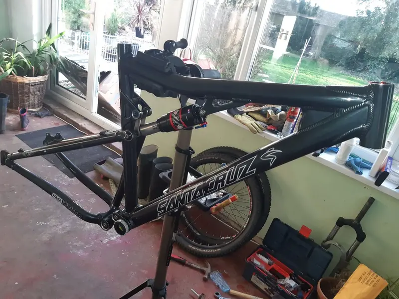

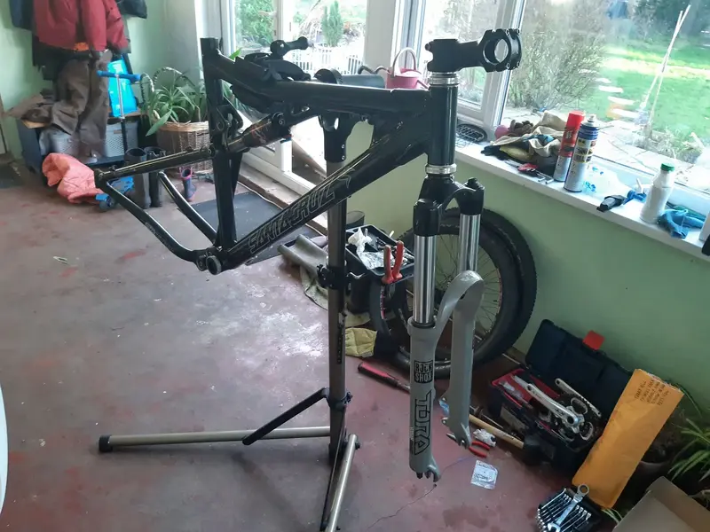

The frame is a 2005 Blur LT. Arrived as a bare frame (no shock, BB or anything else attached - full parts list at the bottom once all pics uploaded!)
The colour is an odd one. In all my research I've not seen another in this. Its a very dark green, almost black in some light but when sunlight hits, there is a violet pearl that pops out. Its definitely the original paint but I can find no reference to it on any forum or Santa Cruz's website. It would be nice to know what its called, if its a factory option paint or was specified as a one-off custom job. I know Kona definitely used to offer that service and as Santa Cruz are a more boutique lower volume manufacturer, I would be surprised if this was not the case.
First pic: Frame with new bearings, shock with new bushings and BB fitted.

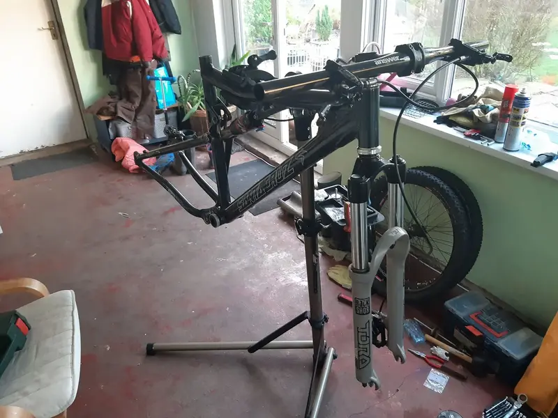

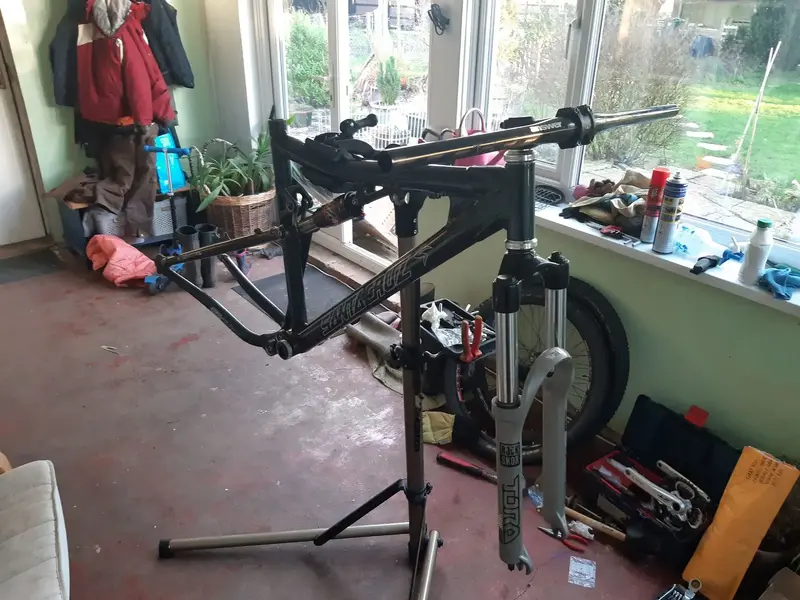

Headset going in (same press I made to do my Kona), Forks and stem on, bars on and brakes starting to be fitted.

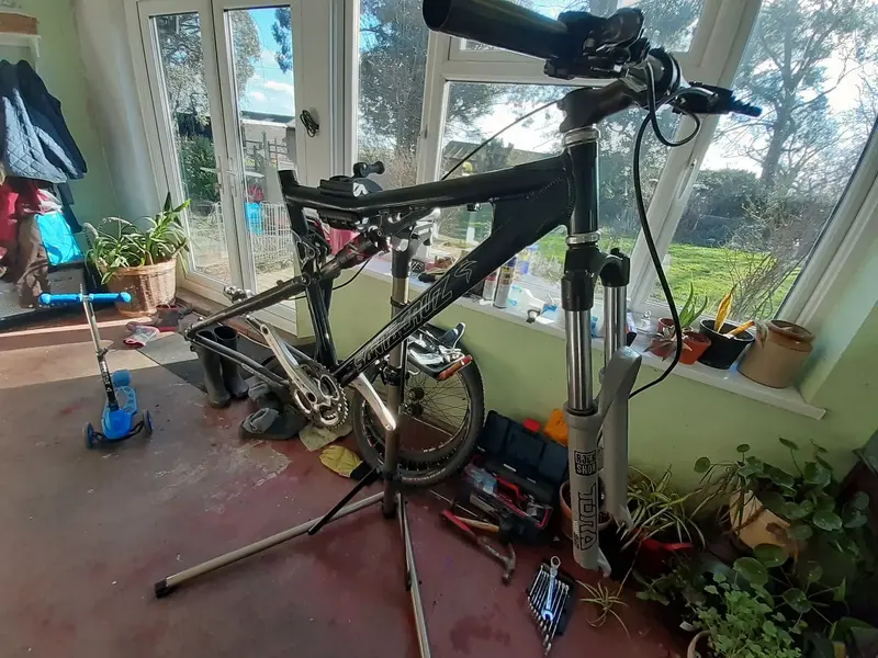

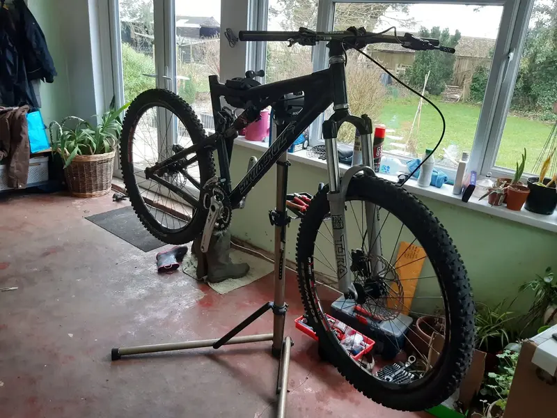

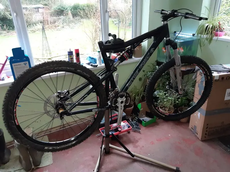

Cranks and gears going on, wheels on and almost done!

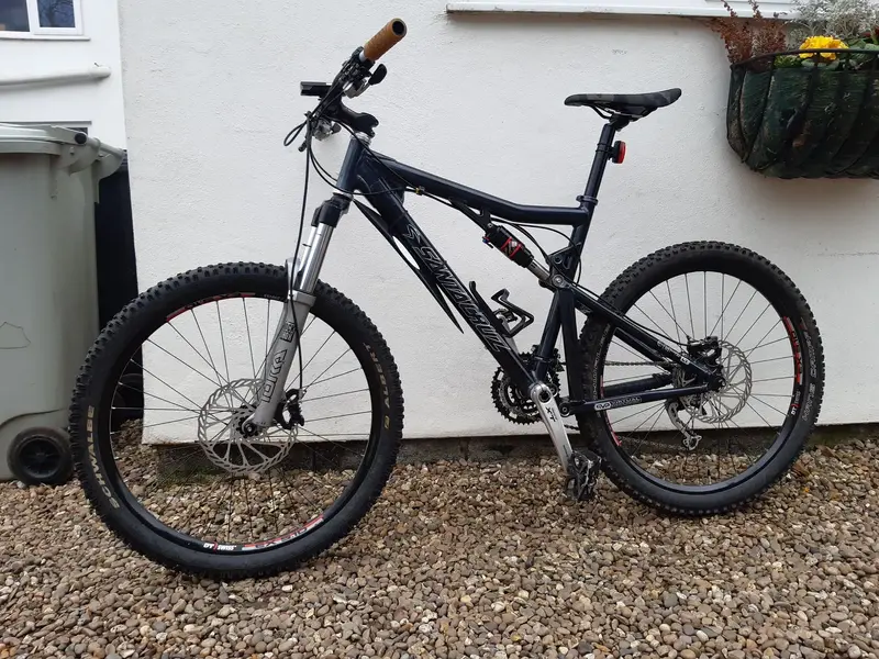

Finished! At this point the bars have been changed and the Answer carbon flat ones are back in the parts bin as they made the riding position slightly too low.

Ok. The parts list! There were very few compromises from my original list. Forks I could change at some point and the grips were some spares I had. I'd have liked Hope skewers too but if I change the fork, it may be a thru-axle one.
Frame: 2005 Santa Cruz Blur LT
Fork: Rockshox Tora 130mm (not 100% on these. May change if I find others I like)
Rear shock: Rockshox Monarch RT3 high volume
Hubs: Hope Hoops
Rims: DTSwiss EX5.10
Tyres: Schwalbe Albert (F) and Hans Dampf (R)
Skewers: ETC
Seatpost: ETC (dropper at some point)
Seatpost clamp: Hope gunsmoke
Saddle: DMR OiOi camo
Stem: eXotic (may change to a shorter Hope one)
Bars: Nukeproof 800mm riser
Grips: Cannondale Coda (will be DMR deathgrips at some point)
Brake levers: Hope Tech Evo
Brake calipers: Hope M4
Brake rotors: 203mm Avid front and rear
Brake hoses: Hope
Headset: FSA Orbit MX
BB: Shimano Hollowtech 2
Shifters: Shimano XT
Cranks: Shimano XT
Front derailleur: Shimano XT
Rear derailleur: Shimano XT
Cassette: Shimano XT
Pedals: Kona Jackshit
Chain: SRAM
Lights by Cateye as I ride on the road a little to get anywhere!
A handful of zipties to tidy cables and stop them flapping
A touch of insulating tape to protect the brake hose when mounted
A few patches of helicopter tape to help protect against frame rub and stone chips
Crudguard (old skool :D )
Spare bottle cage that may actually get a bottle at some point!
Splashguards/mudguards to be done differently soon.

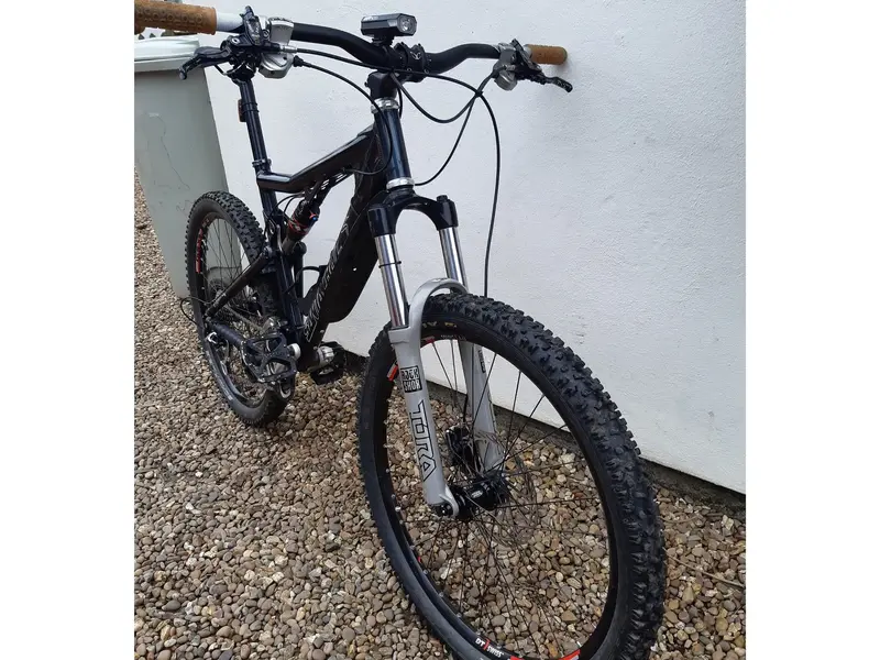

Thats it for now! It rides beautifully and stops like it hit a wall (LOVE those Hope brakes!) It will be taken out on proper trails when a chance arises.

Wow very timely article for me. I have 2005 Blur coming in the post today for my 2nd lock down build. Nice looking build.
Teggers
Old School Hero
Thank you! I finished it about 3 weeks ago but been back at work since. I'm looking forward to seeing your take on one!
This was pretty much my perfect spec. Although I have a Hope addiction, I couldnt justify the cost of their cranks too! Any bearings or friction material was new. Most of the rest was excellent condition used. Cranks were one of my star bargains though - used once, as new condition for £50. And the rear shock, similar story- seller preferred a coil shock on his Nukeproof Mega so took this off and it was mine for just £40!
I have a spare Hope Tech 2 brake lever linked to an M4 caliper set up for rear braking although if the hose was trimmed, the caliper fits my fork bracket and is spot on for the 203mm rotors. If you're interested. I got carried away on bidding and ended up with 3 brake levers and m4 calipers!
albash82
Nicely done. Been thinking about doing a Blur 4x build, as I put a deposit down on one many years back, but had to cancel :(
mamadirt
Very nice :cool: The Blur is one frame I always fancied but never got around to owning (maybe one day if a tiny one appears on the 'Bay I may swap my Bullit). I remember test riding a new Blur back to back with my Heckler at the Malverns many years ago - it absolutely shone, uphill and down.
