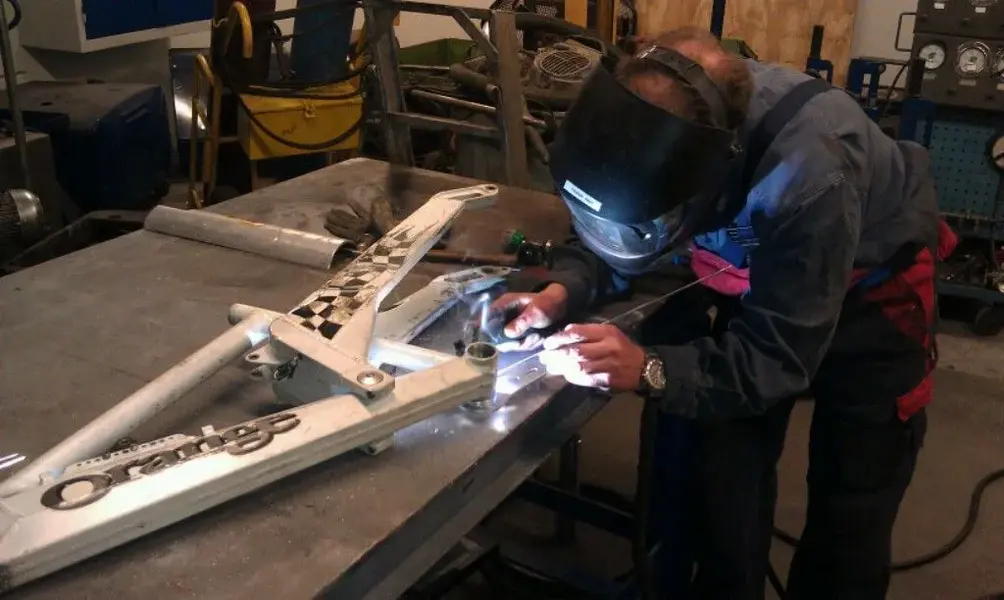

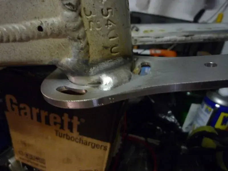

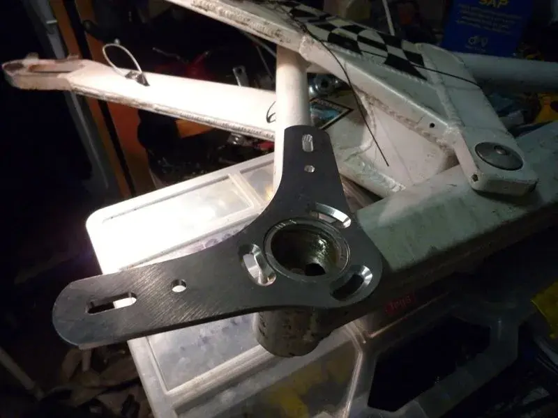

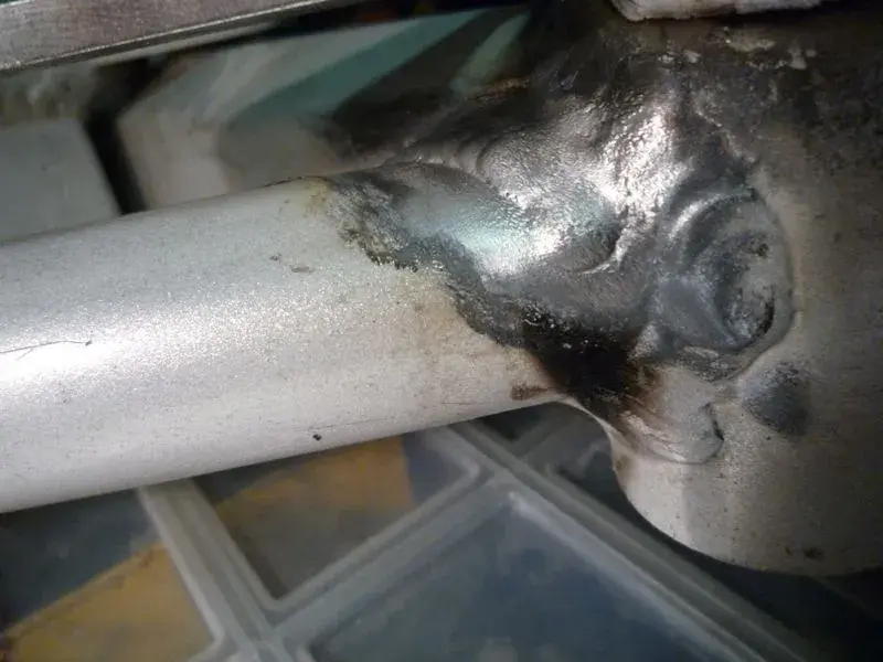

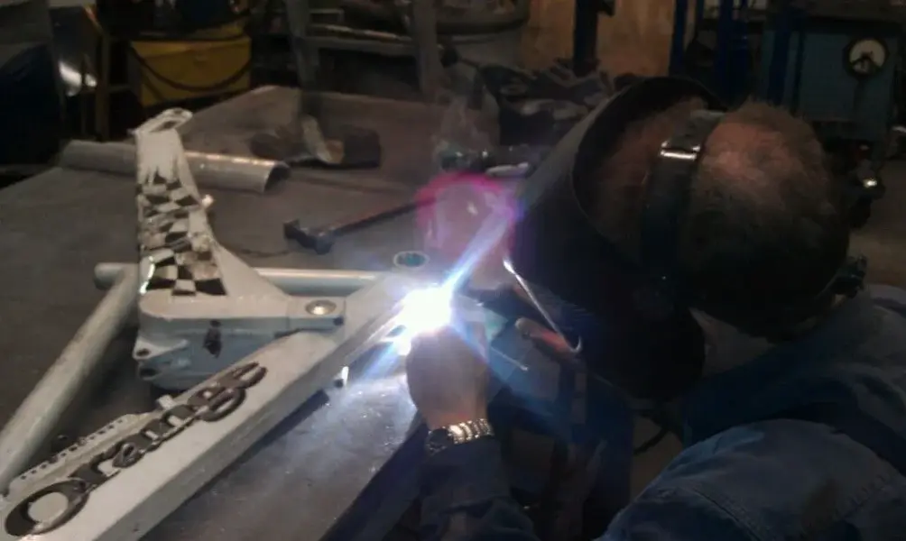

Here are some pictures of the two welded parts. The one behind the headtube was rather critical. And the one on the downtube/bb shell was too. But in the end we considered the last crack (shock mount) less critcal and desiced not to weld it.
Besides the two repairs I decided to weld on a MRP boomerang for the chaindevice. The 222 ddo mot have iscg tabs. So making the boomerang on the mrp sit tight has always been a challenge. But now it sits real tight :-)

No mate. Definetly not. I had the cracked spots welded and made it good for another 12 year's of service.... The fixing of the chaingard is a little rough. But the threads in the bb cannot hold the boomerang anymore. And they have already been rethreaded to Italian. So need to take some stress off them. Welding on the boomerang was the best fix without changing the bb tube. You may also ask why not remove the headset before repairing the crack here... simple. It has been glued into the frame as the headtube is oval. So the fixings are actually quite though through - and well made by a professional that does nothing but weld aluminium.
What you are looking at here is not a garage queen but a race bike. It do not have to be all that pretty. It have to be working and in order. I even consider not respraying it as it will remove all the scars of action that is all over the frame by now... Kind of like the look of hardcore use.
