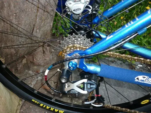

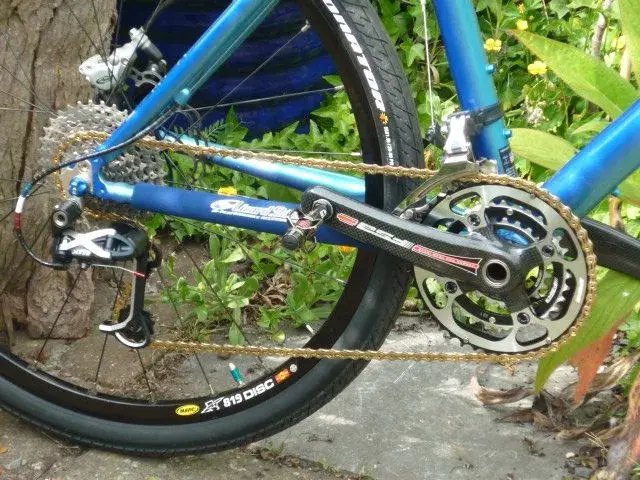

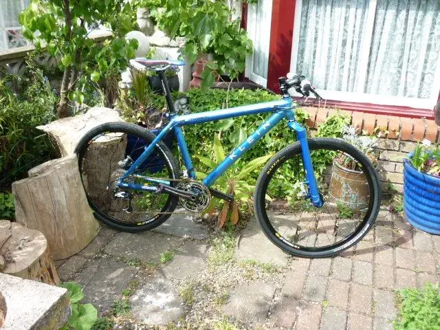

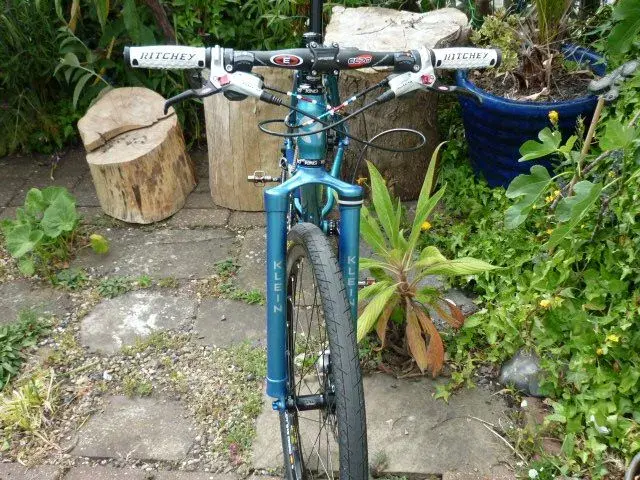

o.k she is finished for the time being and I have been out on her today :D
a couple of problems though :shock: my rear mech does not seem to have enough tension to move the gears up or down properly :twisted: :twisted:
I thought that m960 cassette and shifters were compatible with m970 rear mech :? :? also my disc brakes are not very sharp :shock: :shock: the pads are used but the discs are new :?: :?: maybe they will bed in :?:
Any suggestions :?: (my m950 works better at the moment than this new set up :shock: )
anyway pics below.

Evening mate. Juicy's - at least the higher ones that iv'e tried have always been finicky to set up. Took me 3 -4 bleeds to get mine right and they still feel a bit off. If you have a bleed kit make sure the lever reach adjust is all the way out so the lever is as far from the bar when not pulled as possible and the pad adjust is all the way out before you bleed them. Also i found that bleeding and leaving for 24 hours, then bleeding the lever helped as the air rises and seems to get stuck there. In the end though you may struggle, i have to admit i'm not a fan of the higher ones - my 5's where flawless for 3 years without being touched, my ultimates are finicky and a pain in the arse to be honest.
Cheers mark,I have just spent quite a while adjusting and bleeding them.The front one was the worst but they now seem to be fine :D :D

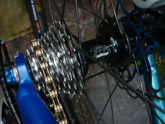

I have also swapped the xtr cassette for my dura ace one and the shifting is now sweeeeeeeeet 8) 8) 8) 8) 8) . I have just got back in and I think that the build has turned out quite well,BUT I will have to buy some lovely catbon sids as it is a very hard ride :shock: :shock: It as been a long time since I rode a rigid bike :wink: maybe I will get used to it :?: :?:
Below are some pics of my dura ace cassette.I think the gearing will be fine for my type of riding :wink: (to country pub and back after v.much beer) :oops:
Very nice, impressive weight for a fully geared bike
As for the brakes I had a similar problem and found that a muddy ride or putting some mud onto the discs and a few stops made them bite much better.
