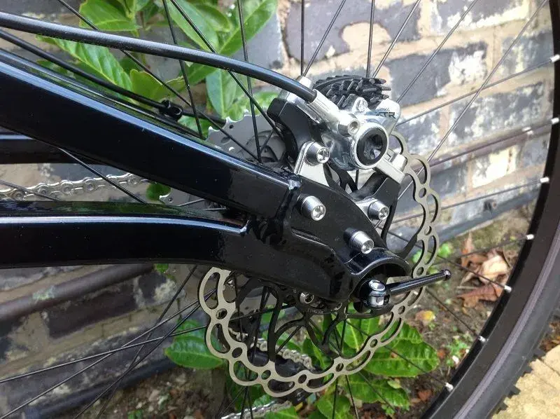

One thing I'm really not clear on is how the rear disc caliper is supposed to mount onto the swing arm.
I'm not sure how well the above pics show the situation, but when the caliper is clamped over the rotor, the IS mount attached to the caliper wants to be in the same plane as the (silver alloy) IS adaptor that's currently bolted to the swing arm.
I've seen quite a few Mount Visions of a similar age with disc brakes on the swing arm, so it's clearly do-able... feel like I'm having a stupid moment but any help with this one would be much appreciated!

Hmm, it's not a case of having to use a period correct caliper due to IS mount standards evolving in the late 90s is it? That would be a bit of a nuisance!
Would it not work with the adapter on the outside with necessary spacer between the brake and adapter to achieve the correct plane. AMP and IS adapters have been made they same way. Just a thought.
Yes, it would work if I put the silver alloy adapter on the outside of the frame, and then used a ~5mm spacer between that and the IS to post mount converter.
But I'm not totally sure if using 5mm spacers is a sensible idea given the amount of force that gets put through a disc caliper...
Benandemu from this forum clearly managed to get a similar set-up to work, and looks like they had the same style swing arm as I do here.
I agree with the 5mm spacer but others seem to live with it.
The image you show is a post mount adapter to IS. I got that to work with my AMP And Avids, but then could not get a IS Hope Minis to work. Had to make a new adapter.
