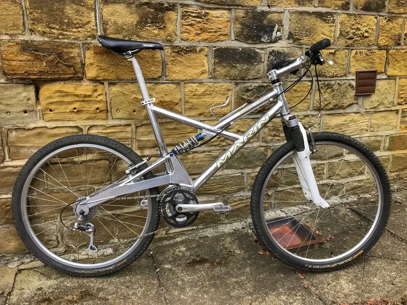

I've been busy in lockdown cleaning and replacing a few parts to get mine back to original spec.

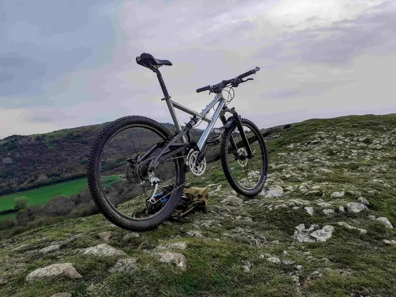

Back out on the trails now the mud's subsided!
Swapped out the trigger shifters for grip shift over winter and liking it a lot. Means I can finally get the brake levers in the right position for single fingered braking despite the narrow bar width.
Had to swap out the SID dual air shock due to a persistent leak on the negative air chamber of the previous one. Now running a fox float - despite being a bit less fancy it rides really well. Maybe a smidge more bob pedaling on the road, but could just be my imagination.
Still puts a big smile on my face every time I ride it, and consistently surprises me with just how damn fast it is!

Still in love with this bike!
Out of interest, is there anything remotely similar in terms of geometry and travel being made these days, or is this sort of bike consigned to the history books?
With the right marketing maybe it's time will come again!
"Still in love with this bike!"
I can see why. With a longer "top tube" and slacker head tube it would pass for a modern single pivot bike.
Just looking at your last picture did you anything to slacken the head angle i.e. longer fork or off set shock mounts?
The effective top tube is already pretty long on these bikes (at least when combined with a 100mm stem) to give a nice stretched out riding position.
Haven't tried offset bushes, as I'm really happy with how it rides and don't feel the need to slacken it off. It's a fairly short axle to crown fork (RST Delta) so pretty much stock geometry.
TBH the BB is already quite high and I'd not be massively keen on raising it further with a longer fork!
