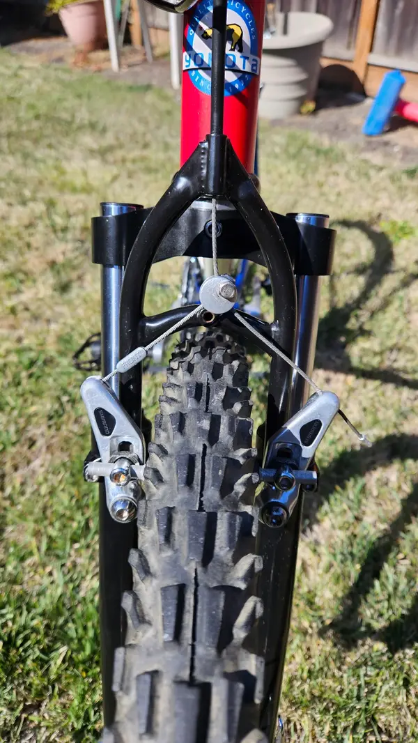

reminds me of an RST.
same here
obviously similar to early RST suspension forks, RST 300 or 500 from 1991 and 92
Nicely documented here https://retroforksbike.pl/en/category/rst-en/
Some had been also sold via other brands like Ridgeback
Just all of those had been listed as fluid damping and have been sold with an air pump.
As the caps on the top obviously don't have valves. It must have been somewhere else, maybe also on the fork in the Yokota?
Can someone recognize the picture on the right to identify the location of the Schrader valve?

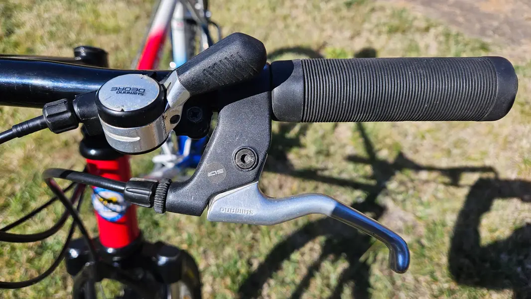

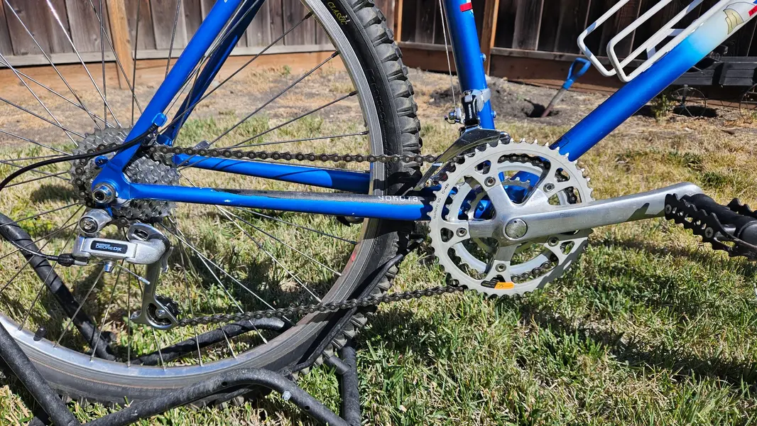

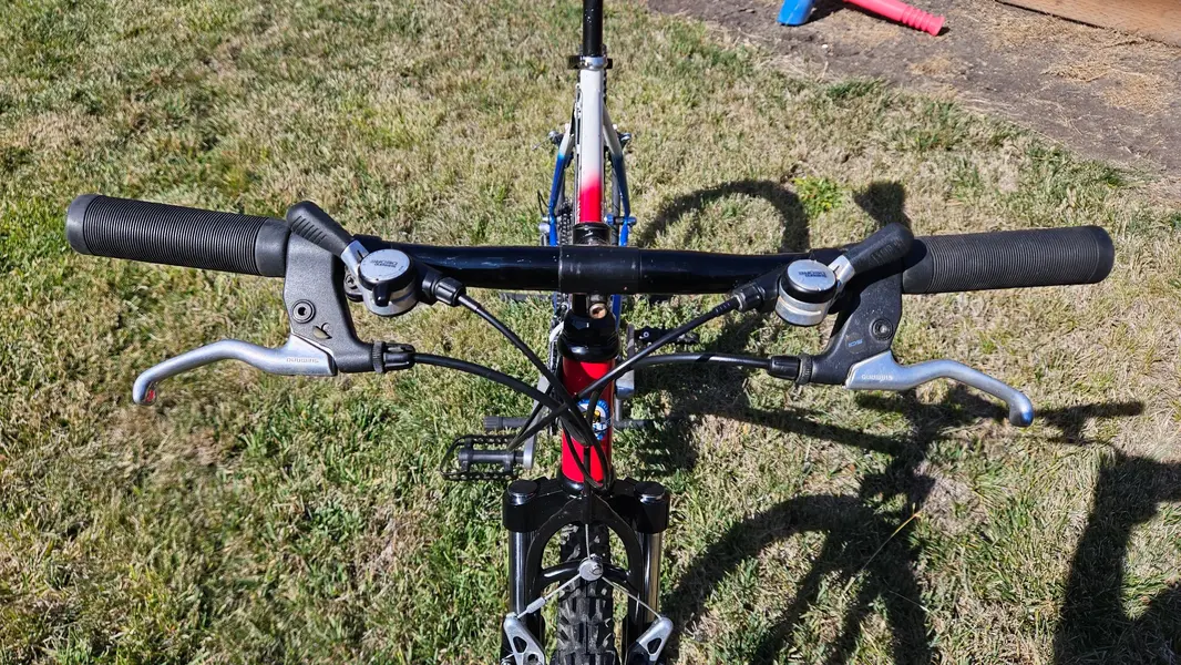

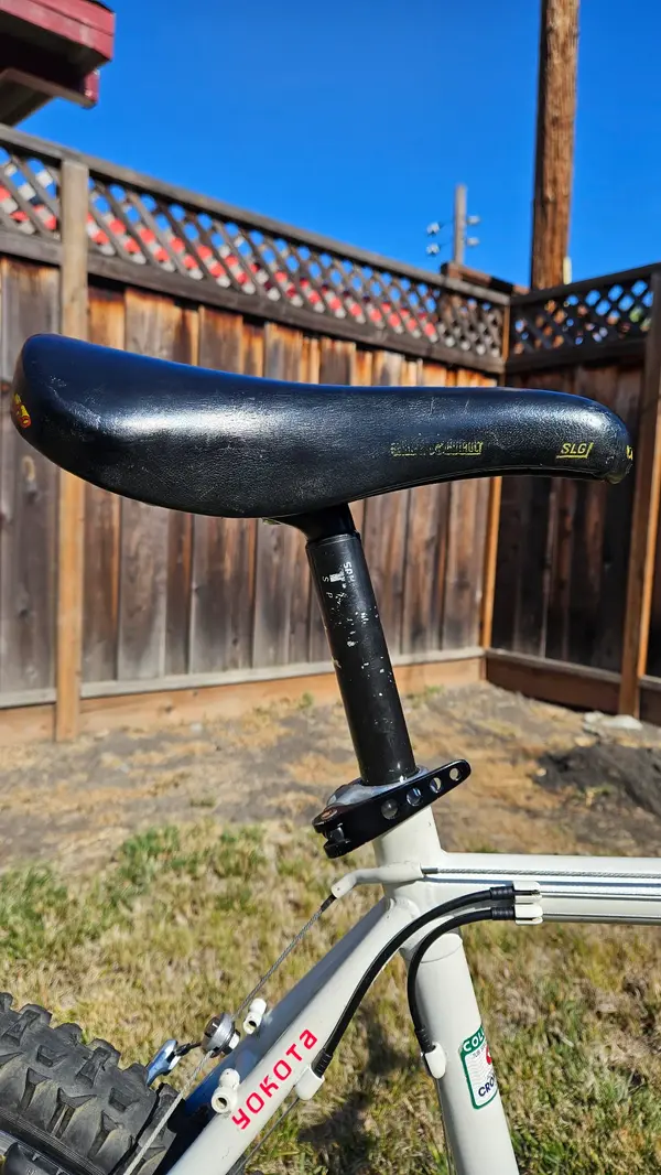

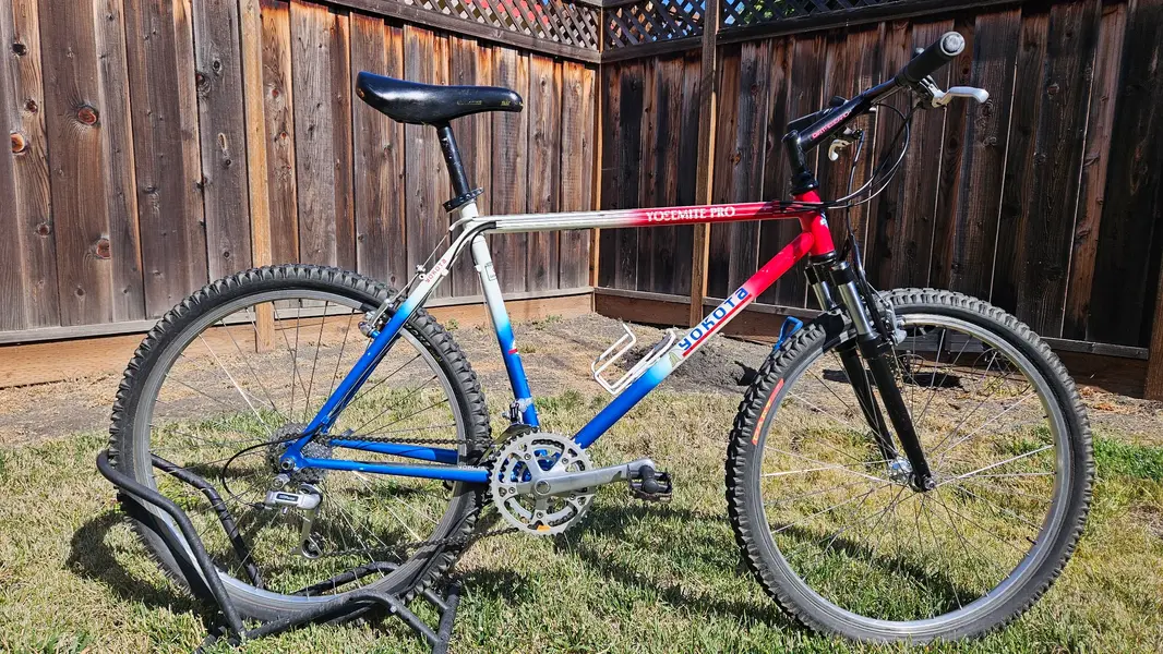

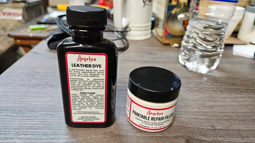

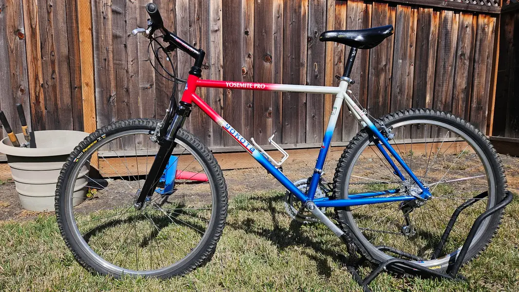

So definitely an RST300 and branded with Dirt Research. Higher end fork has those awful looking air fittings on the backside of the stanchions and likely needed service more often than the elastomer version. The Pro bike is completed as of just now and came around nicely. The saddle was rehabbed using Angelus Leather Filler and black leather dye. Really easy to use, just make sure the filler has a day or so to set, sand, apply dye, buff then apply leather conditioner of choice. I did find some black wall Panaracers in my shop, not accurate but get the job done.
