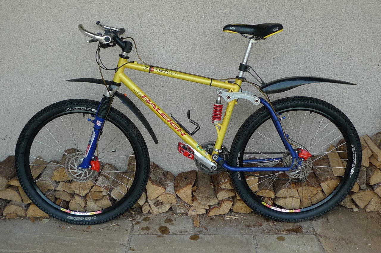

I have never heard of this bike, which surprises me. I had an M Trax Ti 2000 which was a 1994 hardtail. I later fitted a Rockshox Quadra 10, my first suspension fork. Anyway, I found this picture of one like yours............
I see that the suspension compression relies on flex in the blue seat/chain stay part. That's years ahead of it's time. Some contemporary FS bikes rely on this but most use an extra pivot around the rear axle location.
Yeah I'm not too surprised you haven't heard about them, when trying to find information on the bike apart from a couple of old forum posts there isn't really much, from what I have read though they all agree that its an excellent frame and like you say quite ahead of its time, I'm suspecting it may be to do with the state of Raleigh's reputation around that time, although thats just from what I've read, I was 2 when this bike was originally built :lol: , Ive heard a lot of good things about the old m-Trax Ti frames.
I should hopefully be getting my frame back tomorrow, I've already messaged Gil about getting some decals done but they're a bit out of my student budget at the moment so theyre on pause. Im considering getting some Rockshox xc30 forks for mine, they seem to be quite good value but im not too sure since I've only recently got into mountain bikes but I know theyre one of the best brands, I'm also on the look out for a used groupset, if only I had a better budget theres so gorgeous ones about :lol:
I see that the suspension compression relies on flex in the blue seat/chain stay part. [SNIP] ... but most use an extra pivot around the rear axle location.
If you look closely, there is a Horst link on the chainstay in front of the rear axle. These are a proper 4-bar bike.
