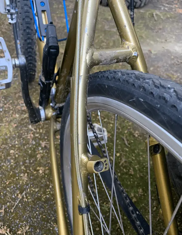

Is to become a 700c gravel commuter for me to get to work ... 20 odd miles each way. Maybe 3 times a week over summer, hopefully.
Any advice?
Im looking at a drop link to make the rear mech run a wide range Sunrace cassette 11-42
Go to single narrow wide on the front... 36t?
Wheels - relace onto some DT 'gravel' rims 700c. Some kind of tan wall gravel tyre.
I have a random Kona Libre carbon 700c fork, 1.5 tapered head tube but I believe I can run that in here with a special bottom cup. Or run a P2 as we have some 700c ones in stock...
Mock up with a random rear 700c wheel (x38c)

It'd have to be a very special bottom cup wouldn't it just yes it would. You got a link to see one do it's thing?

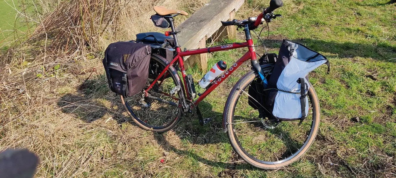

Ok, it's not a Kona, but it is a Joe Murray bike, being a Voodoo. It was originally a 26" hardtail MTB, but aim running narrow 29er rims with 700c tyres. The fork is a 1 1/8" straight steerer though.

It’s an Ec44/40 bottom cup from what I remember. I think I have one in stock. Will play about with it. I think I have a well scratched up Nos p2/700 disc fork somewhere gathering dust so if that’s straight that’s easier.
Ec44 would require your head tube to have a 44mm internal diameter though. Y'aint got dat.
In honesty, I need to check out what I have exactly, but in my head I have a bottom headset that runs an external bearing that allows a taper at the bottom end, and while raising the head tube a little, given enough fork steerer, it lets it all work.
Or I could be wrong.
Im not in my headset box of stuffs at work.
What Albash says. I've just used the EC44 for a tapered fork in my On One build. It replaces a semi-integrated cup on a 44mm head tube. Older bikes, like your Kona and my Voodoo have a 34mm head tube that does not have any option for a tapered fork that I am aware of.
We will see! Im sure there was a work around.
Either way, I have enough P2 of various kinds I can make something work, for a super budget switcherooo
