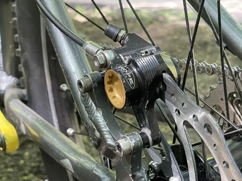

The front was, as suggested, 180mm because it was the Mono Mini and not the Mini. I did try a 175mm because even the 180mm initially looked too high in the caliper but that just dropped the disc was too low.
The rear ended up being a 180mm too. It should have been a 160 but because of the incorrect mount it seems to have shifted it up 20mm. Again - tired the 175mm because it looked close but that dropped it down way too much.
So it's 180/180 for me!
