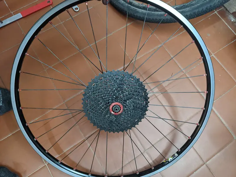

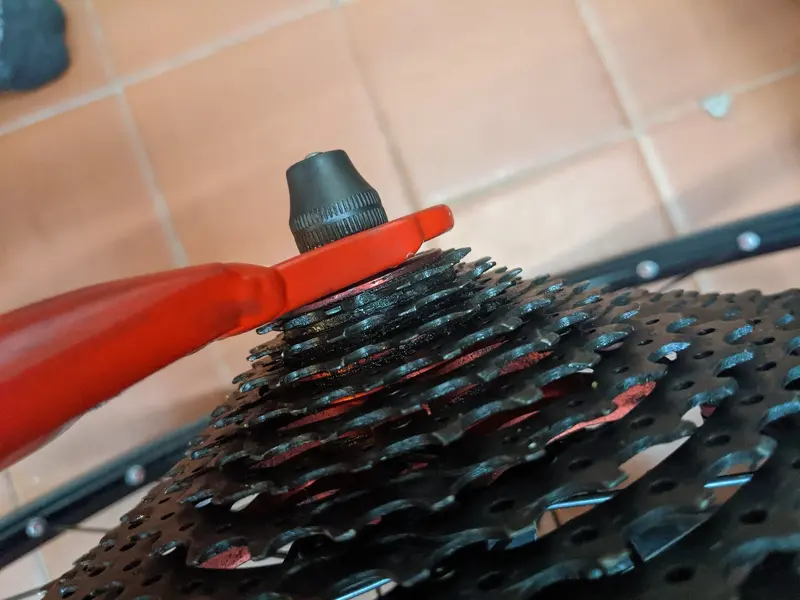

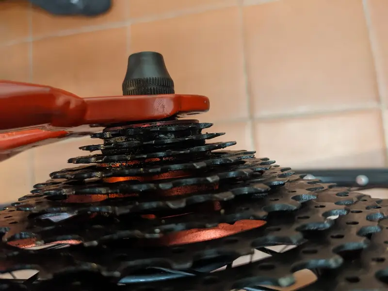

Ok, well I tried to fit a 11spd Shimano road cassette and it didn't fit hence why I'm trying to swap out the free hub body. I left off 1 of the rings on the 11 speed and I was able to fix the cassette to the free hub.
I have a sunrace 11-46 which I will try fit on it.
I would like to build this bike up with sensah srx pro 1 X 11 with drop bars.
The wheels are not original but definitely from the same area.
This might be incorrect, but from what I understood recently…
11spd MTB cassette will fit on there and work with an 11 spd MTB rear mech slx/xt/xtr etc.
11spd road cassette would not fit, you would need a different freehub - grx runs 11 road.
11spd road and MTB mechs and shifters are not cross compatible, different spacing, pull ratios etc.
I will happily edit/delete/learn as someone more knowledge comes in to correct me….
Well done mate! You just saved me a lot of time and money. 11 speed MTB cassette fits perfectly. Thanks!

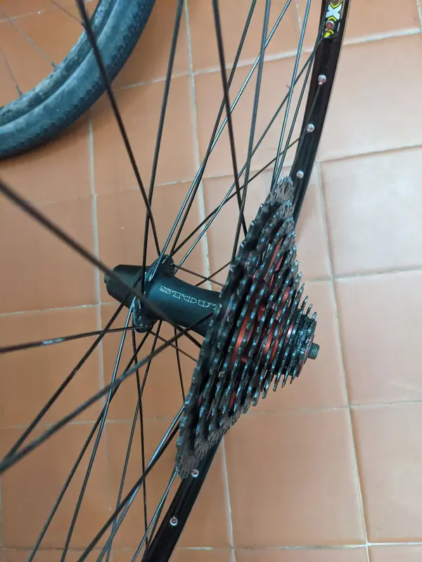

I’m not convinced the last post by the OP looks right either! Surely it shouldn’t the that tight to the frame???
