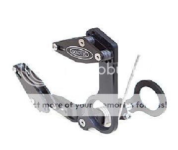

Goldtec Manacle £50 for the non sprung version at BETD

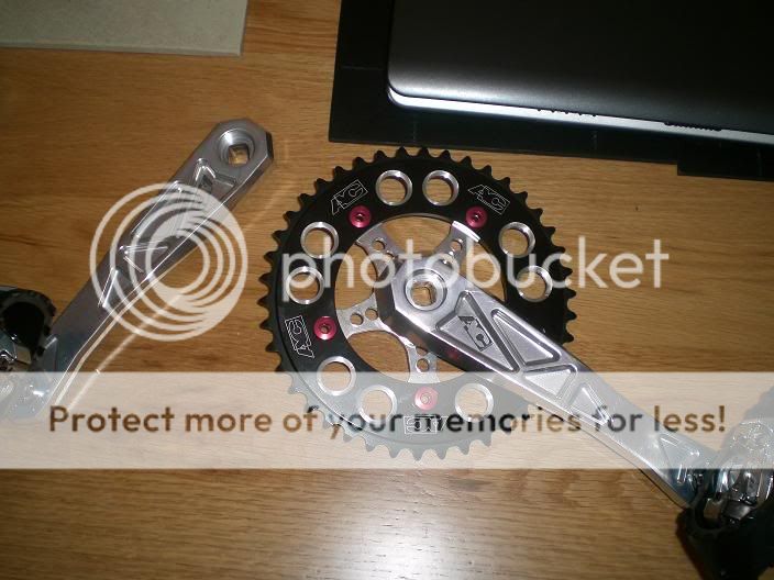

Here's my chainset put together with a brand new Holeshot 8)

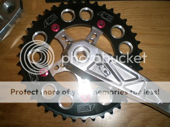

Those AC cranks and ring look the dog'd wotsits :D

The BB been fitted. For those that want to know it's a 73mm shell with a spindle length of 122mm. Perfect fitting for those AC cranks. The chainset is on and I've got to say it is looking superb.
