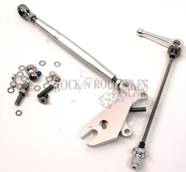

I've been reading your account with interest. I have an FSR '98 and wish to add a disc brake to the rear. I have an A2Z but not yet fitted as I'd heard that the angled Specialized dropouts were not suitable. I note that you've used one. How is it working for you?
I am not averse to tinkering and have considered modding the A2Z to more suit the dropout. I've considered adding a strut to attach to the left hand brake boss via a rose joint just to spread the braking force a bit and perhaps eliminate the unable-to-brake-whilst-moving-backwards scenario.
Something along the lines of the attached onza version...

The mount has been fine, bar it is a little hassle to remove the rear wheel when punctured.
What i have been thinking of doing is converting the rear axle to an oldskool solid type and just bolting it up as tight as i can get it with hand tools, i have wondered about braking "backwards" it is not very often i have done it, so it has not been an issue so far.
The wheels/tyres are being converted to tubeless so hopefully punctures are a thing of the past soon anyway, removing the wheel should not happen so often.
Righty, i did a nice 22mile XC ride on the FSR last weekend and i discovered a flaw.
Upon climbing an absolute KILLER hill, i gave up, hit the brakes and stopped, the back brake being locked on then simply rotated backwards on the A2Z mount, as the entire brake adapter rotated backwards on the rear dropout.
It was a steep hill, and its probably not going to happen a lot in the future, but it has made me think "is this adapter worth it?"

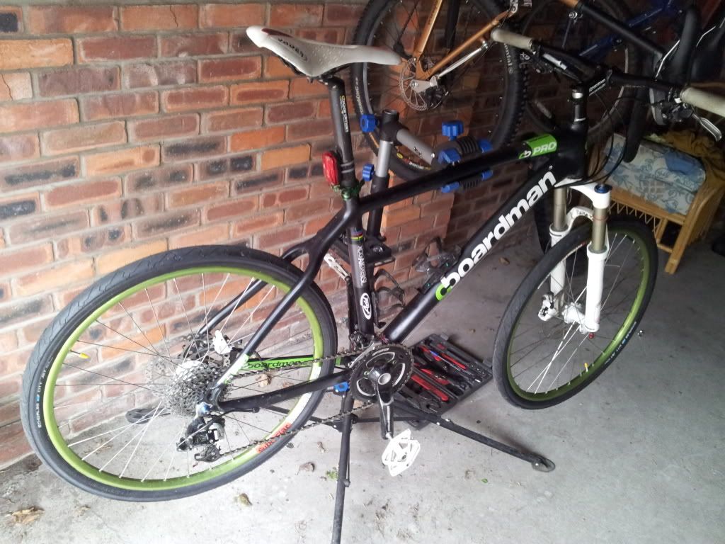

Thought it was time i updated this thread a little, the Boardman has gained a set of commute tyres as i am now doing 9.8 mile x2 per day riding to work and back :P
It seams to be helping me lose even more flab (currently 17.5 stone, down from a monster 21 stone!)

Onza rear adapter was fitted to replace the A2Z version

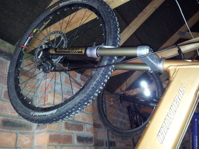

The front RockSHox Psylo fork was binned, and in its place i fitted a 2001 Marazocchi Z1 Dropoff (130mm travel)
The fork was stripped down, the lowers were repainted and i added some gold Marz Bomber decals (could not find any drop off ones)
The handle bars were stripped back from the white paint i added to them, and left in the natural gold anodising to match the bike/fork decals.
The stem was removed and painted black to match the fork lowers (i used black hammerite)

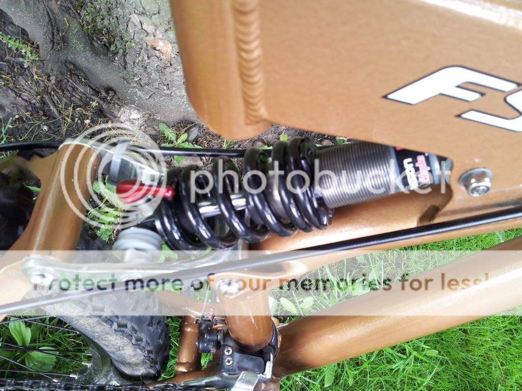

I also removed the stock rear RockShox Deluxe and in its place fitted an X-Fusion Glyde rear shock that i picked up brand new for pennies.
I needed a shakedown run to test the bike out after the mods, the local MTB club was away to ride around Hexham/Allendale/Slaley forest, so i figured it would be a good chance to test things out, and i did, up against a 2006 FSR, a 2012 FSR, and a Spicy 514
Some quick shakedown thoughts, the back end for me was perfect, i have the preload on the stock X-Fusion spring wound right out as far as it would go (its a lower spring rate than the RS Deluxe) i suspect as i lose more weight it would be an issue anyway, but it was smooth and supple, and we really hammered it down some rock downhill trails, i bottomed it out once on a hard landing, but it was not a big issue, i also bottomed out the front work at the same time lol
The front fork needs a little work, for me personally, i like a bit more compression damping, and the fork felt a bit too flexy for my taste, the stanchions look mint, so the plan is to try a new set of bushes at some point, i have already drained the stock 7.5wt oil and refilled with 10wt oil, the compression damping seams a lot more to my taste now, hopefully the flex will disappear when i get around to swapping bushes.

its not such an issue for me now anyway as i really rate the Onza rear adapter, it has worked flawless for me since i fitted it.
My ghetto tubless rear wheel failed last sunday while out on the trail, and i had to remove the rear wheel to fit an innertube, i simply removed both track nuts, gave the calliper a wiggle and pulled the wheel clear, simple!

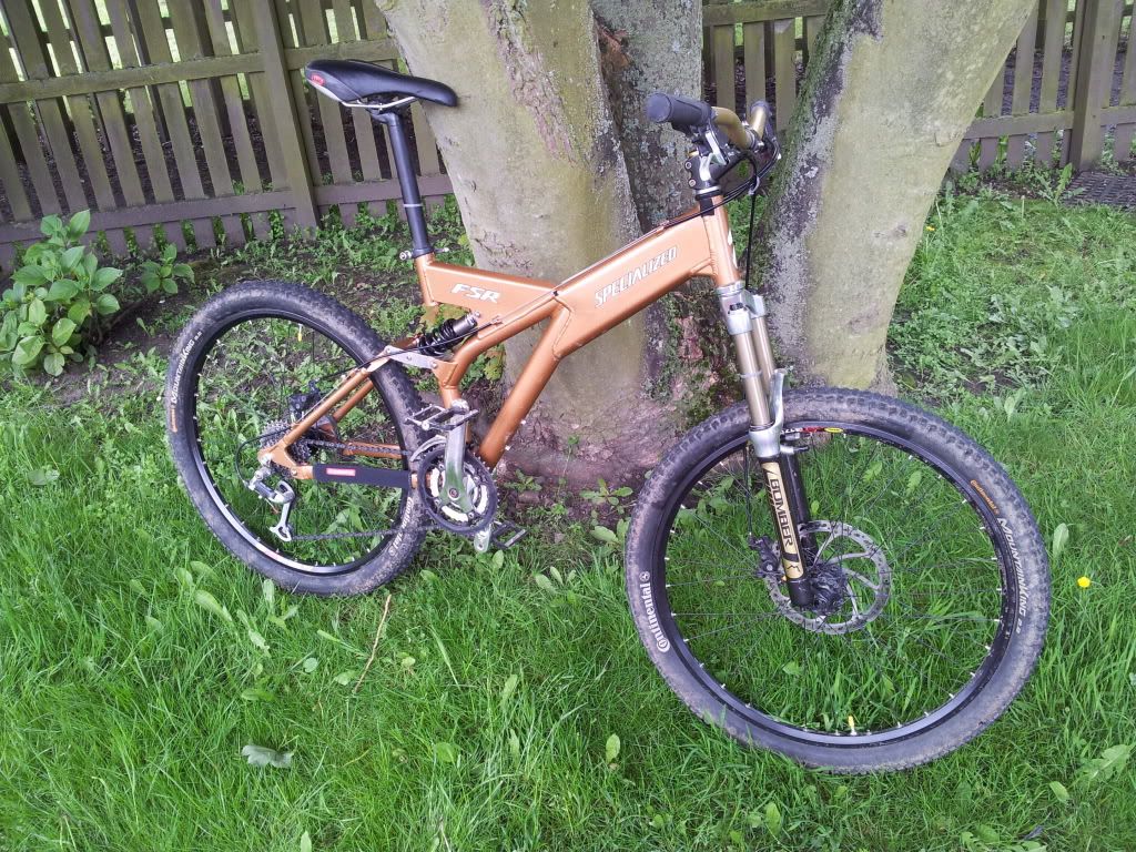

The bike as it is currently.
The X-Fusion Glyde rear shock, please excuse the tempory white nylon washers used as spacers, it was all that my local B&Q had in stock at the time, i am waiting for some black 10mm nylon spacers to arrive in the post (must chase that up!)
