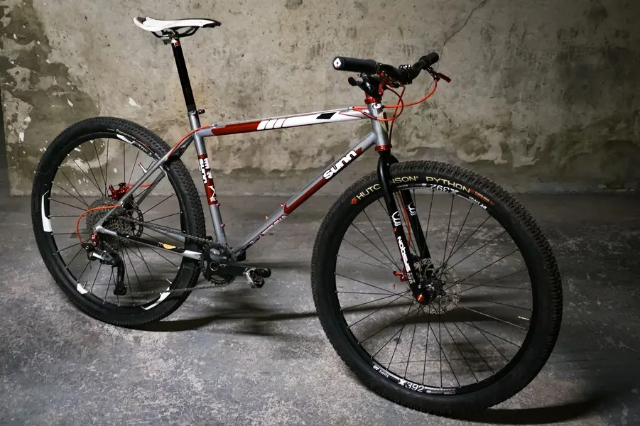

So I was looking for a new project before a meeting coming in the beginning of June this year.

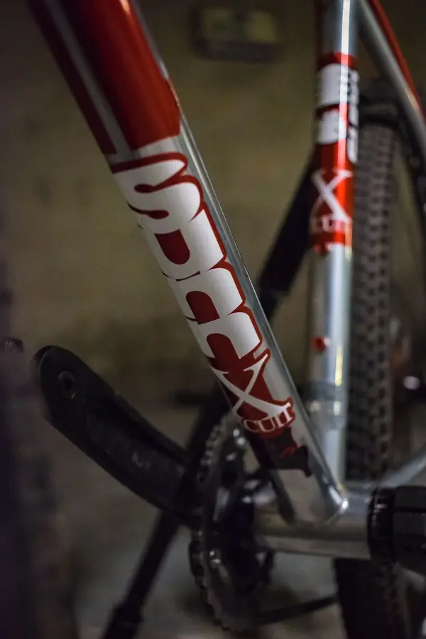

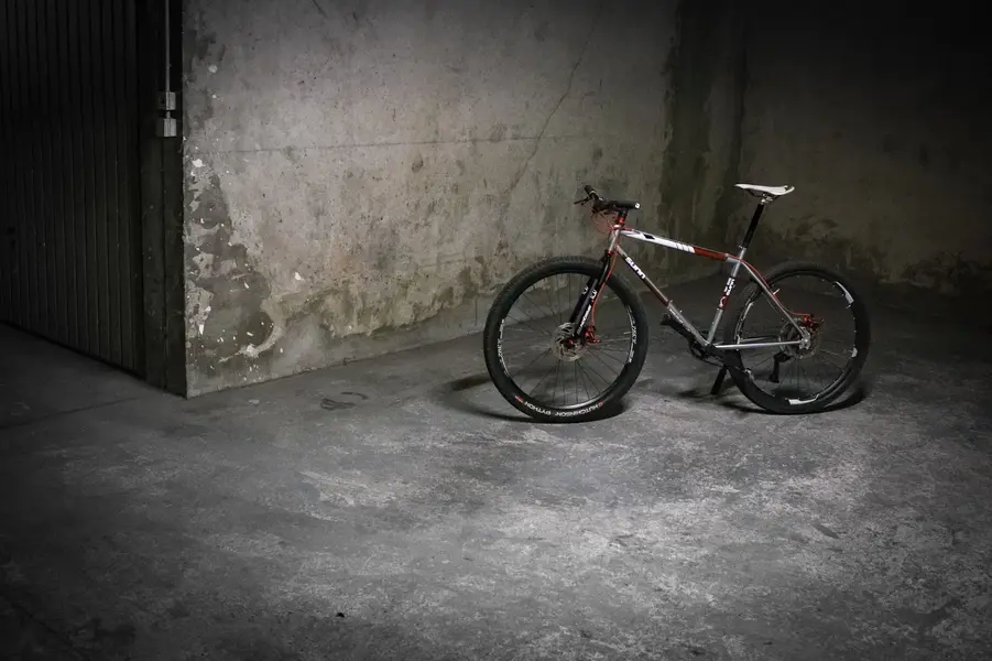

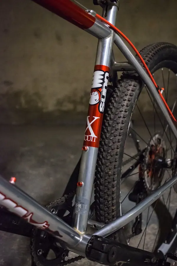

I am living in France and I'm a fan of the Sunn brand . I've got some frame and made different kind of decals NEORETRO kits for them. I've made a new one for this new project.
The frame is a 1997 Xircuit / M Size / and Tange made.

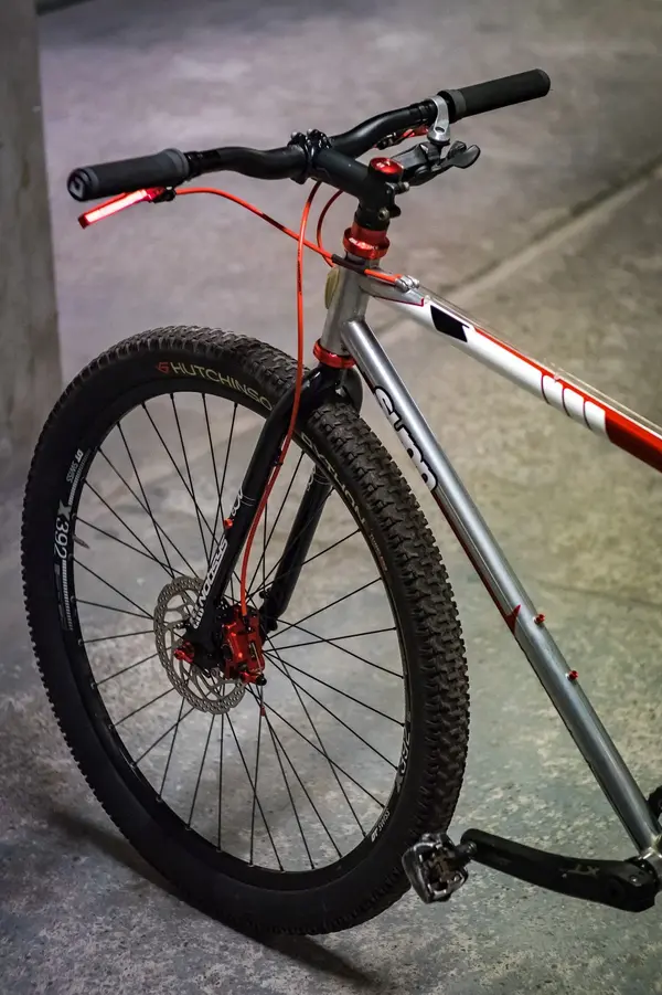

Because of a lack of good opportunities on 26" light wheels, I've choosen a pair of 27.5 ... with disk brakes. One of the advantages of this size was the possibility to mount of really big front tyre. Here is a 2.25 Python.
The fork is a KonaP2 26" disk brakes and the 27.5"/2.25 is ok on it.
For the rear brake I've used a cheap adapter with a handmade cut. And it works too !
It's a 1x10 speed as you can see on the following pictures.
