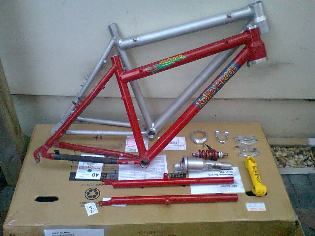

1997 Nuke Proof Reactor hardtail

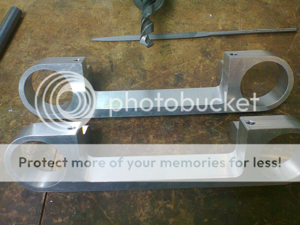

Good news guys! I just got an e-mail back from the CNC guy. The price on three sets of braces is going to be 275$(a set of upper and lower brace) with everything done and anodized.
A slight increase but still pretty good. I also asked him about the additional price of having the Nuke Proof logo engraved into the upper brace, he said it would be an additional 30$ if we do it before the anodizing(which makes the most sense) and 40$ if we do it after the anodizing (in case someone doesn't want the engraved logo, additional machine set-up cost). Here's a quick Idea of what that might look like.
Let me know if you're interested in having the engraved logo as well or not.

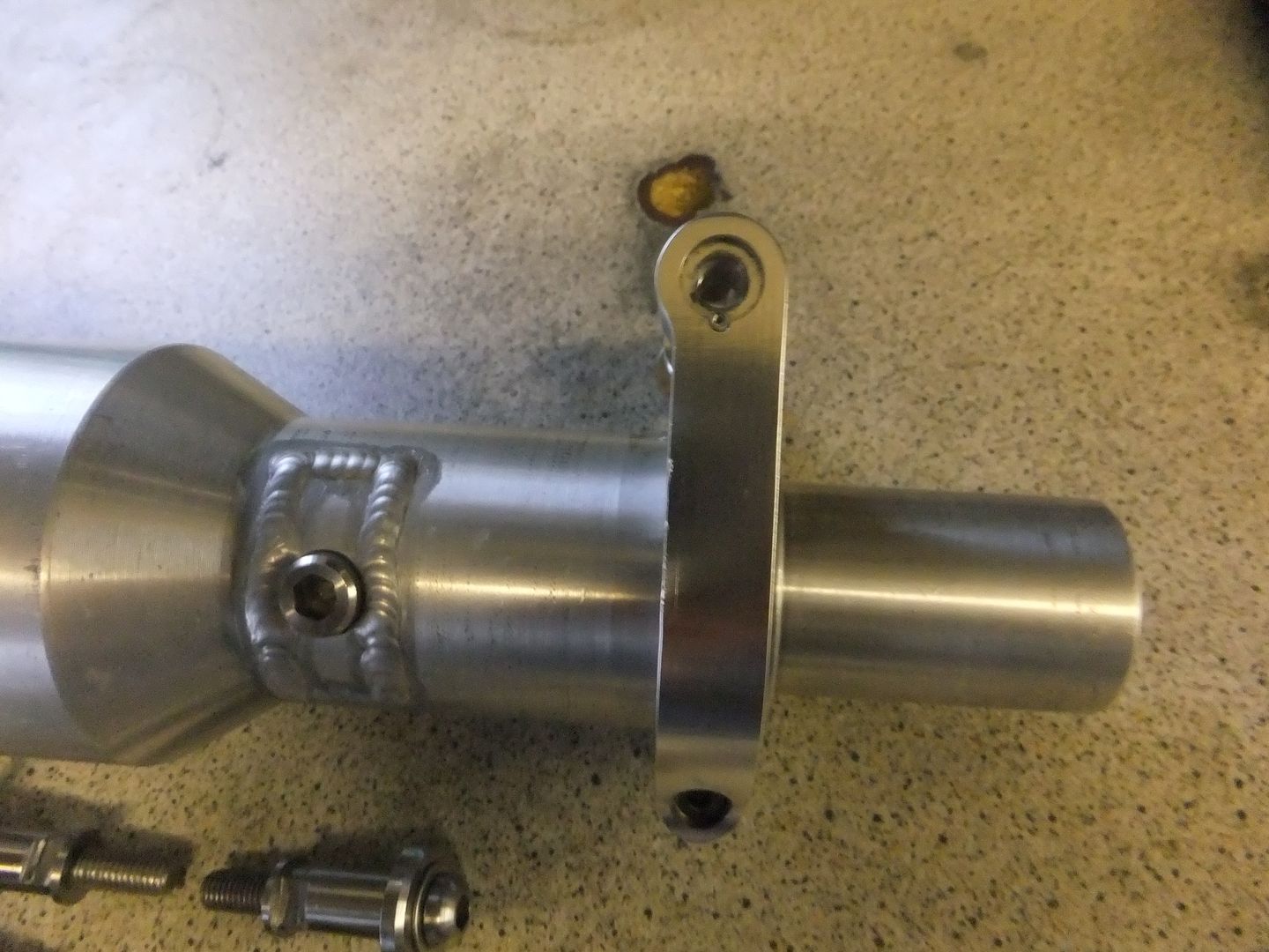

Hi , been looking at jango post of his Reactors pictures and they raise some questions , so needing HELP on the details on the fork braces , making 5 sets but i am unsure of the detail on how the link arms ( top and bottom ) connect to the braces , i see from one of your pictures of the top brace i can see a counter bore ( or spot face ) on the raised part of the scollop , is this an insert ? i have got this far and a little stuck at the moment .

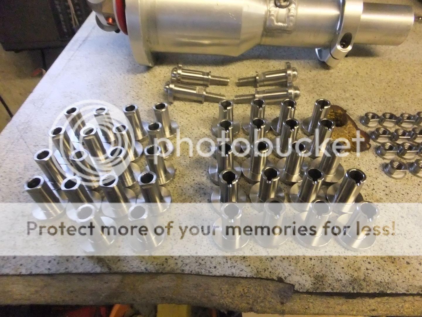

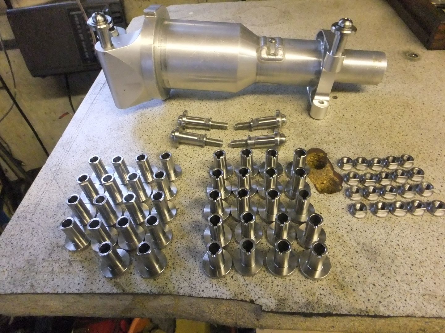

I also have a run of about 5 sets of the top hat bushes being made out of a stainless steel that is heat treatable which will make it work with the needle roller bearings , its the bolt that goes through this bhttp://i1274.photobucket.com/albums/y4 ... 7pq.jpgush to the fork bush that i'am concerned about , what that bolt goes into , 1 a thread in the Ali fork brace or , 2 is there a threaded insert in the brace ?

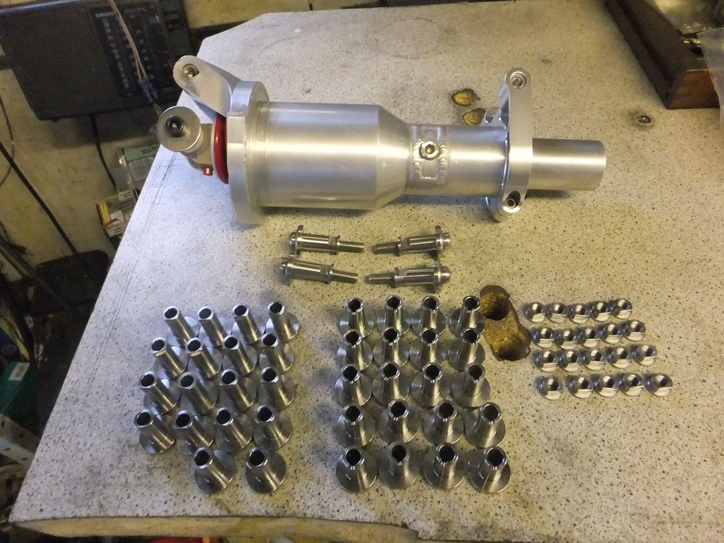

Right guy's progress has been a bit slow at the moment , dew to the fact the CNC mill is been taken up with REAL work !
So progress so far is many thanks to Kevin who has the only ( at the moment !!!!!!!!!! ) complete Nukeproof Reactor in one piece in the UK and let me take the fork linkage apart to see how they were put together .
As you can see Raul i have put the roll pins in the top and bottom location holes , they are 5mm long X 2mm dia .
Hopefully you can see from the pics that the top hat bushes are different , one takes a slot to locate the 2mm roll pin and the other has a flat on it that will locate in a "D" hole in the fork brace , yet to be machined ,
