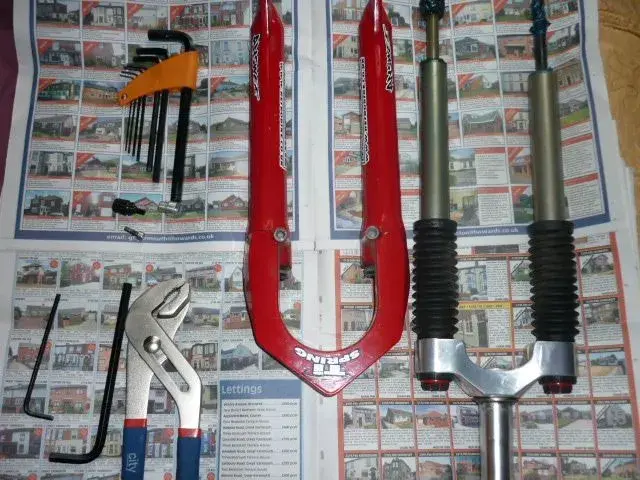

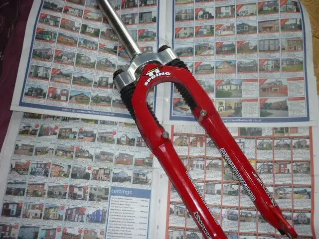

Just in case anyone has got fed up with stripping their non grease port forks down to service them :D see below;
1,remove the adjuster from the lower leg
2,remove the 8mm allen bolt under the adjuster
3,remove the 4mm bolt from the other lower leg
4,pull up sharply on the fork crown and the lower legs should seperate
5,remove the fork seals with a sharp edged screwdriver (be careful)
6,remove the upper fork bushing from both lower legs

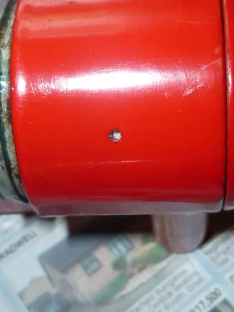

7,If you look on the back of the lower magnesium legs you will see two small holes in the bulge section (in pics below)They are off centre.
8,take a 1mm drill bit and drill the hole right through.(very easy to do)
9,when you have thoroughly cleaned the inside of the fork lower legs (flood them with degreaser and wash out).
10,put the upper bushing back in with a small amount of bostik behind it (a small amount :wink: ) and make sure you line up the gap in the bushing with the small hole you have drilled :D
re assemble the fork (pre greased) and when the service time comes around again just put your grease gun in the pre drilled hole and give it a few squirts,hey presto grease injection forks :D (you can use two very small screws to block the holes so no grease comes out under compression but I have never found this a problem)
