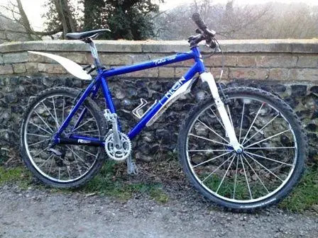

So I've nearly finished this, just a paintjob and and an xtr chainset to go..... yes yes I know its Trek Klein and only just scrapes into this section due to her age but I really like it and its my daily ride, I want an Attitude really but frames rarely come up.
Use carbon bars and Use carbon post, Use CNC stem, XTR 952 mechs and V brakes, XTshifters/brake levers, on one rigid forks, Mavic Crossmax SSC wheels..... be nice
yep forks are too long, max 80mm travel for those bikes, I have one and the original rigid fork was 390mm long.
Ah well it rides ok, I measured the suspension it came with and these were the same length so I guess the shocks were too long too....

Forks are 420mm so not a million miles away and as I say, she rides a treat for my daily hack... Carbon bars and post take away some of the bone shaking ;)

I'm also on a Trek-Klein Pulse '97 and with a similar length fork! The paint falls off every time I take it out, it is a nice ride though.
So what are the options for a correct length suspension fork then?
I have a pair of SID 2002 which I'm thinking of reducing to 60-63mm travel, I'm not really bothered about correct age but getting close to the correct geometry would be nice.
