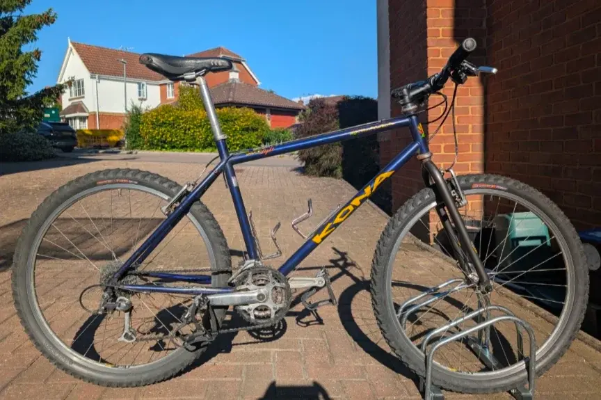

1997 Kilauea - 20"ish - St Albans

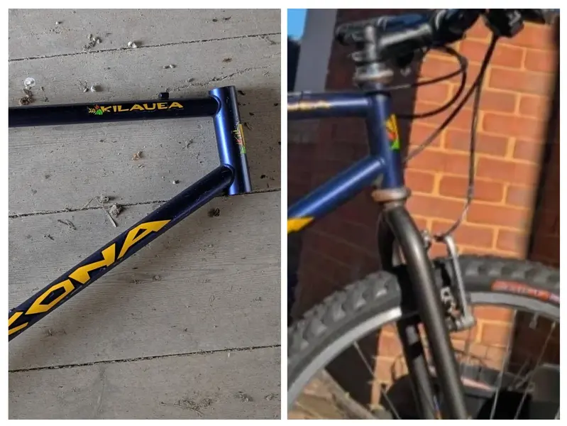

I'd recommend getting a good builder to roll it out - I guess it might take a bit of searching to find someone with the correct tooling but worth the effort for such a nice riding frame
I can roll it but it's also torn the steel in a very small area - thinking of rolling it and then brazing a patch over the top. It won't look great to many but it'll still ride just as well!
I need to get some pic's and ask the experts on here whether I need to create crack arresting holes at either end of the split before covering,
