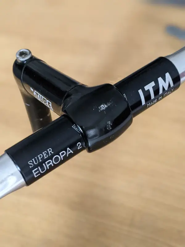

Some progress: The bars are described as “SR CMB 240 H 430 Tilver”. I reckon that means Sakae/Modolo Anatomic. Something Japanese would have been nice, but I’ve sourced these never used 25.4 mm Italmanubri instead PXL_20210327_164023713.PORTRAIT.jpg

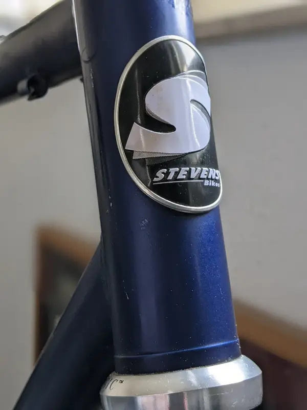

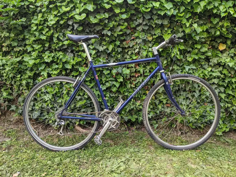

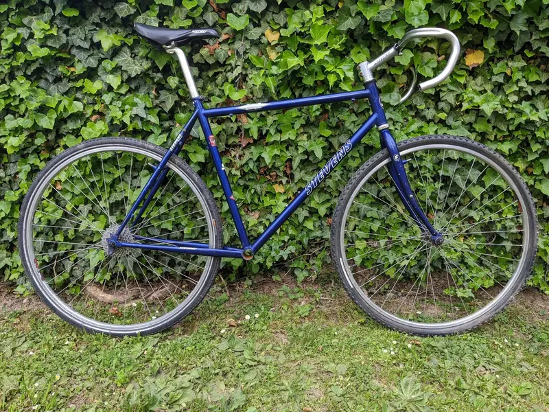

Stevens “7.6.2. Comp”. Exact year: Unknown, as they aren’t well documented. Also no numbers on the frame or forks indicating a date. But guess something around 95. It’s just a make of a german wholesaler from Hamburg, but I remember thinking of them as being cool bitd and I like the lettering :cool:

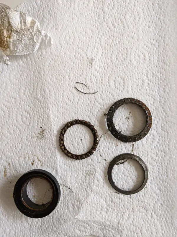

Maybe it’s a short story again: The bike was standing in the backyard (total mess), when I picked it up. Telling from the matte paint for a looong time. It even surprised me that the seatpost wasn’t stuck. The headset was baked to the forks and hardly moving even with the help of a hammer🔨
Maybe I’ve destroyed the lower needle bearing by tapping it off, no idea where these two metal fragments belong to. Frame needs further inspection regarding rust, but after some polishing the paint looks acceptable again👍
