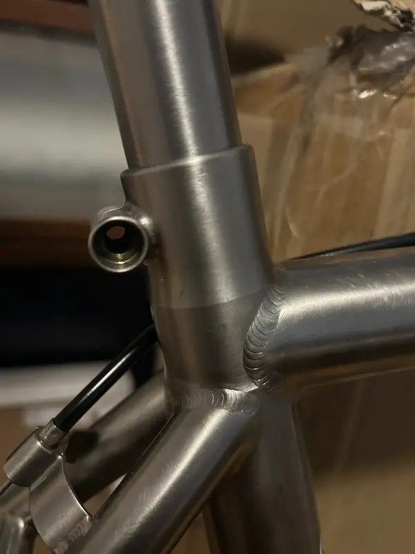

Also, can someone explain why seat collar area is beveled and seems thinner and than rest of seat tube?

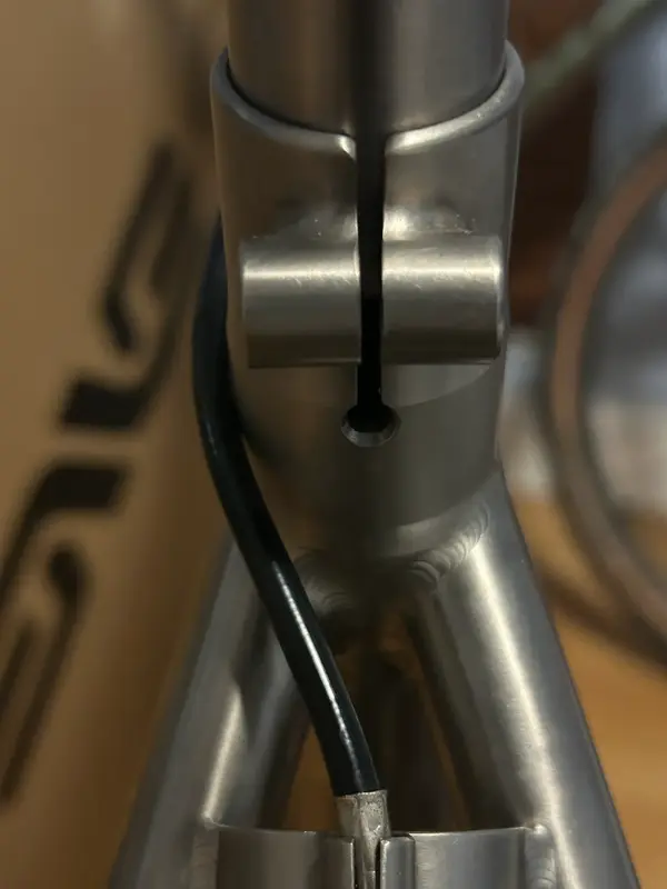

Here's some photos.
The beveled part of the tube is externally machined, I´d guess for weight saving.

The slot in the seattube seems parallel. Mine was not and gentle persuasion with an old post opened it up again, but still some posts won´t fit. So I guess for you that just leaves reaming it out? Again, worth checking out if the frame or the post are off.
