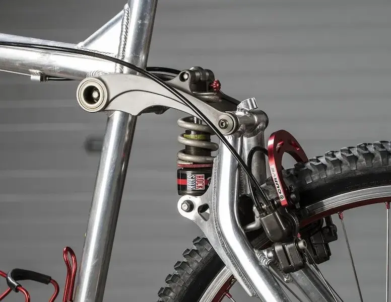

Nice , I have a ITS-2 also. I need a new rear shock bit it looks a bit different than yours : My spring is silver metalfkake and the eye is very round .Do you know if yours is original or is it a replacement? It is hard to get info about them! Mine looks like the attached photo and like the one in the link; https://www.ebay.com/itm/115437563624
No, I don't think my shock is original. I think it should have been a RockShox deluxe instead. But then again, any short 145mm shock will do.
Yeah I agree, Do you know what you have? I will look it up .
Thanks

@d333gs About the shocks. The frame came with a DNM firestarter DV-22 in 135mm.
But my LTS Thermoplast, that has the exact same rear end geometry came with a RS Deluxe in 140mm. So there you go.
