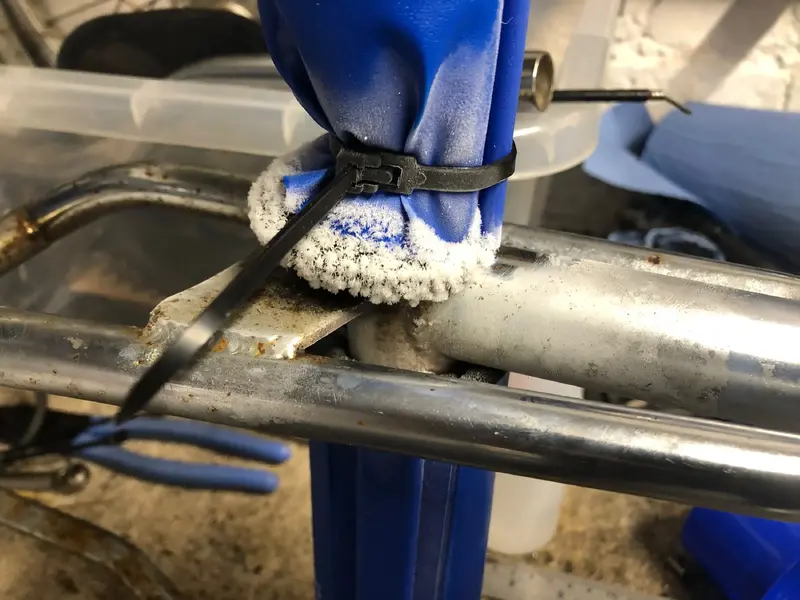

Pipe freezing kit on order “click & collect” from Screwfix for the morning.. E031A76B-FD56-44F6-BF16-E8FC026818DD.webp
Don’t talk to me about anaglypta coming apart.
Got a slide hammer kit here if you need it.
Ok, so far we’ve tried wd40, PlusGas, freezing & heating to cherry red, all the time using a slide hammer...
No joy... I’m gonna have cut/drill/ream the bastard out! 🤦 814F0DE5-B914-4354-877B-80AA6DEC93D4.webp FB215631-BA22-4E01-9F32-D7D6B5126526.webp

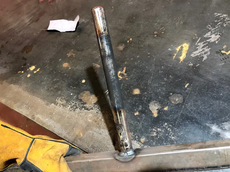

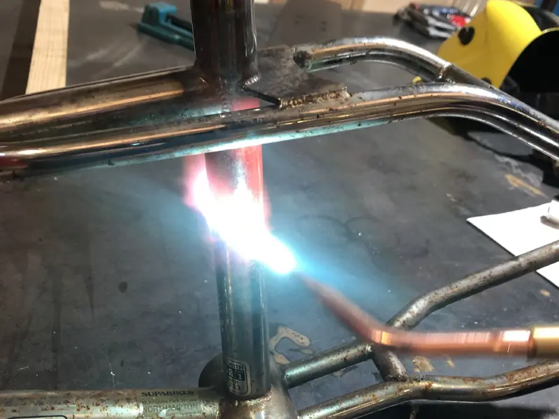

Nope... surgery planed for this afternoon.. not feeling confident though as there is 210mm of steel post in a 240mm seat tube, leaving me with a 30mm cutting stroke... it’s going to take forever. :facepalm:
Whoop! Whoop! :D
Thought it was worth one more last ditch effort this morning, so I welded the post to piece of box steel, clamped that to the bench and heated up the seat tube, working from the bottom.. and she gave up the goods! :D 79CB6CC9-83FD-432F-92A8-869EB391DCD2.webp A2F8D000-9148-46F9-94F0-7B99EC9858A6.webp
