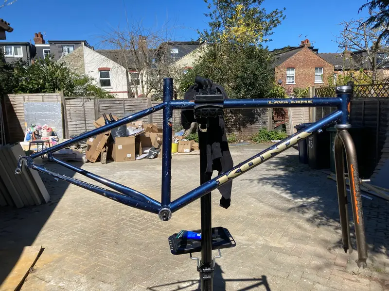

My second build thread on here! When I first joined Retrobike I asked about building a bikepacking bike, here it is. I originally bought a 14" Brodie Energy for this build and it turns out that's way too small for me. I was measuring frames wrong this whole time and it skewed my perception of frame sizes drastically. Luckily, I spotted a 16" Lava Dome (unknown year) on FB for £90 that I also picked up in the case that the Brodie wasn't right, which turned out to be the case! There will be some photos of the Brodie here so that should clear up any of that confusion. This bike is being built for my trip from London to Croatia this summer. The route I've picked is a mix of everything really, so thats reflected in the build. I'd also like to say a big thanks to @Mr Scruff , who supplied me with an XTR M950 wheelset for this build, free of charge. :D If anyone can ID the year on this bike please mention it! I think its a 95 based on my research.
Here's some pics from the FB advert for the Lava Dome.

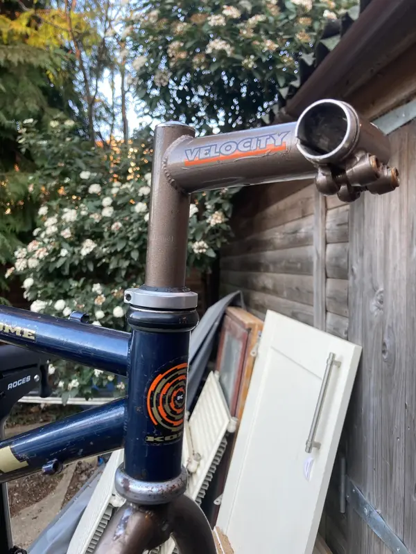

Unfortunatley, this bike seems to have been stripped for its good parts and built up on the cheap, probably by a bike shop. The drivetrain was a 1x7 with Raleigh Truebuild wheels, "one-piece" cranks where the chainring was integrated into them, a Tourney RD and cheapo Shimano thumbshifter. I probably overpaid for this in hingsight. Anyways, I stripped it down of all it's rubbish and gave it a clean. It turned out ok, looks like someone had a lock on the toptube which caused a bunch of paint chips and the decals are slightly cracked, but nothing major. Luckily, the original stem, bars and fork were all there and it came with a nice Charge Spoon. :) More posts/pics to follow.

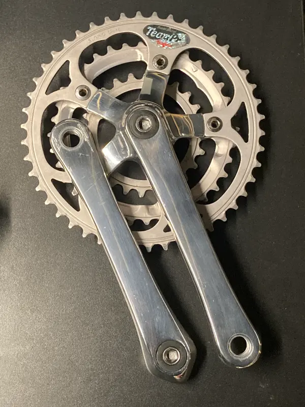

Next up I had an issue with fitting my cranks. The BB was obviously swapped for one with a narrower axle to sort the chainline out and to harvest the better, more delicious BB inside. :D It was quite overwhelming trying to figure out what the right size BB was to get and even with some measurements I couldn't figure it out. I went for a 68x122.5 as that's what I found on Sheldon Browns site. Turns out it was the right call, as the cranks now fit perfect. Just found a thread on getting replacement decals for em too! IMG_8135.webp

A headset service was next. The Brodie I intially bought was a threadless headset and I'd bought a new silver Tange one to fit, but now I'd settled on this I wasn't sure what to do. I've contemplated swapping the fork, but I don't really want to use the Brodie fork for aesthetic reasons and finding a new fork is either expensive or time consuming so I think I'll just stick with threaded Joe Murray Impact headset for now and use a stem converter. This was the most horrible headset I've ever felt on a bike, really lumpy and gritty feeling. There was a LOT of old grease inside which took a lot of soaking in mineral spirit to dissolve. All the bearing races seem good apart from the top cup which has some mild pitting and the bearings in the bottom are also a bit pitted, but it seems okay. I'm yet to regrease it but I'm pretty confident it will work fine.
I wanted to take both headset cups out just to give them a proper clean, and the bottom one had a bunch of rust on it. This turned out to be a bit of a nightmare and the bottom cup took probably 100~ mallet blows. I had to precariously hold the bike on the floor with my body weight, braced with a bit of wood so I wouldn't bend the deraileur hangar. The top cup wouldn't even budge after about 30 hits so I didn't bother.
Happy I bought the proper tools to do this with too. It was only £20 on Ebay for both a headset press and a removal tool! Saved me a lot of hassle or a trip to a LBS.

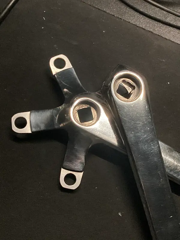

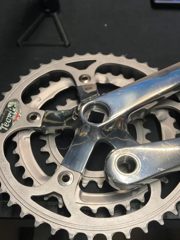

Spent many hours polishing today. Went over the frame with some Autoglym Paint Renovator but I found it wasn't really harsh enough for the condition of this frame... T-Cut did the job much better, photos below show only after the Autoglym. Also decided to polish my crank arms. Half a tube of Autosol and a couple hours later I've still got half a crank to go. Ended up just buying some polishing attachments for a drill. Ordered some replacement decals for them too. I also re-fitted the Impact headset which is decently smooth.
I've accepted that this bike is going to have a somewhat ratty look. I don't really have the time or money to do a proper respray so I'm just gonna run with it.
Polished the crankset... Didn't realise the rabbit hole I'd began until it was too late. Did it mostly by hand until the drill attachments arrived and took a whole tube of Autosol. Interesting how my phone makes them look XTR gray. IMG_8209.webp
