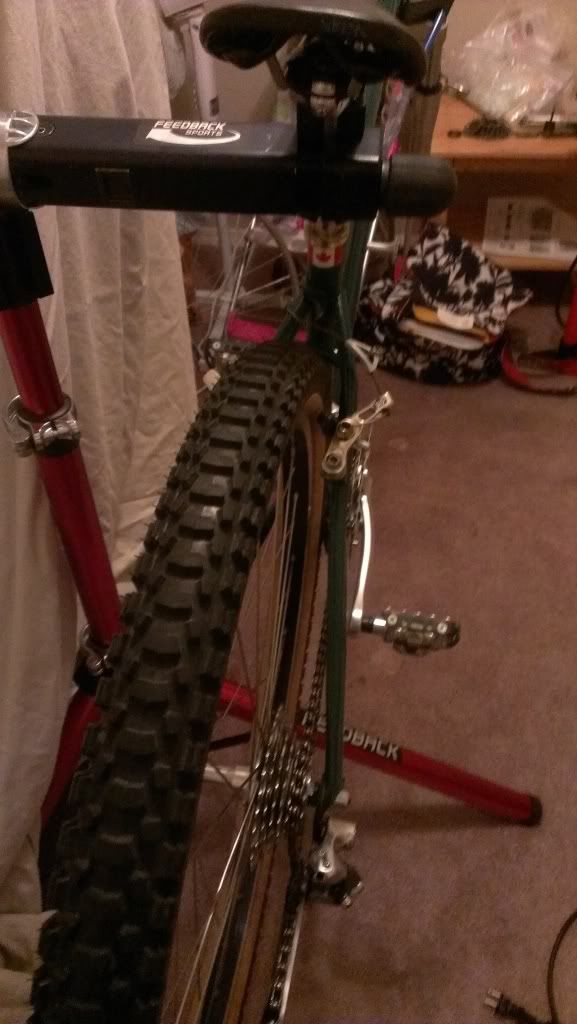

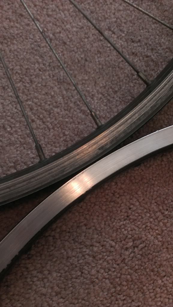

I had some time today and got down to refurbishing some ayara rx-7 rims for the build

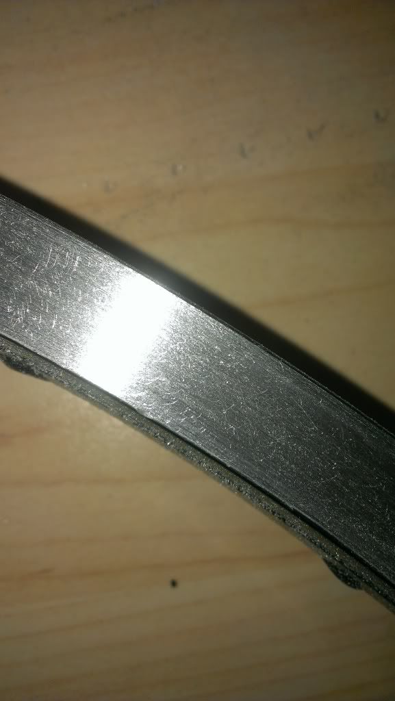

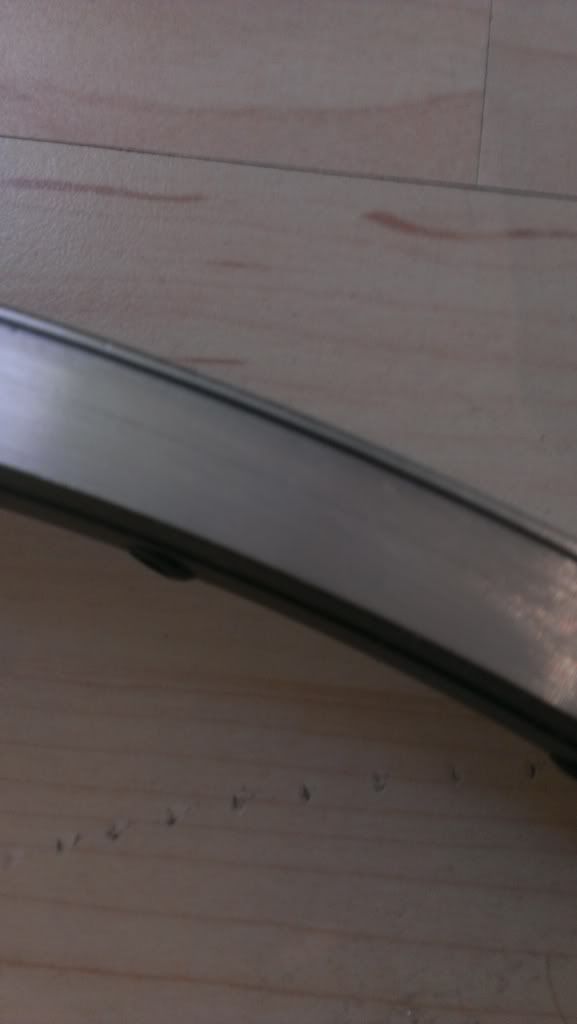

Here is a picture of the resurfaced front rim compared to the back one
In my ocd I even got rid of the small ridges left from braking
I also cleaned and polished the top

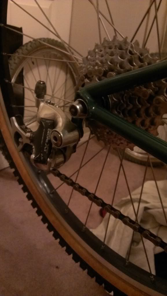

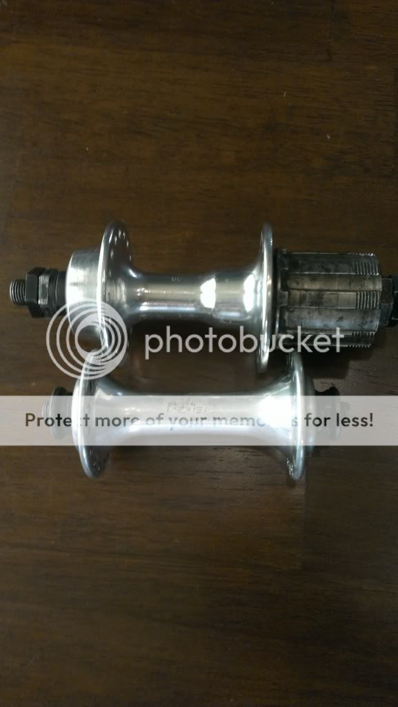

I also have the hubs sorted out. The front will be a shimano xt m730 and the rear will be a shimano exage rear hub which to me looks identical to the m730 shimano rear hub. I rebuilt both with new cones and grease
I refinished the rims with 110 grit sand paper and a lot of sanding. I then finished them off with a SOS pad to get a nice even finish.

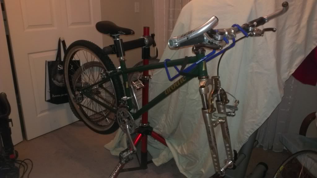

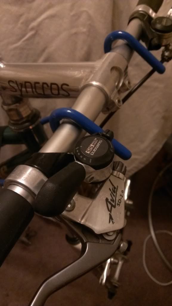

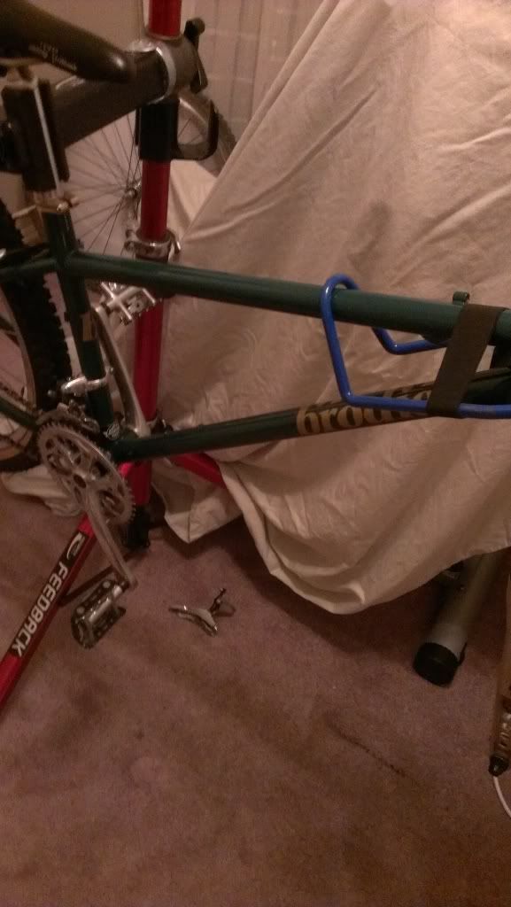

And to answer your other question the blue contraption is a park tools handle bar holder. It comes in handy when working on a bike in the stand so the bars don't flip flop around every where

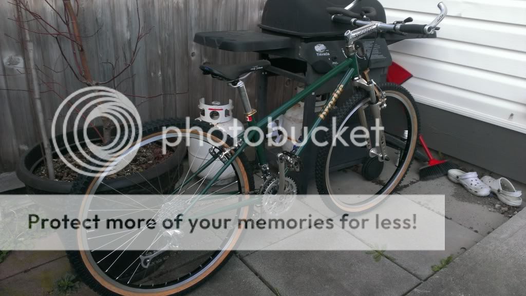

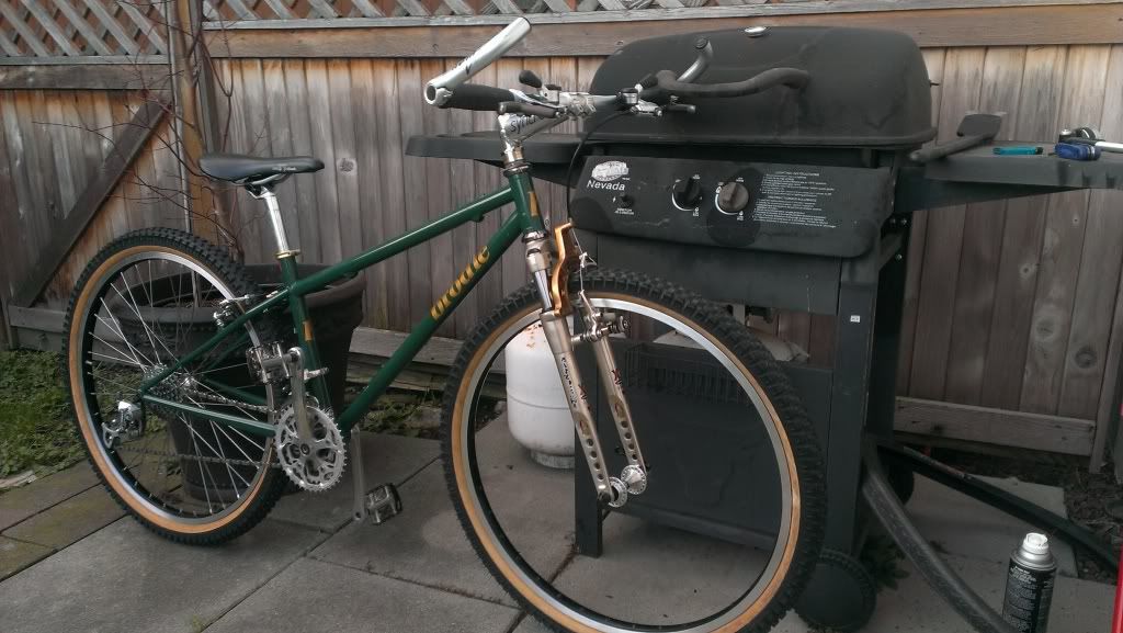

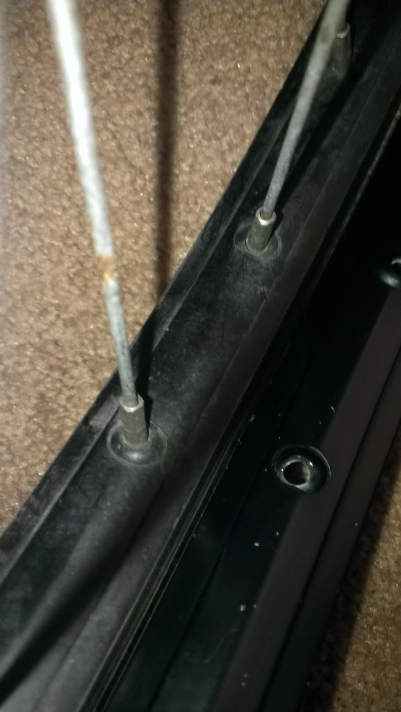

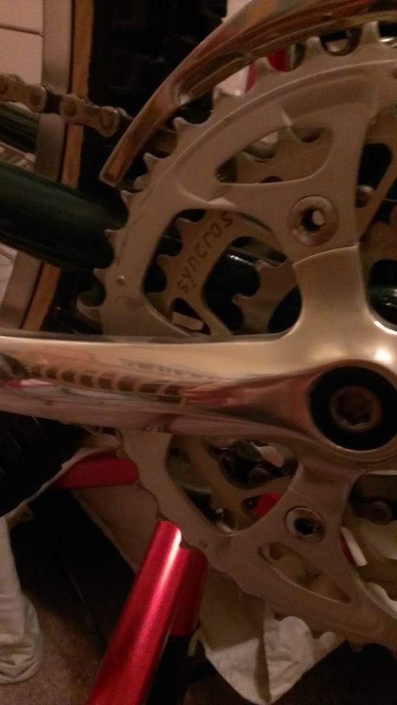

I couldn't help but take some more pics to show how its going . I got the front rim all buffed up and resurfaced went to go lace it up and I grabbed too long of spokes :facepalm: now I will have to wait till Tuesday when the shop is open again and trade in the spokes. After that I should beable to build up the wheel and be done : ) ...for now :wink:
Looking at the pics I think I'm going to ditch the bar ends. I just think they are unnecessary and take away from the look of the bike
