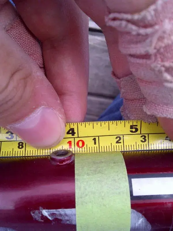

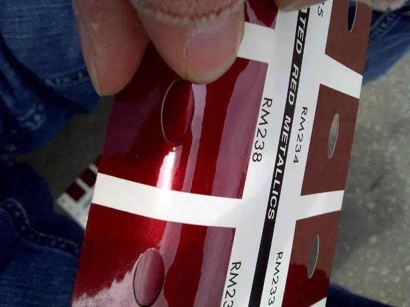

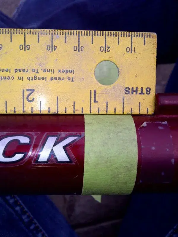

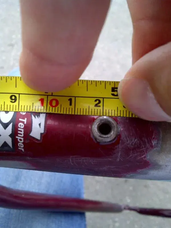

Anyway, I just went to the painter to carefully mark the position of the decals and match the colour...it should be dead on..I am sure I can get the decals on the frame +/- 0.5mm from where they are now... We are going to: media blast, etch, prime, fill, sand, prime, base, candy and clear the bike, let it harden, then install the decals, then reclear a few times..this way if we mess the decals up, we can pull them off without risking pulling the paint off!..

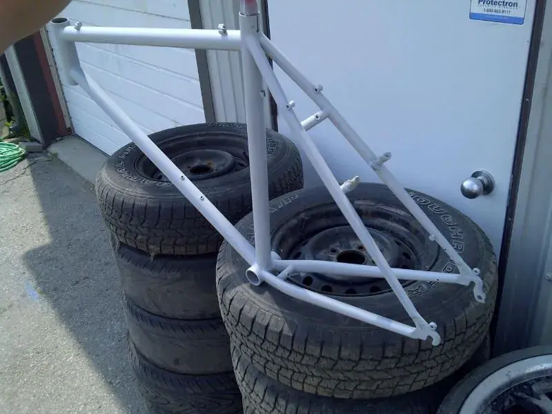

Frame was totally blasted, washed and primed..next up silver base and colour!

the decals were not to my satisfaction, and the more i looked at them the more little issues there were. It literally took months to get them right...but now they are finally done, and 100% perfect!!
We will paint this week..
