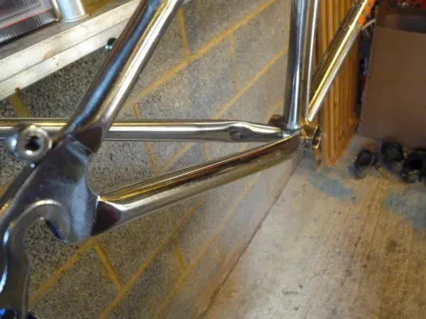

Sorry for the hijack but I've got a marin team issue with similar rust issues on the nickel plating, what's the best way to deal with it folks?
don't forget there is lacquer on top of the plating so you'll rub that off, when i did mine i spent ages cleaning and polishing it (with autosol etc) but it showed signs of surface rust quite quickly, especially if it was a wet ride so in the end i cleaned the hell out of it, polished it, then took it to Argos so they could re-lacquer it, now it looks spot on.
here's a couple of pics to show the finish :)

OK cool, I look forward to hearing how you get on.
I took a wire brush to mine about a year ago and tried to clearkote it but it just rubbed off and the rust has come back with a vengence....
My nexp plan of attack is to use Dinitrol rust treatment, I'll let you know how that goes.
Cheers!
The lacquer's quite snotty as it is jonny so I'd thought of doing as you have. Was going to have a go at re-lacquering myself though as I don't want to chuck too much money at it for now.
I was down at Triple S with beavis yesterday dropping off his frame and they told me they can't remove the chrome (although it can be done) so a re-paint would go over the top and lead to a slightly uneven finish. Not the best so if I like the ride I might swap it for a painted frame that's easier to work with. We'll see.
