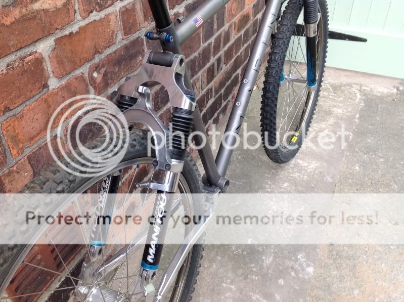

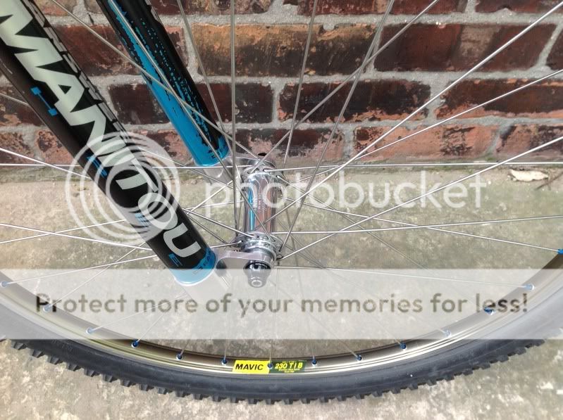

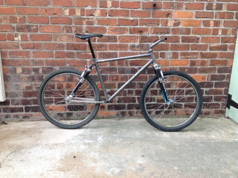

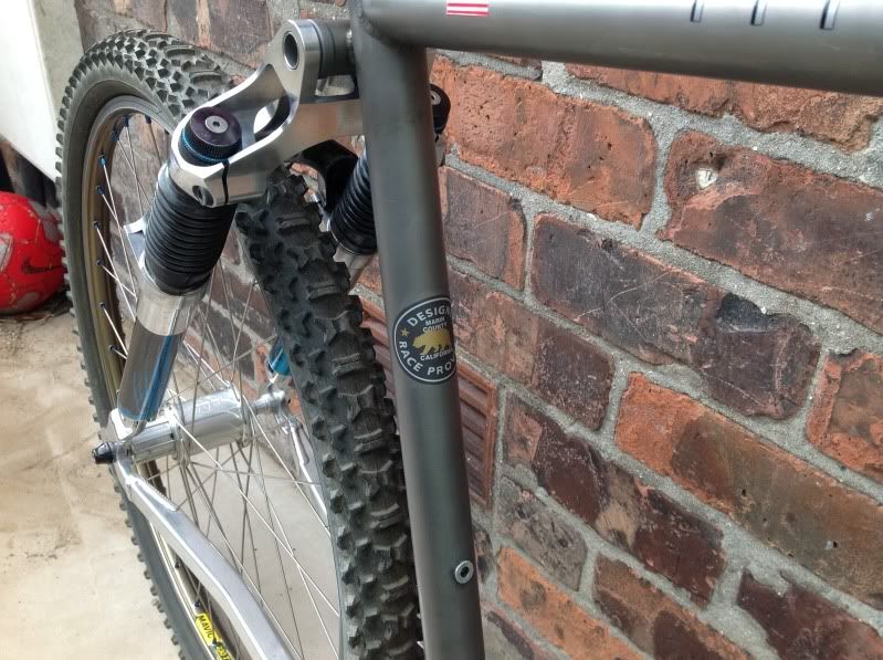

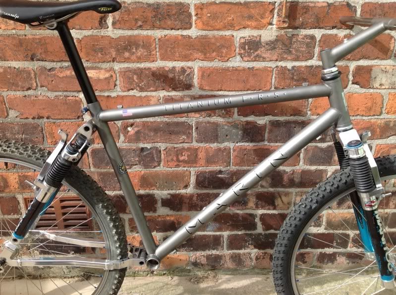

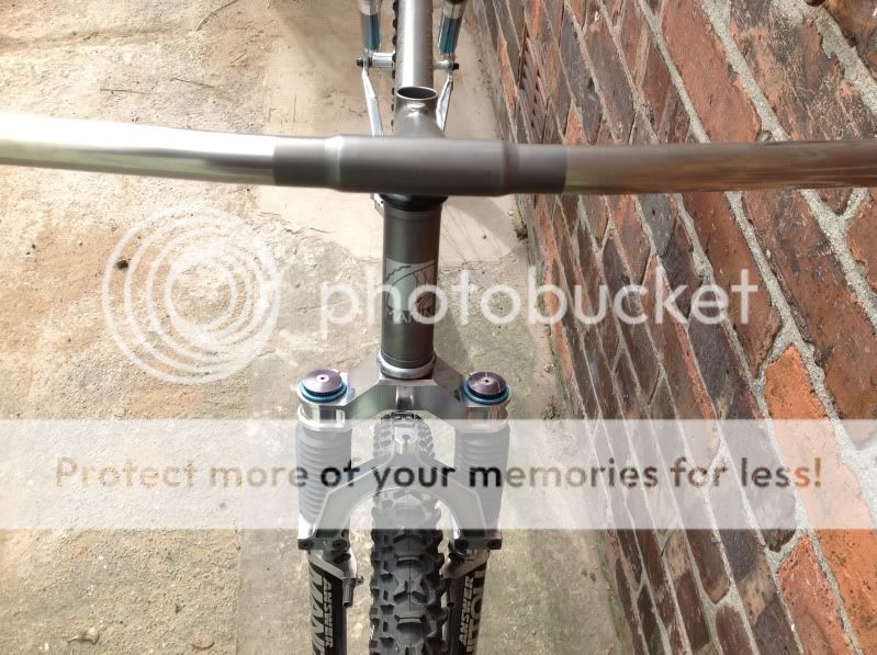

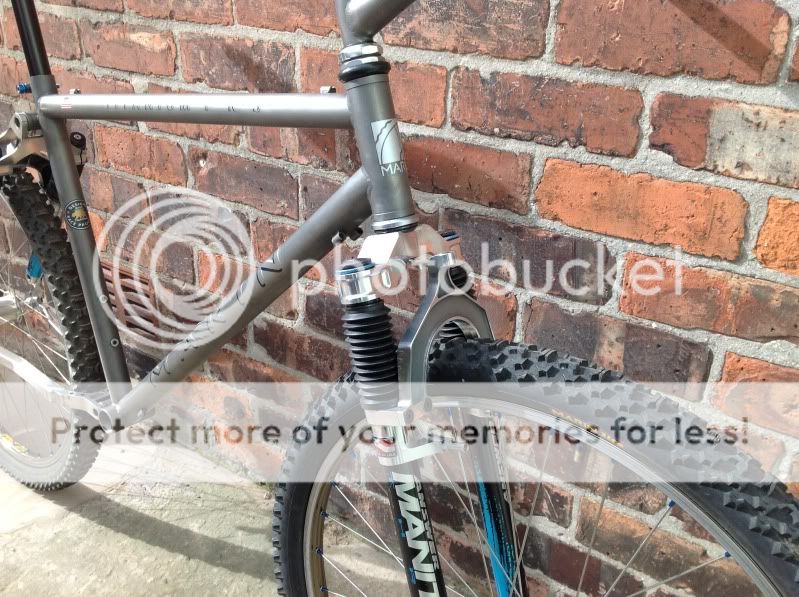

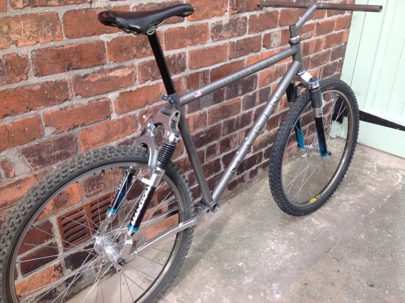

I spent last night polishing the rest of the alloy on the frame and forks. Took an age, but was well worth it though. I was going to go to bed, but couldn't resist trying the decals that I'd picked up earlier in the afternoon. I'm happy with the frame and forks, but the top tube decal needs more work as the'M' isn't right, and the letters in the word titanium are too close together too. The whole word needs to be another 35mm longer in total, so I'll have to get them modified next week. It's difficult with the top tube decal as there's nothing other than old brochures and a couple of photos on the net to work from as an accurate reference. I do have a few samples of other models from that year, which gives me exact font type and size. Also , the very left part of the 'A' in Marin is missing.
Hub bearings turned up in the post this morning, so that was quick job to put back together and buff up again.
Anyway, here are a few photos I've just taken to update the progress so far. They don't really pick up just how shiny the alloy is, but it looks really special now. Can't wait for the chainrings to turn up, and then I can get the cranks and bottom bracket on.
