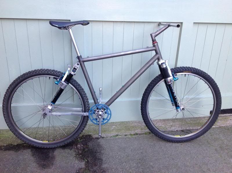

That Manitou has always had class, and rugged good looks. It's the kind of bike I imagined the Terminator would ride if he had a bike! In this version, it's every bit as attractive too, but it irons out the cracking Aluminium tube issue, and for what is in my mind, the ultimate incarnation of the Manitou FS. Funny that, as Marin actually referred to it in price lists as the Marin Ultimate FRS - a price list which has it at £3700 in 1994! The finished spec will be pretty close to what was specced at the time from Marin. The 1994 is far more appealing over the '93 because it used boutique parts and Manitou 3's rather than just XTR, and Manitou 2's.

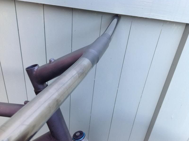

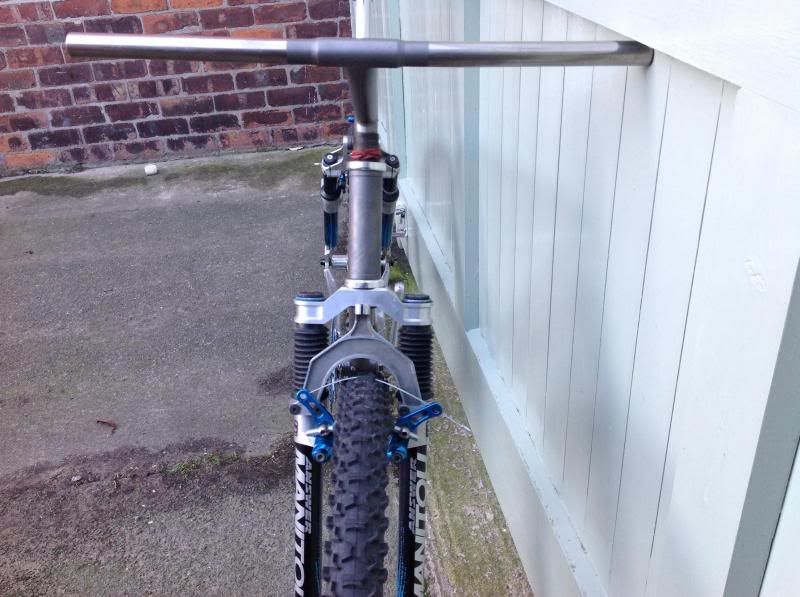

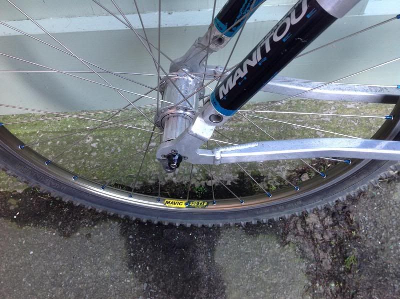

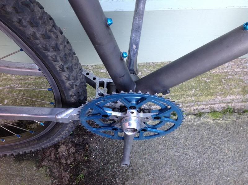

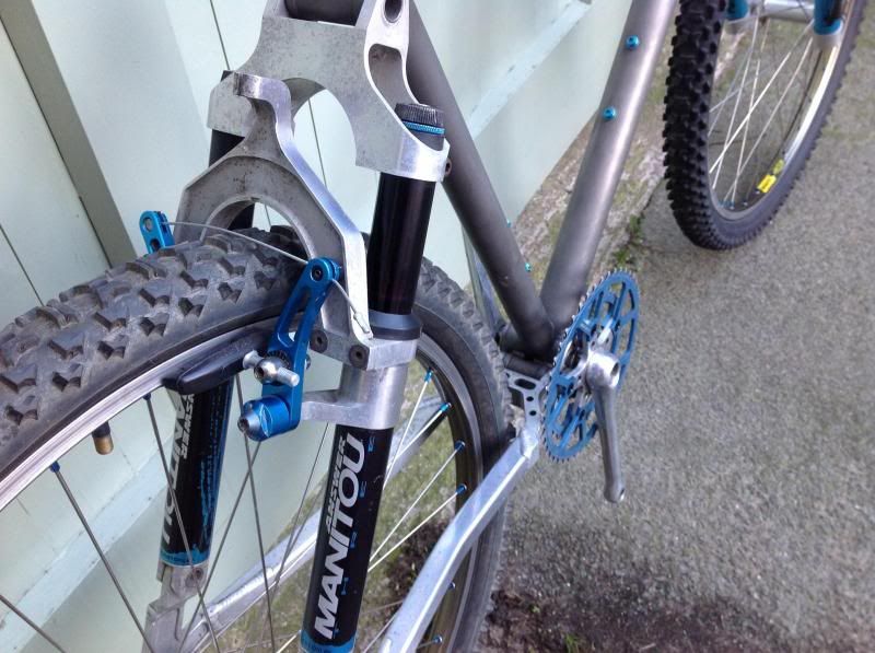

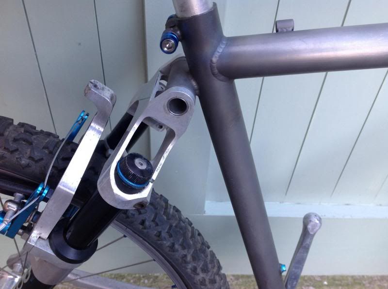

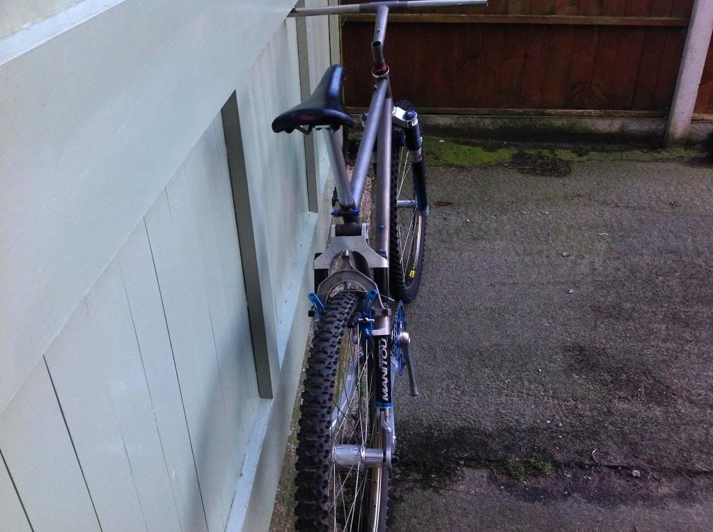

Anyway, enough background for now, I'll let the pictures do some talking. I've a lot to do with this project, but as I'm at the end of my parts gathering, I thought I'd share the fruits of my commitment.
Full strip down, alloy polishing, and new elastomer rebuild will be on the cards, but I'm leaving the main frame as it is because I like the story the metal tells; it has a lovely Titanium patina. This is the furthest I've built it up so far, as I want to be sure of all the details and component choices before I start the strip and restore process...
Very nice ! :D
Always better with a bit of history as well !
have a look at this, some amazing effects can be achieved with titanium!http://www.retrobike.co.uk/forum/viewtopic.php?t=43798
Yeah, I had a small hand in that process with Peter.
It's the next bike that receives polishing and blasting of Titanium...
At last!!! I've been waiting ages to see this :D and really looking forward to seeing this develop. Loving the blue accents and it has made my mind up to go that way with my Ti build.
