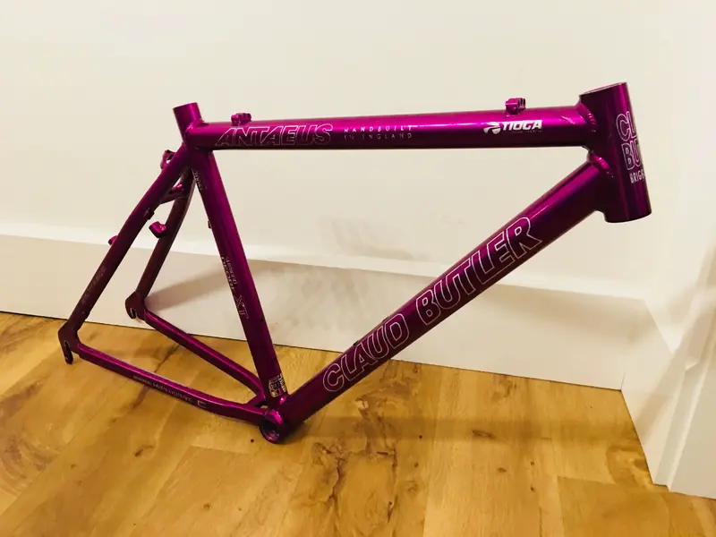

Ok, so now the last of the visiting family have left, I was allowed a little bike time. All the graphics have now been touched up and then covered with a super thin layer of polycarb protection film.
Next job is to tackle the scratches to the anodised aluminium, easier said than done.... obviously solid colour won’t work, nor a metallic/pearl. I’ve seen some frames touched in with nail varnish but this tends to be too shiny and too thick.
So I thought I’d try Lefranc & Bourgois “purple” Glass & Tile transparent paint.......
A little test on the offside chain stay proved reasonable. Not concourse perfect, but reasonably tidy and less distracting than the raw ally scratches.

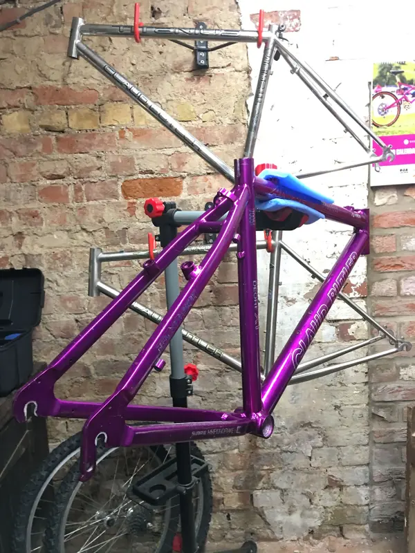

Cheers, ready now for the build....

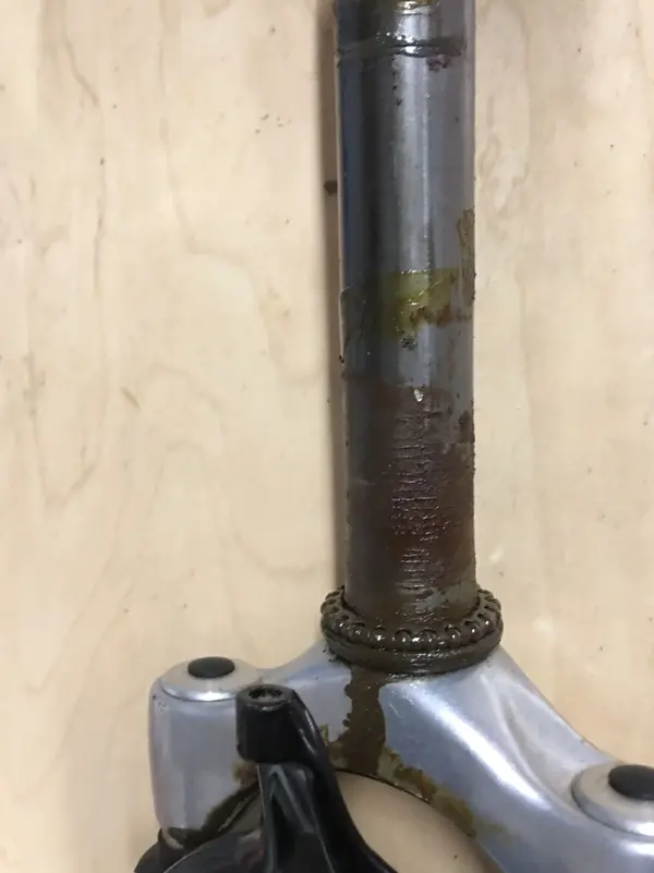

So I thought I’d start the build with the front end….. 8)
But stumbled at the first hurdle… :roll: as after a cursory wipe, the Quadra 10’s proved a lot rougher than I’d initially thought, although the elastomers look fine I couldn’t reach down to the bottom inside bolt for a full strip.. that will have to wait for a long series 4mm allen key. :|

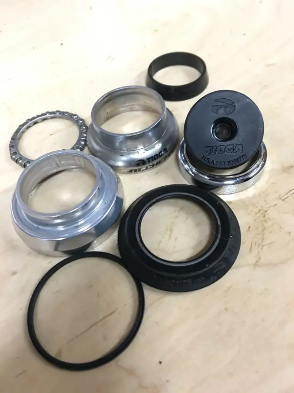

On to the headset, most of which cleaned up rather well for something that looked un-serviced for 26 years! Bottom ring of caged balls had gone west though..

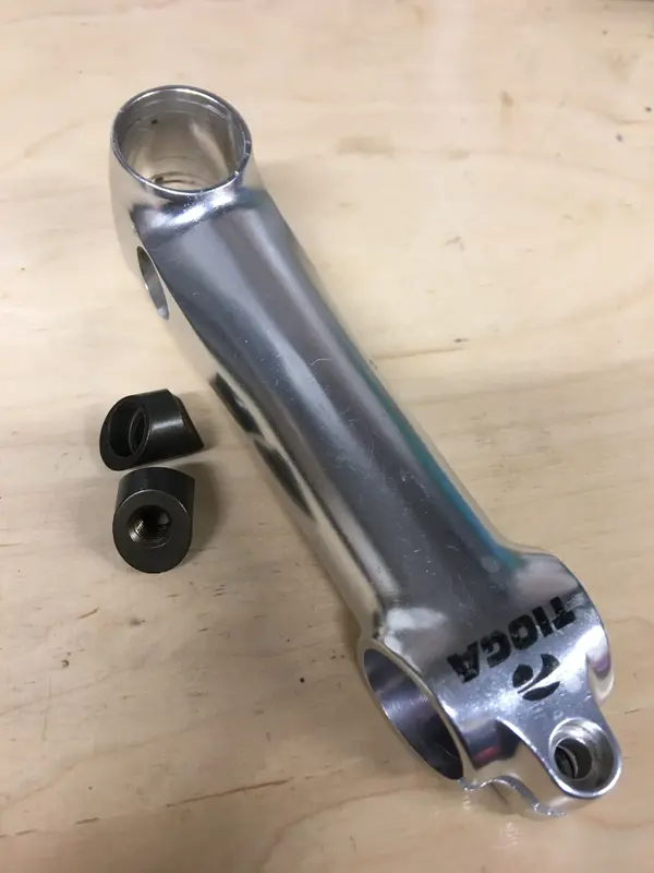

Stem just needed some nasty stickers removing and a proper clean…
All steel bolts and clips will spend the night in some rust converter. :D
