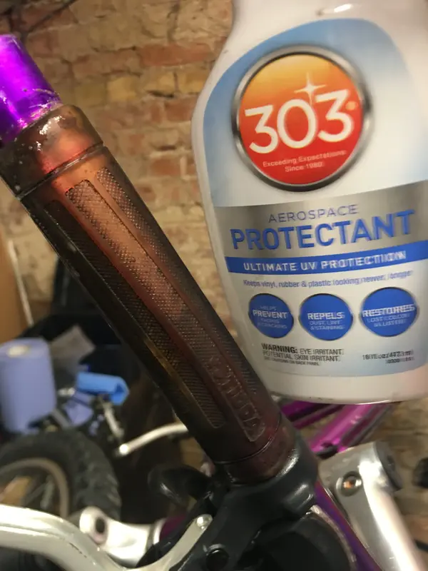

First thing I wanted to attempt was a safe removal of the once clear Tioga grips without damage, after years of making a mess or giving up and cutting old grips off, I tried squirting small amounts of 303 aerospace protectorant, this plastic/rubber preservative works its way around inside and the grips slip off super easy and in one piece! :xmas-big-grin:

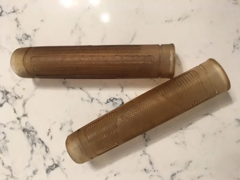

It really is great stuff, superb long-lasting dressing and protection for tyres, hoods, vinyl saddles, plastic toe clips etc etc.... and it’s great for prepping old rubber before removal (thumb hoods, brake lever hoods etc) which often requires stretching.
Anyway, back to the pair of clear Tioga PRO-X grips... why bother with some dirty old UV assaulted lumps of rubber?
Well because they are pretty rare, still in working condition and to replace them right now with NOS would cost £33 + £10 shipping from Germany :shock:
Anyway, after a scrub with a toothbrush and some fairy liquid, then a run through the dishwasher with Sunday lunch's pots and they are at least clean if still a bit un-sightly. And the NOS ones would show up the faded purple on the bars... :xmas-wink:
