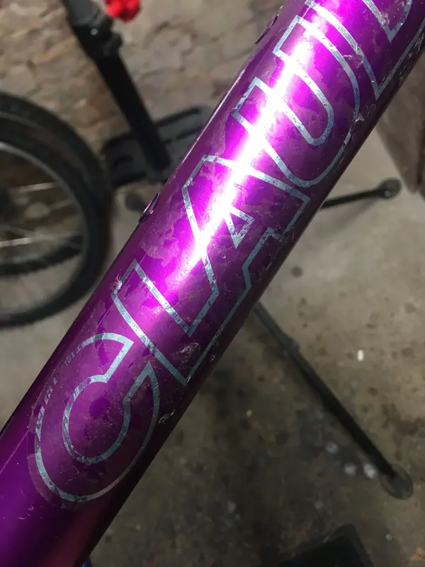

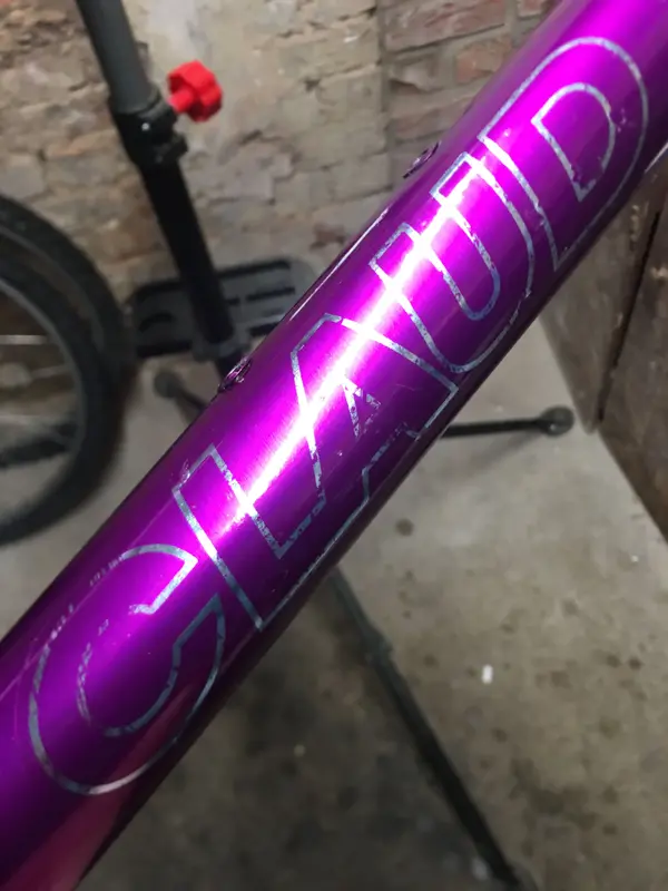

So, after the full strip I think my biggest job is going to be getting this frame in some respectable shape....The parts that have been removed will all benefit massively from a deep clean/service obviously, but I think the frame is by far the most tatty single item. :|
After a clean and a quick run through of the B.B. with my trusty Cyclo thread cutter to remove some corrosion, a close inspection revealed that the main issue is the protective layer of clear polycarb has in most places been removed leaving a now dirty residue. This was easily but carefully cleaned with white spirit to remove the adhesive and dirt but not the unprotected foil print.
A few quick measurements and an e-mail to Gil should get me some replacement clear panels in the post pretty soon…

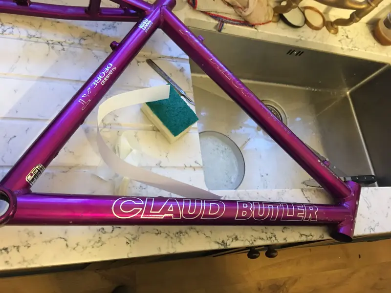

So I thought I’d continue the cheap project and crack on with my attempt at a low cost graphic save.
Just to re-cap, the Antaeus I picked up for about the price of a half decent round of drinks was in pretty good order accept for some very sorry looking graphics… pretty much everywhere the protective laminate over the printed foil base layer had either de-laminated or was damaged or had been picked off, leaving a dirty sticky mess….
The remains of the original protective layer were carefully removed and then remaining foil graphic was carefully cleaned with cotton buds and white spirit…
What remained was carefully re-painted with a suitably matching Humbrol silver (sorry I forgot to photograph this) Then I dispatched an e-mail to Gil, asking him to machine cut some new panels from his polycarb super thin top layer laminating material which he promptly did for the gentlemanly cost of a fiver! (I should point out I did supply him with the cut files)
This was easily applied with the help of warm water and a little fairy liquid so as to help push out any trapped air..
Although the hand painting isn’t 100% immaculate (I know I could have done better in my youth) I’m still pretty pleased with the result.
The only other option would be hours of artwork creation, then find a company to print the foil/silver, which I can’t imagine being cheap.
Right, best get on with the rest of the frame.... :xmas-wink:
