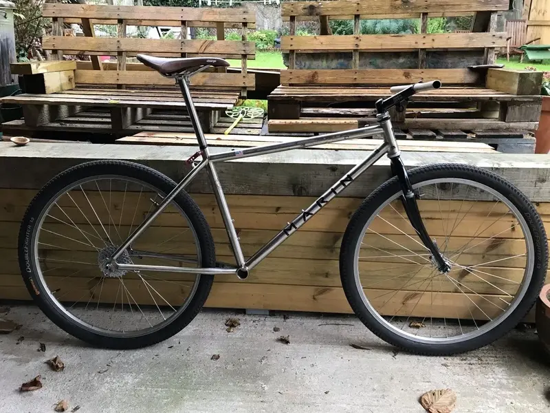

The shim arrived for USE ti post so it now looks more like a bike!
Picked up the GT85 yesterday so will have a go with the spontex at some point, although I think I’ll end up having a crack at the brushed finish, not sure how a mirror finish would look, any of you guys done mirror polish or attempted the brushed/satin finish??
Not sure I got the right shim, I thought this took a 26.4 seatpost, is that right?
I think it was a 26.6mm seatpost it took.
I read it was 26.4, just found another saying 27.0!
Just ordered some calipers!
Sad thing is I sold a 27.0 a few weeks ago :facepalm:
Haha so somewhere between 26.4 a 27.0! Verniers arrive tomorrow so hope to confirm for sure then.
I own a 1993 Marin Bear Valley SE and a Team Issue from the same year, so can confirm that both take a 26.4 setpost, but you might be able to fit a 26.6 to them.
