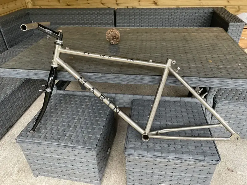

my 93 team doesn’t have rack mounts either.. 9FB79E1F-E755-4E12-92EA-A05E7E152B00.webp

All the other components on mine check out for the spec of a Team Marin, so no reason to doubt it’s provenance really. I’ll check the frame number, and seat tube size.

sorry, I was asking about seatpost diameter because I’ve struggled to pin point exactly what size seatpost is supposed to fit mine (bought as per photo, ie. minus seatpost!) - nothing to do with the original question 😁

I’ve started the above process, its very effective at removing the rust (thanks for the pointers guys!) I’ve also autosol polished a small area and it’s come up like a mirror! Not sure I like it though, has anyone had any success replicating the brushed satin type finish?
