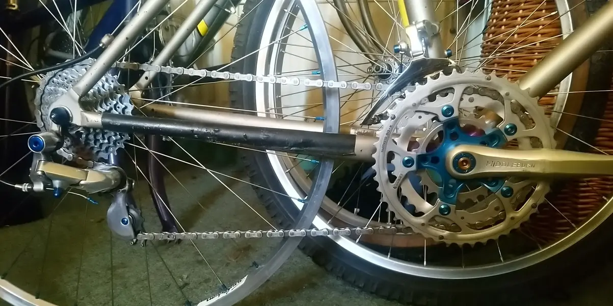

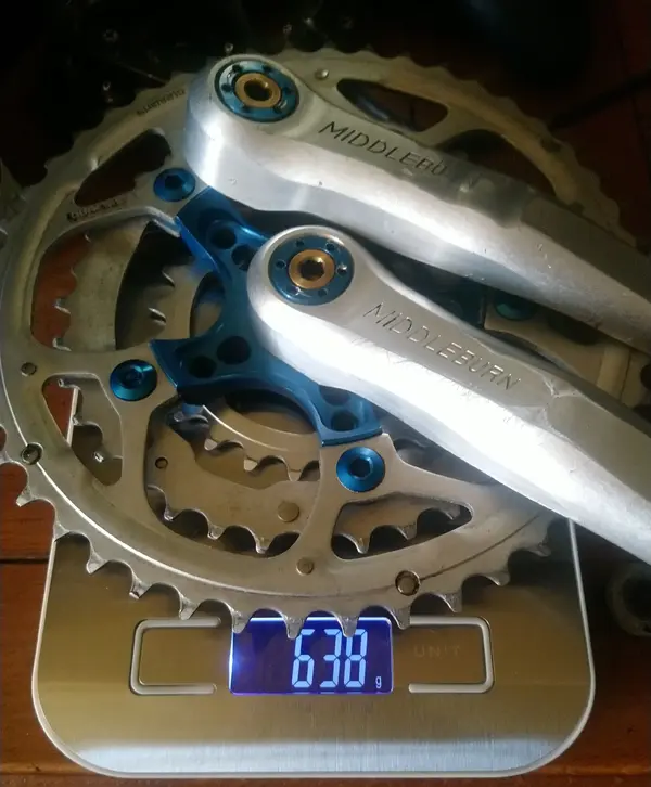

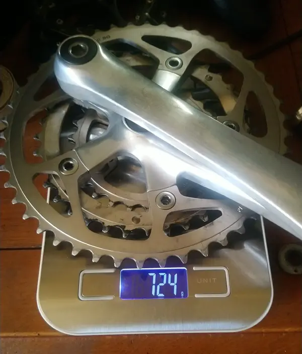

Crankset today
Was M900 XTR 46/36/26t 175mm with standard steel chainring/crankbolts 724g
Now Middleburn RS7, 46/36t M560 LX and 24t SR rings alloy chainring bolts and Ti self extracting crankbolts 638g saving 86g
Drivetrain all sorted :D
