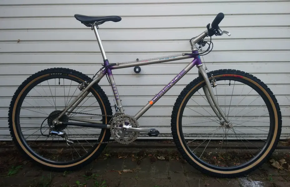

I have decided to give this another make over :oops: this time to see how much weight I can drop just because I've never done a retro weenie build! I'm starting from this, stupidly I didn't weigh it before I took it apart as I thought I had photos of it on the scale, I haven't :roll: but I think it was somewhere between 23 - 23.5lbs. Not heavy at all, but I'm wondering how light I can get it by shaving little bits off everything. DSC_0890_copy_4721x3055.webp

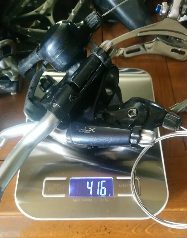

First thing I looked at was the controls, M900 Rapidfires aren't light, so decided on Gripshift X-rays and some X-lite Chicken stix in blue, saved 134g. Changed the bars from some no name polished alloy to Titec titanium saved 46g

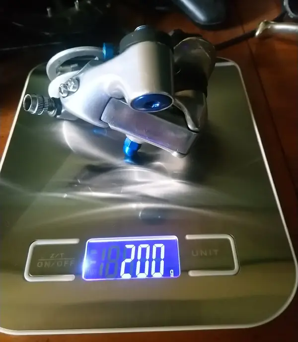

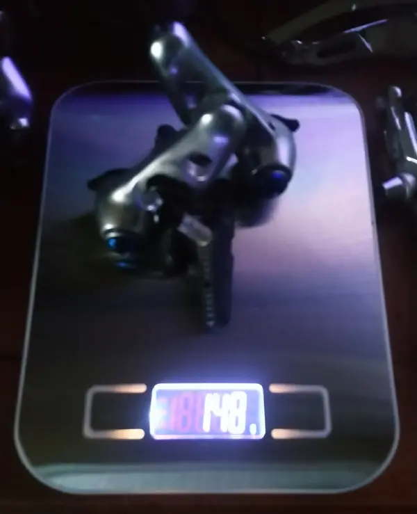

Next up were the mechs and cassette. XTR is pretty light already, but I wanted a short cage mech so I took the paint off an old Shimano 600 gave it a polish and added some blue bits.
27g saved.

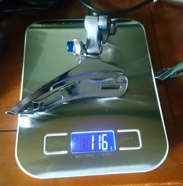

For the front I used an Exage ES, polished with blue bolts, swapping from bottom pull to top pull gets rid of the roller and another 11g.

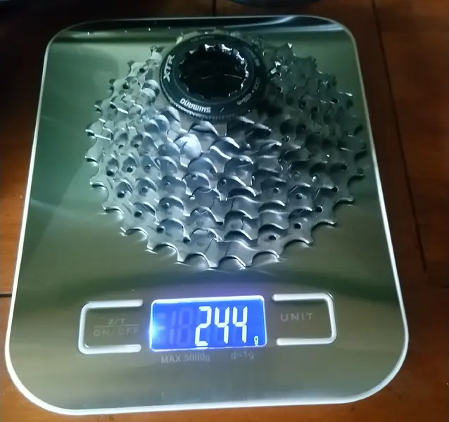

For the cassette, went from 12-32 m900 to 11-28 m737 with a later XTR alloy lock ring saving 77g.

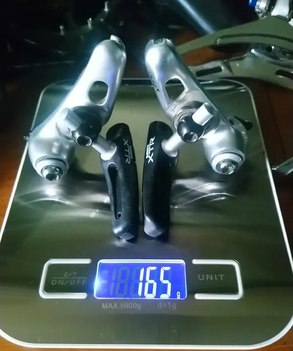

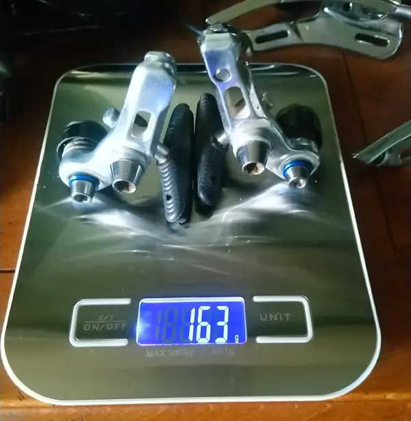

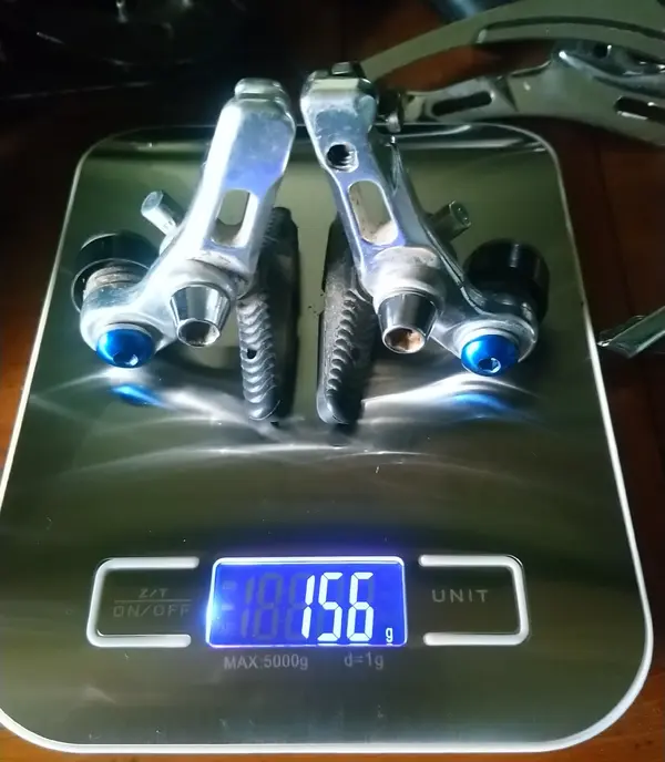

Next on the list were the brakes, I have a choice between XTR m900 or Dia-compe 987 at the moment, I may look for something posher eventually (always wanted some Avid Tri-align cantis/Ultimate levers, but money says no currently :().
Anyway m900 came out at 166g front 165g rear and the 987s with ti/alloy fixing bolts were 163g fr 156 r saving a whole 12g :D looking at them XTR pads are huge compared to the Aztecs, must be heavier! So have ended up with M900 with the ti/alloy bolts and Aztec pads come out at 150g fr 148g r saving another 33g

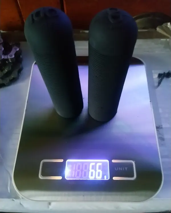

Grips, I could get some super light foam grips but I don't like them so have stuck with ODI Attack just trimmed for the gripshift, another 11g saved :D It all adds up!

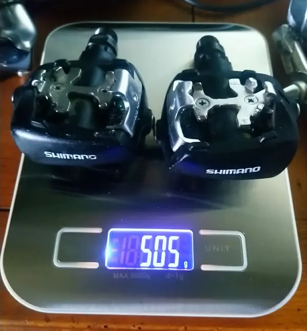

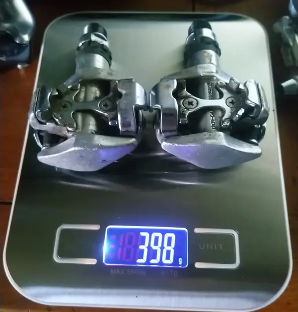

Pedals, just swapping from m525 to m747 spds saved a whopping 107g! I knew the 525s weren't light but wasn't expecting 505g for the pair :shock:
