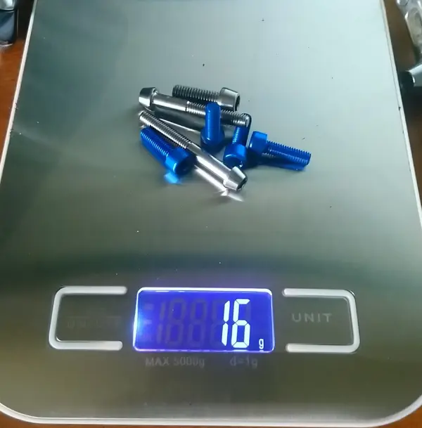

The last 8g to take it over a lb saved so far were bugging me :lol: thankfully there's a few bolts I can replace. Saddle clamp, handlebar clamp and bottle cage screws replaced with alloy/titanium. Another 17g off :D

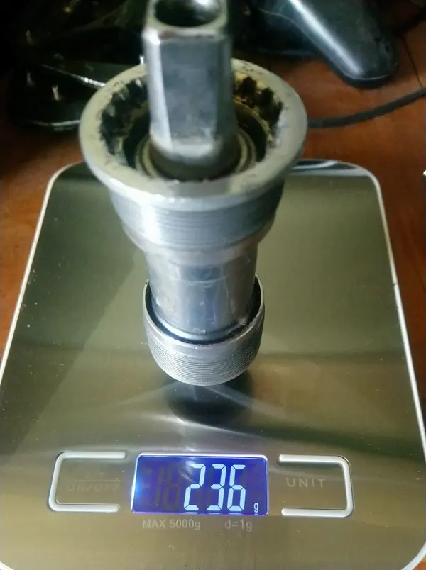

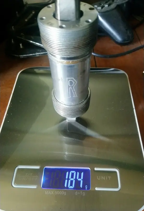

Today is the turn of the BB. Out with the UN-91 at 236g, in with a budget blowing Royce Ti at 184g, another 52g gone!

Very nice, i'm looking at maybe purchasing a Royce for my next build as they're just down the road from me.
Re: 1993 Orange Prestige - Weenie rebuild
It does seem like an extremely well made bit of kit. I didn't think it was cheap but has been refurbished by Royce and came with some lovely crank bolts in it's original box. Even had a sticker! Having looked at the new price since I think it was a bargain at £80.

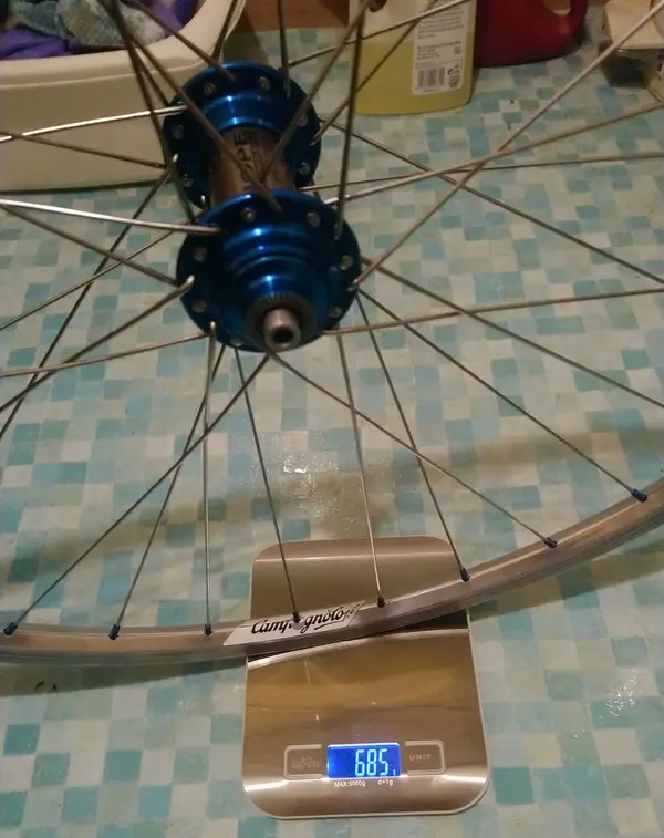

Front was a Mavic 217 ceramic on a Hope Fatso with 28 DT Comp spokes 2x and alu nipples coming in at 776g
Now a Hope suspension on a Campagnolo Atek with 32 DT Revolution spokes 2x and alu nipples coming in at 685g saving 91g

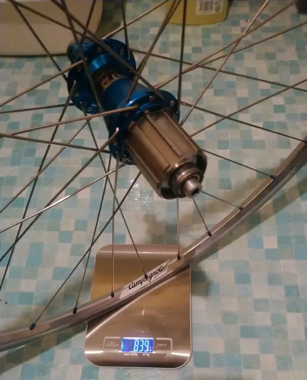

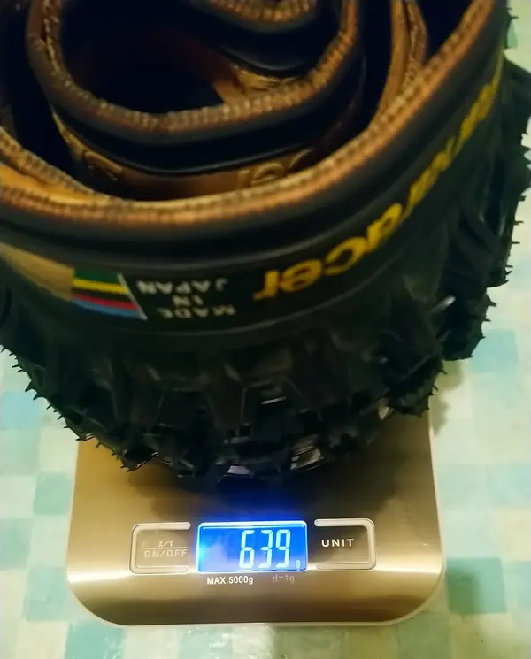

Rear was a Mavic 217 ceramic on a Hope Ti-glide with 32 DT Comp spokes 3x and alu nipples coming in at 955g
Now a Hope Ti-glide on a Campagnolo Atek with 32 DT Revolution spokes 3x and alu nipples coming in at 839g saving 116g
Front tyre was Panaracer Dart 2.1" @ 583g now Continental Cross Country 1.5" @ 408g saving 175g
Rear tyre was Panaracer Smoke 2.1" @ 639g now Continental Cross Country 1.5" @ 404g saving 235g
That's another 617g removed bringing the total to 1132g lost so far!
There's not much to go, just the crankset and tubes/rim tape, I'm hoping I can take another 230g to make it 3lb lost! I think it should be possible but I'll find out soon enough!
