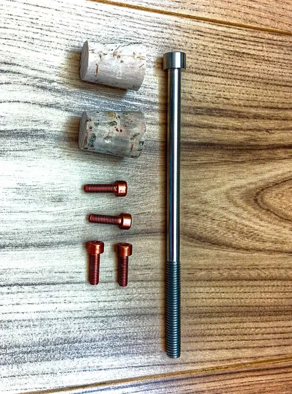

Few finishing bits arrived today. Ti expander bolt, cork plugs and copper plated stainless bottle cage bolts, should look close in colour to the Middleburn chainring bolts.

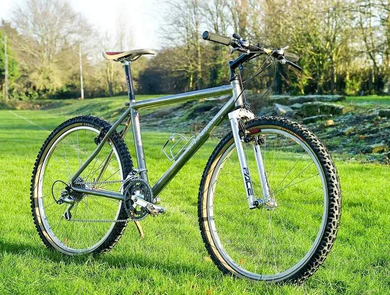

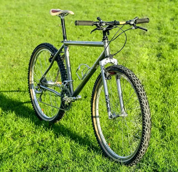

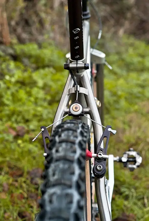

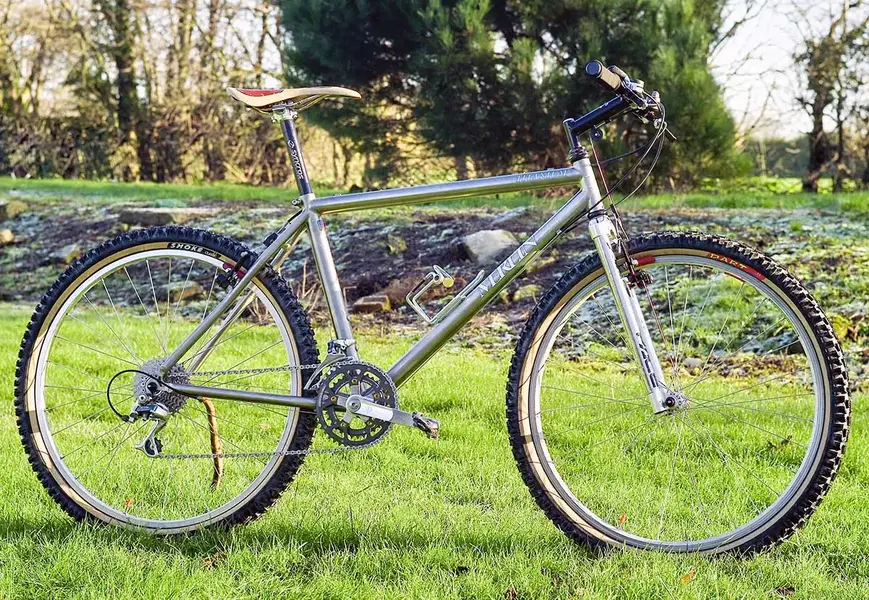

Here are the pics my brother took yesterday. I've also uploaded the full sized to Flickr.
https://www.flickr.com/photos/95826765@ ... 624256420/
Think the few bits of brown and gold works well.
Would have preferred an older Syncros post but at least it won't crack. Had hoped the graphics were painted but they're etched, so can't easily cheat and put older ones on. But it's fine.
It's not too obvious that it currently has mismatched wheels. Still not found a Team rim but will do eventually.
Once the very lardy bottom bracket and the fairly lardy bar go it will be just over 20lb, which isn't too bad, it's not exactly heavy as it is though.
