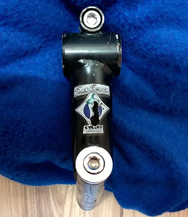

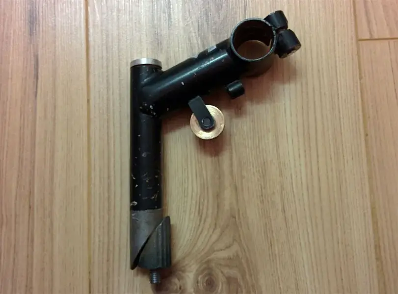

Oh and to wrap up a crapfest of a day, the rare short Salsa stem arrived today and it's not a Salsa just cost Salsa money. Not sure what it is but it's made in Taiwan and weighs as much as frame (slight exaggeration).

Agreed on a part refund on the stem, might be able to use it for something, like an anchor for a cruise liner :lol:. Not looked at the cassette yet but think we've probably one we can pinch the 12t from.
