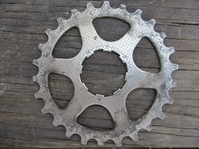

Don't worry it's certainly going to get ridden.( I have a cunning paint protection plan :D ). M900 doesn't have titanium sprockets and M950 has an alloy riveted spider that would be impossible to get apart and then back together. What I was meaning RE: Campagnolo was do you recognise the spacing on the titanium sprockets as Campag spacing as they sure don't seem to be fitting on my shimano freehub
Can you post a close up looking squarely down to illustrate the spacing more clearly?

Will do tomorrow :D
Just grabbed a pic from the original ebay listing
Don't know what you think
I think, what you have there is a sprocket that would fit the old Shimano Uniglide spline, before they introduced the skinny key/wide space on the Hyperglide system... Time to get your Dremmel out :wink:
Not sure what it is, bit early for me, rough night :(
I do know shimano hubs have 9 grooves though, and that only has 8 tabs!
Mark
After a quick search, Campag use 8 splined cassettes.
Mark
:oops: Doh! :facepalm: the importance of counting is soooo underestimated, of course its a Campy 8 spline, the old Shimano uniglide still had 9.......
