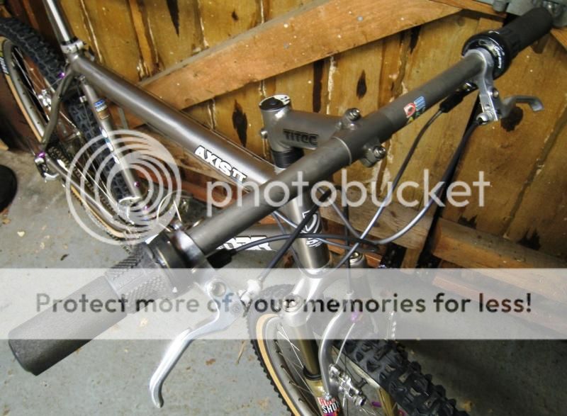

A few parts fitted....
Cheers

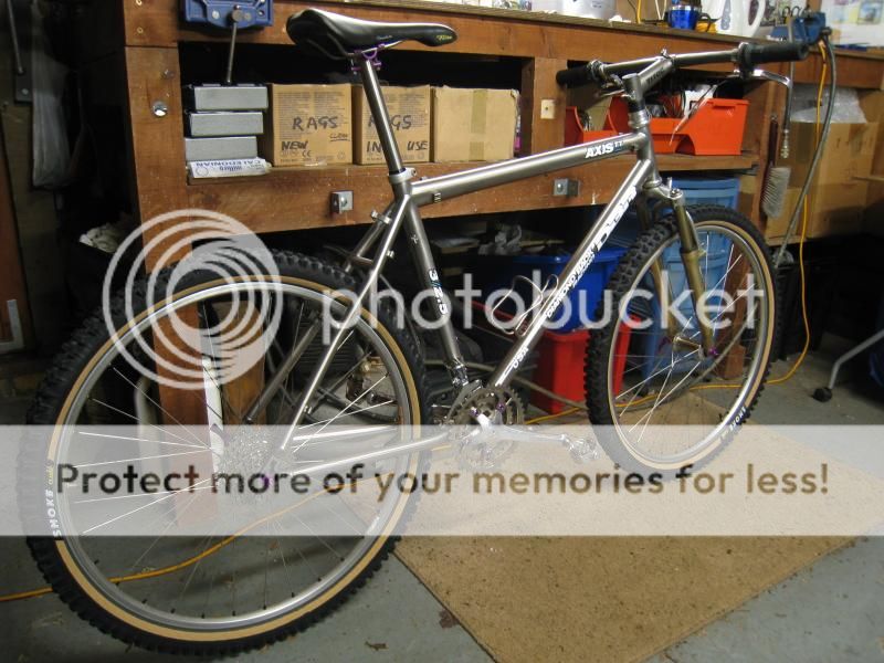

Re: BiTD Builds No.3 1993 DBR Axis Team Titanium - Update 4/

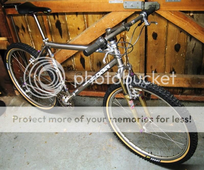

Bike completed!...
Spec:
Frame: 1993 Diamondback Axis Team Titanium - 1487g + brake studs (18g)
Fork: Rock Shox Mag 21 SL - 1262g
Headset: Chris King No-threadset - 84g + 14g (crown race)
Top-Cap: Mint Sauce + titanium bolt - 9g
Stem: Titec Titanium (inc ti bolts) - 146g
Handlebar: DEAN Titanium - 183g
Grips: Foam - 19g
Brakes: Pauls - 303g (inc. pads and straddle cables)
Cable hangers: Onza Chill Pills - 10g
Brake Pads:Kool Stop
Brake Cables: XTR outers - 47g + 23g (steel inners)
Brake Levers: Pauls (with alloy bolts) - 110g (pair)
Shifters: Gripshift SRT-800 (X-Ray) - 120g
Front Derailleur: XTR M900 - 121g
Rear Derailleur: XTR M900 - 225g (before tuning!) - 201g with alloy and ti bolts
Derailleur Cables: XTR outers - 35g + 21g (steel inners)
Cassette: XTR M950 - 234g
Chain: KMC 9SL - 245g
Crankset: Cook Bros - 617g (inc. rings and alloy bolts)
Crank Bolts:SRP alloy - 10g + 4g (dust caps)
Chainrings: Real (inc)
Chainring bolts:SRP alloy (inc)
Bottom Bracket: Action Tec Titanium - 136g
Pedals: Onza HO Titanium - 280g
Hub Skewers: Control tech titanium - 75g
Rims: Ritchey
Hubs: TNT Titanium
Nipples: Alloy
Spokes: Wheelsmith DB Stainless - 1642g (wheelset)
Tyres: Panaracer Smoke (re-issue) - 600g + 617g
Tubes: Bontrager - 248g
Saddle: Flite Titanium - 219g
Seatpost: USE titanium - 189g
Seatpost Binder: Clamp + ti bolt - 20g

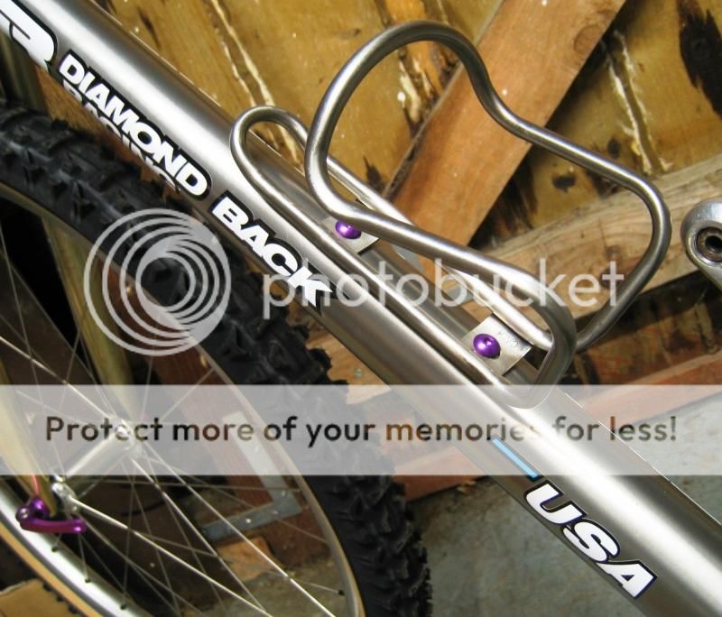

Bottle cage: Kind Titanium - 29g + 4g Alloy bolts (x4)
Weight: Approx 9366g / 20.65lb
Cheers :)

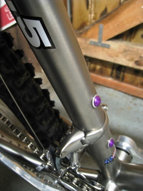

Re: BiTD Builds No.3 1993 DBR Axis Team Titanium - Update 5/
A few more photos....

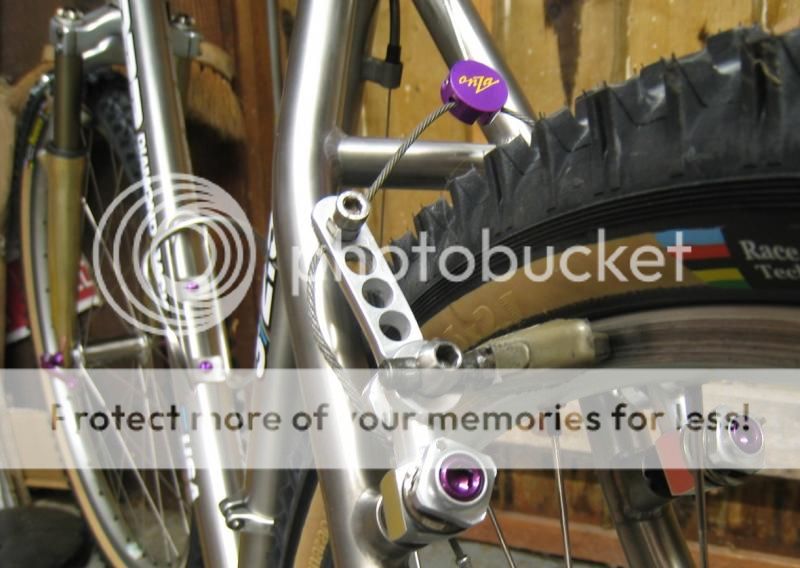

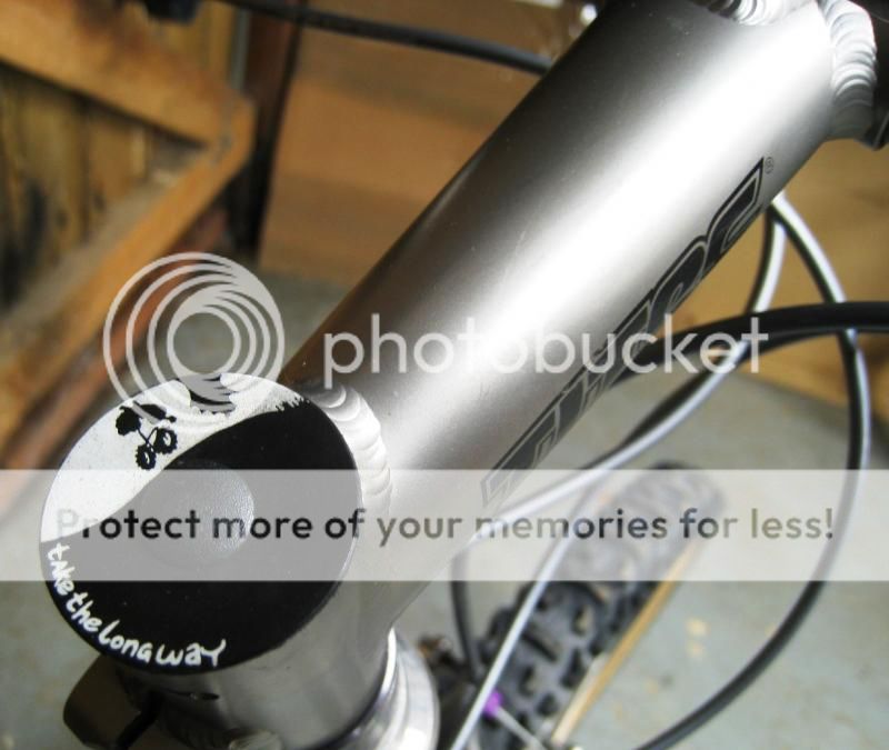

Mint Sauce top-cap 8)

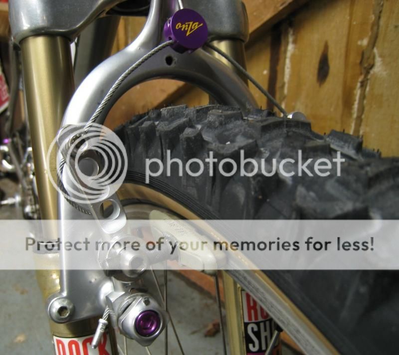

Pauls :D

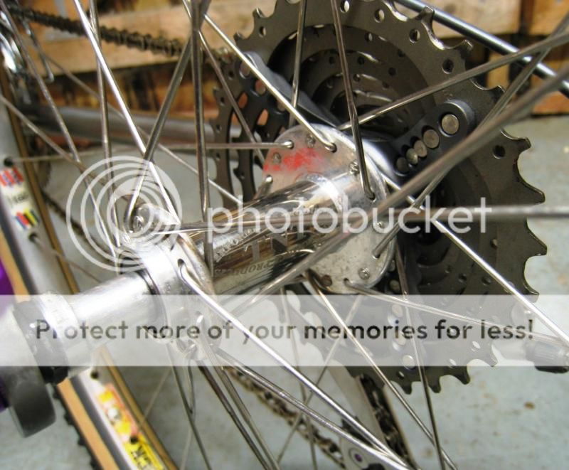

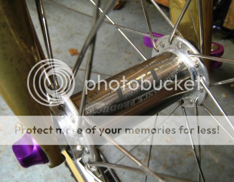

Wheelsmith built TNT titanium wheelset :mrgreen: ...been looking for ages for a wheelset with TNT ti hubs.....

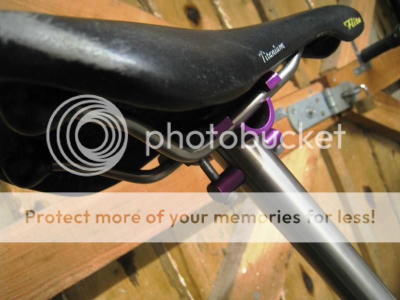

USE ti 'post ...it was this with the purple anno clamp that made me go for the purple highlights on the rest of the bike :) ....afterall, it was the colour (iirc) back in '93 :lol:

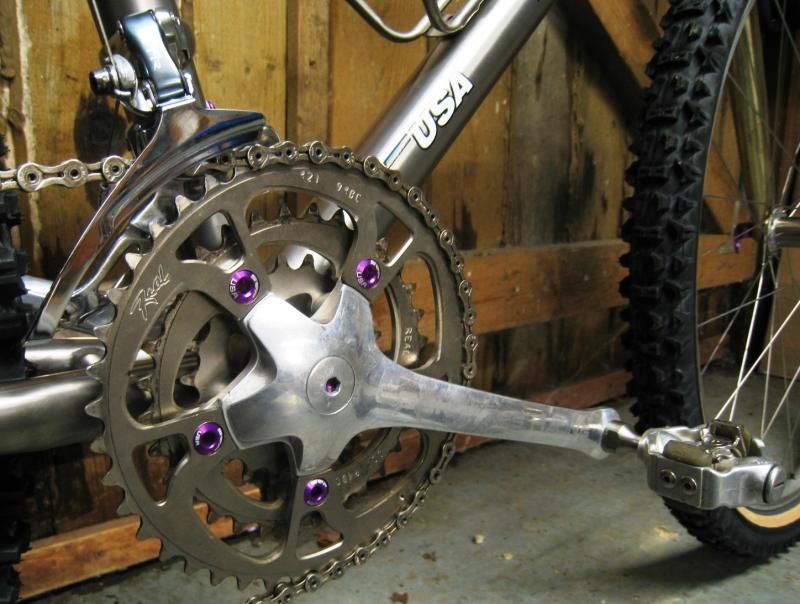

More purple.... :)
SRP alloy (purple) crank bolts hiding behind the dust-caps :) ....
Thanks for looking :)

Re: BiTD Builds No.3 1993 DBR Axis Team Titanium - DONE!
Very Very Sweet! I'm loving the purple!
Just out of interest are those Alu or Ti bolts holding the canti's on?
That's really cool and I love that top cap, somewhere in my parents loft there is a box with one of those in, I must have a good look up there again.
That's a great finish you got on the frame.
A very nice built and I love the purple parts. But I think this is not a 1993 frame. Because 1993 the cable Routing was complete on the right site an the bikes don´t have S-Bend chainstays.
Regards
Mathias
Regards
Mathias
Thanks :)
You're right...I believe it's 1994; it still has a couple of the original stickers on the frame: the gold one at the top of the seat-tube and the one at the bottom as well.
I wanted to use 1993 decals as that's the one I had originally back in 1993, and I prefer them to the later ones ;) ...also done a 94 and 95 build previously (see links in sig).
Cheers :)

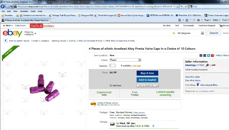

Love the 3dv.... What about adding some of these ?
