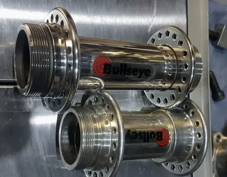

Apologies in advance if I’m not keeping up - That hub is bizarre
I’ve never seen a reversible rear - it looks like you could mount TWO freewheels- bit like an old single speed rear with a gear either side
Is that an old but funky mount for rear disc ? The other one looks like a standard rear to me .... or is that the front with the same fitting for a disc ?
Yep it's a Flip-flop hub beloved of fixies and track bikes ( also BMX's also sometimes use them) , as you can flip them around to change gearing when using single speed. Very very early San An's used Bullseye hubs before Pulstar made them custom hubs. I have managed to source a first Generation Rear Prostop kit ( The only other bikes I have seen them on are Fisher RS1's) but it's stuck in States with my cousin who was supposed to be coming over in June but obviously not now. They used Campag or Phil Wood hubs. Flip flop Bullseye's rearly are as rare as rocking horse poo ( search on Retro BMX sites to see it what regatd they are held). I was very lucky to get this one, hence pooing my pants when I was stripping it.
