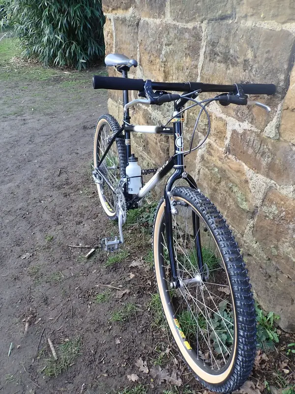

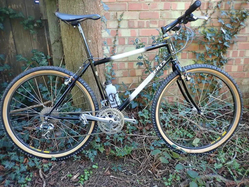

It's done.
It's 90% original, the only changes are the Headset, left the Mavic fitted as it's great and matches the rims, plus the saddle, tyres, stem, inner cables, brake blocks and grips.
Took it for its first ride this morning, amazing ride, it reminds me a lot of the white spider, but that was just a bit small for me, this is a much better fit, and of course the XTR is a lot nicer than the DX/XT I had on that.
Went with the grey flite in the end, I like the fact that it's date stamped 92 like the bike and it matches the grey of the XTR outer cables. Eventually this will be set up for touring and will be my steed for a few planned treks later this year.
Frame: Roberts Black Leopard
Fork: Roberts
Headset: Mavic 315 1''
Stem: Cinelli Heavy Duty touring
Handlebar: ITM Super alloy ultra light
Grips: Grab on Mtn 1
Brakes: XTR M900
Brake Pads: Swissstop 4 season Rats
Brake Cables: XTR M900
Cantilever cable hangers: XTR M900
Brake Levers: XTR M900
Shifters: XTR M900
Front Derailleur: XTR M900
Rear Derailleur: XTR M900
Derailleur Cables: XTR M900
Cassette: XTR M900
Chain: Rohloff S-L-T 99
Cranks: XTR M900
Chainrings: XTR M900
Bottom Bracket: XTR M900
Pedals: M747 XT/XTR
Hub Skewers: XTR M900
Rims: Mavic M231 CD
Hubs: XTR M900
Tyres: Specialized ground Control Extreme
Saddle: 92 Flite Ti
Seatpost: XTR M900
Weight: 10.5 kg
